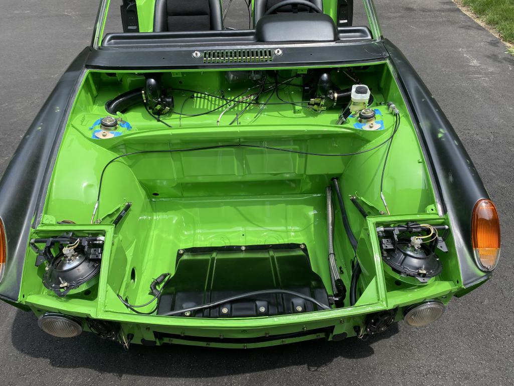

I am building my second 914 and putting a 2.4 six in and building it with hopes of building it out to a hotter 2.5 long stroke next winter... So I am putting in a external cooler up front. I am looking for the best ways to run the lines.. I dont want to run GT hardlines. What did you do?? Pictures welcome!!! (IMG:style_emoticons/default/biggrin.gif)

Robarabian   Im gonna run hard lines.... but am interested in t...   Dec 16 2025, 09:56 PM
targa72e   I was just going to post the same question. I want...   Dec 16 2025, 10:56 PM
Steve   To each his own, but I installed AN12 steel braide...   Dec 17 2025, 12:20 AM
SirAndy   I am building my second 914 and putting a 2.4 si...   Dec 17 2025, 12:36 AM
Cairo94507   On my 2nd Six, 3.0, we ran braided SS lines up the...   Dec 17 2025, 07:27 AM
mb911   I ran solid lines under the chassis on one of my c...   Dec 17 2025, 11:13 AM
burton73   OK, my 6 number 41, when I got it, had this type...   Dec 17 2025, 03:04 PM
pete-stevers   Perhaps I should be more specific I am running a P...   Dec 17 2025, 03:11 PM
burton73   @pete-stevers pete-stevers The braded lines run ...   Dec 17 2025, 03:38 PM
burton73   I found some 2007 pictures Best Bob B   Dec 17 2025, 03:57 PM
pete-stevers   I found some 2007 pictures Best Bob B B...   Dec 19 2025, 01:47 PM
mepstein   On my 3.2 car, I ran a stainless line up the passe...   Dec 17 2025, 08:22 PM

mepstein   I went up, over the wheel well and directly into t...   Dec 18 2025, 06:19 AM
pete-stevers   Thanks for the tip Andy!! In that caseI w...   Dec 19 2025, 01:43 PM

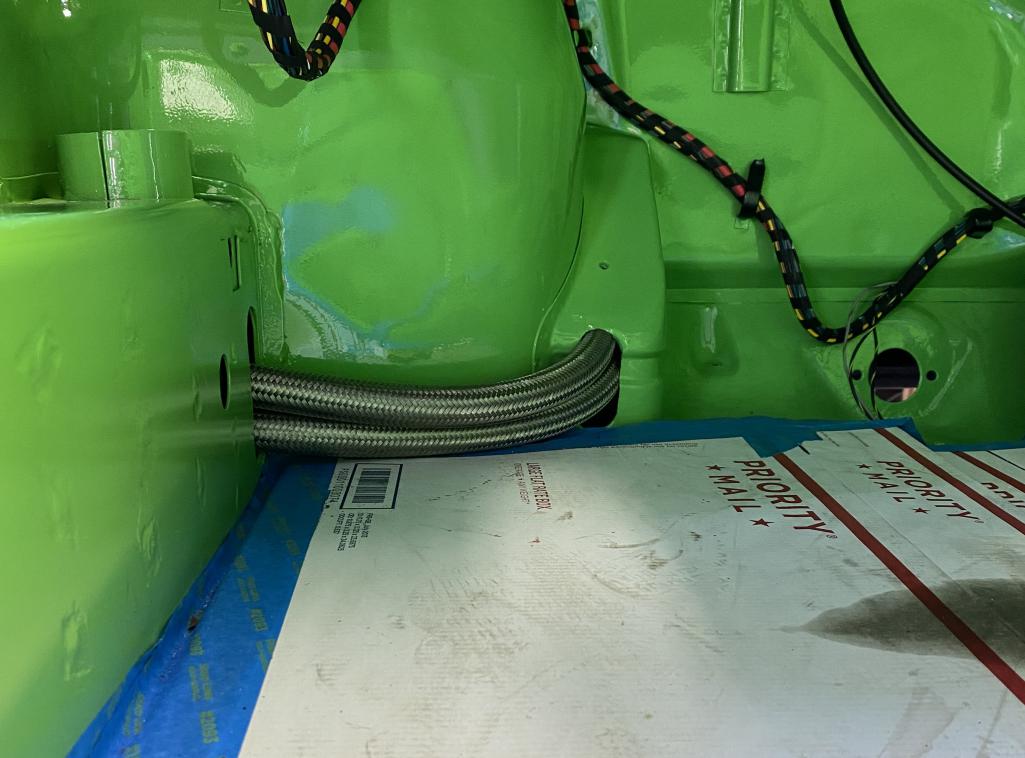

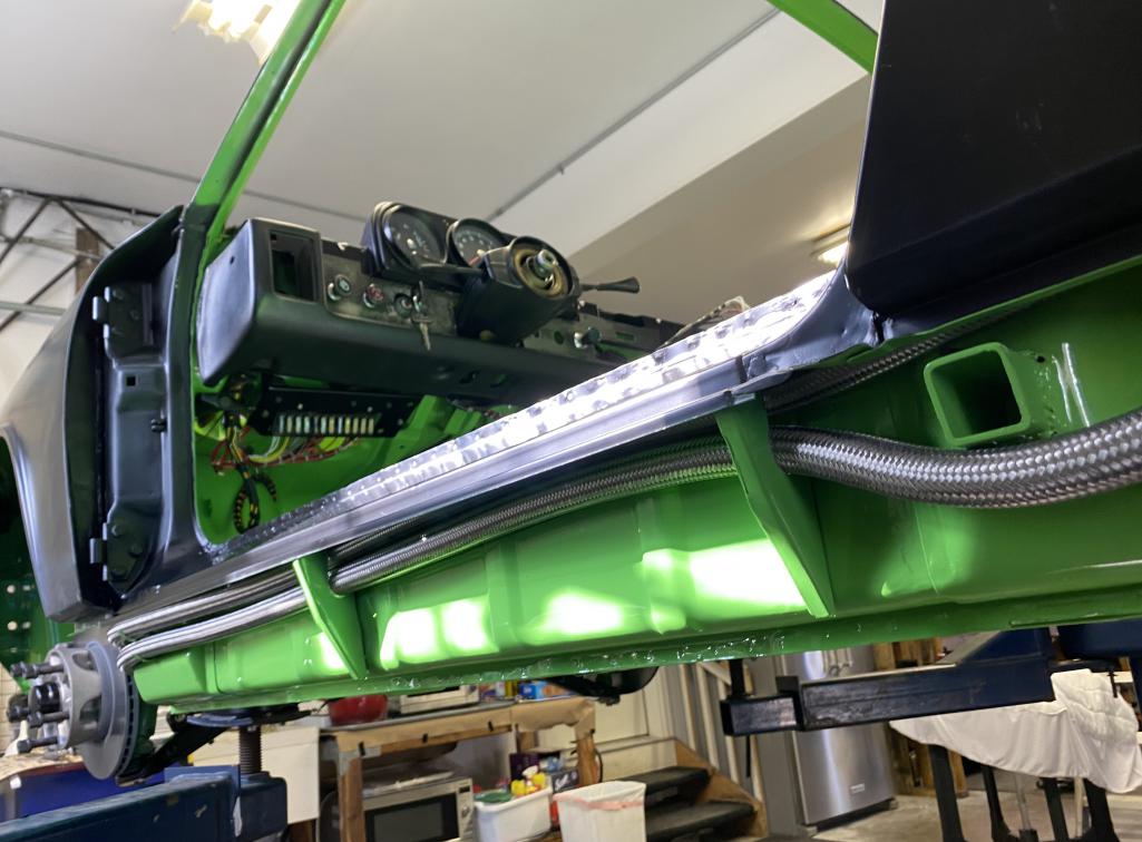

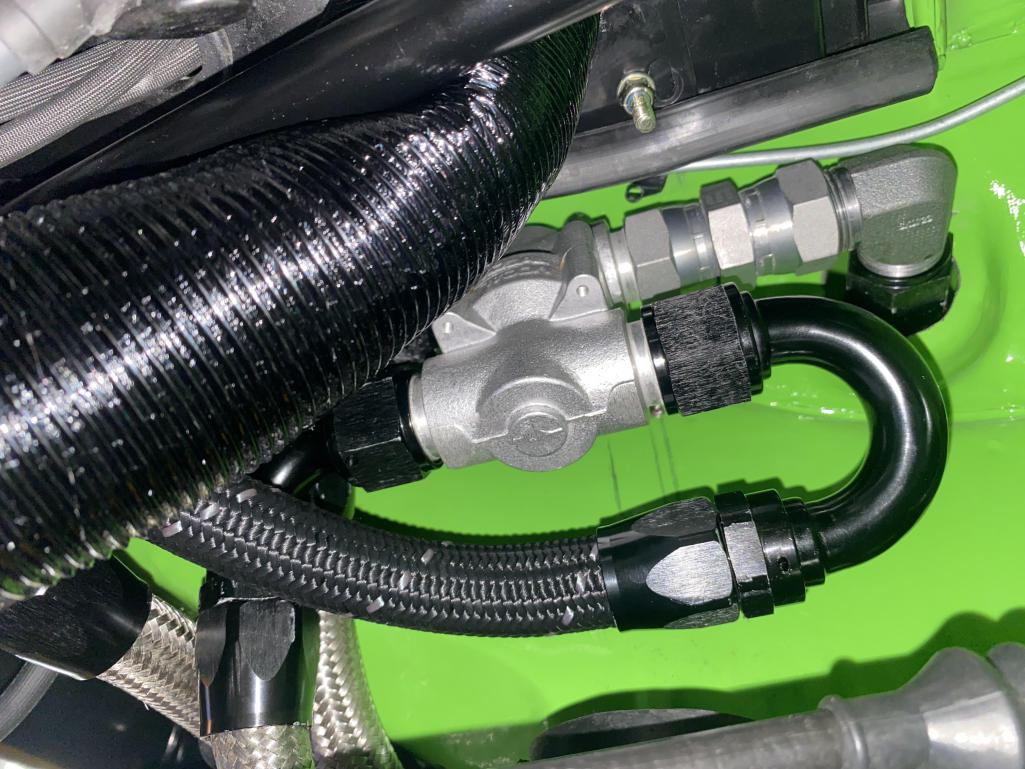

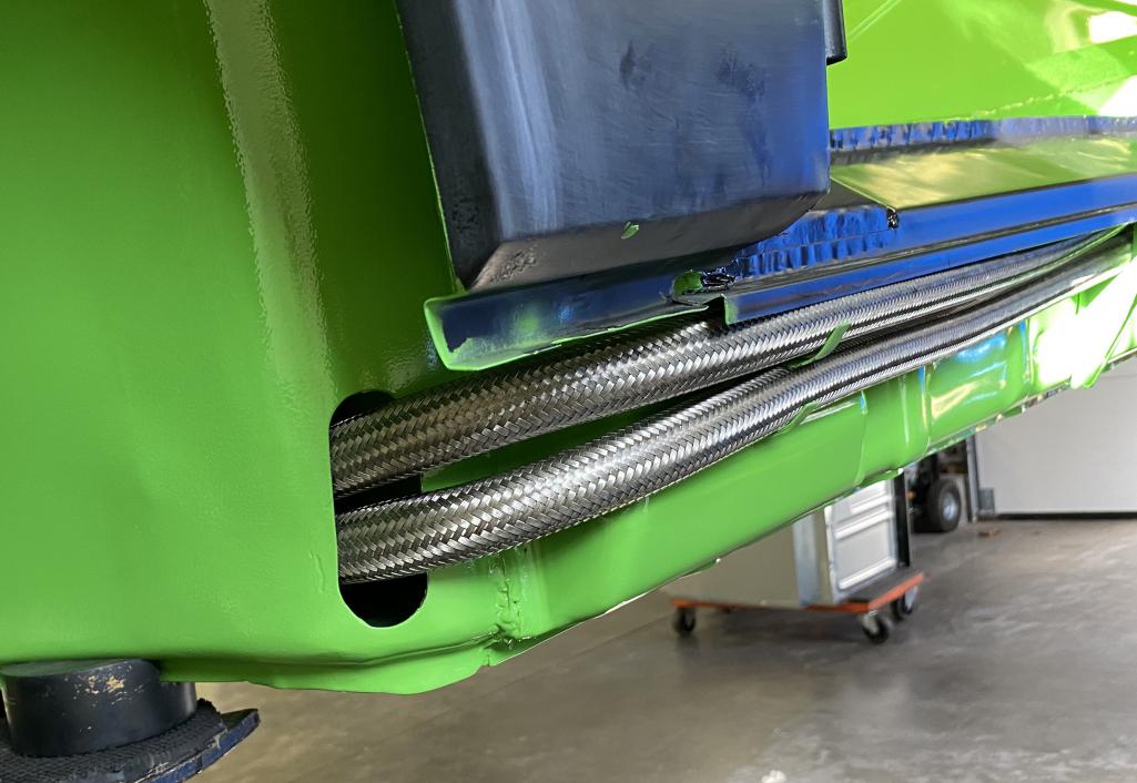

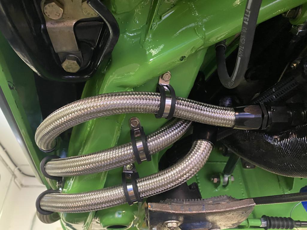

Tom1394racing   Hi Pete Here is what I did on my 914-6 GT project...   Dec 19 2025, 07:13 PM
Tom1394racing   I ran the stainless AN lines continuously along th...   Dec 19 2025, 07:22 PM
Tom1394racing   I used braided AN lines for the engine scavenge li...   Dec 19 2025, 07:27 PM
Tom1394racing   I brought the cooler lines and the oil tank feed l...   Dec 19 2025, 07:52 PM
pete-stevers   I brought the cooler lines and the oil tank feed ...   Dec 23 2025, 03:19 PM
Steve   I ran my AN12 steel braided lines the same as Tom....   Dec 23 2025, 03:42 PM

brant   You want a minimum of -12 for a six Many people w...   Jan 8 2026, 09:12 AM
Steve   I’m running -12 for my cooler lines. Otto’s a...   Jan 8 2026, 10:44 AM
windforfun   So which steel surface is going to wear out first?...   Jan 8 2026, 10:45 AM
Steve   So which steel surface is going to wear out first...   Jan 9 2026, 11:41 AM
campbellcj   Mine are also AN-12 or maybe -16 run thru the rock...   Jan 9 2026, 12:14 PM
scrz914   I’m wondering if anyone has designed a grommet o...   Jan 9 2026, 12:45 PM
930cabman   I’m wondering if anyone has designed a grommet ...   Jan 9 2026, 01:11 PM
campbellcj   pretty sure mine has some rubber edge molding arou...   Jan 9 2026, 01:45 PM
