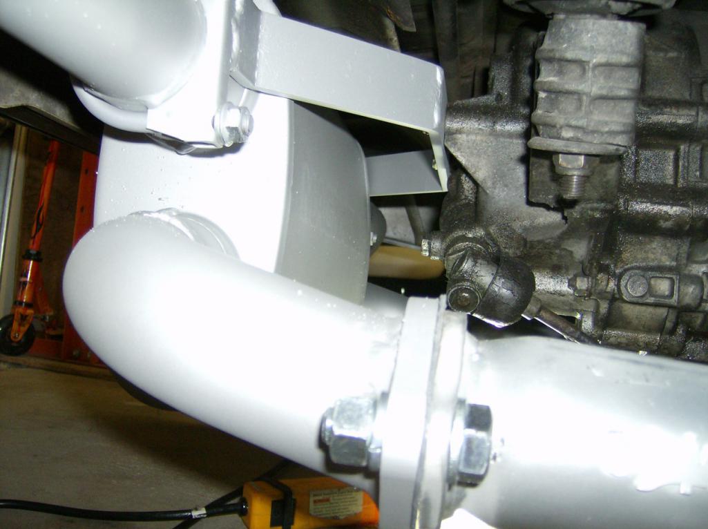

QUOTE(VaccaRabite @ Dec 23 2025, 12:03 PM) *
QUOTE(barefoot @ Dec 20 2025, 05:55 PM) *
Can't see a support bracket, hope you have one installed or the whole works hangs off the 4 exhaust port studs, a sure fatigue failure. (IMG:style_emoticons/default/blink.gif)
Otherwise looks like a good solution.
Barefoot
(IMG:style_emoticons/default/agree.gif) (IMG:style_emoticons/default/agree.gif) (IMG:style_emoticons/default/agree.gif)
Especially with a late exhaust, the muffler bracket is absolutely critical. Without it you WILL break exhaust studs, and that is a huge problem.
The muffler and piping is a good 35-40lbs. Here's what I did on mine if the OP needs ideas...
