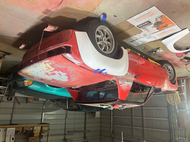

Hello to 914 world-
I am starting a build on a 75 1.8. It is a fairly solid car and I am starting with paint and bodywork. I love the look of the 916 (don't have the $$ to do an authentic clone) so have purchased the flares and bumpers from AIR.
I have duct taped the flares on to the car and have broken out the sawzall to start cutting the body but wanted to check to see if anyone on the site had done an install on these AIR parts before irreversible damage is done ;-}. I looked to see if there were any threads for these parts but don't see any, but I am sure that some people have gone before me...am I missing a thread somewhere?
My initial assessment is that there will need to be some tweaking needed to get things to look and fit right.
Many thanks,
Paul

The parts from AIR are fiberglass. They say that they use Bondo Resin Je
lly to bond the flares to the car. I have the front and rear bumpers/valances on the way. Will see how they will integrate in before I do any permanent mods.
Will start a build thread if no one has already documented this install.

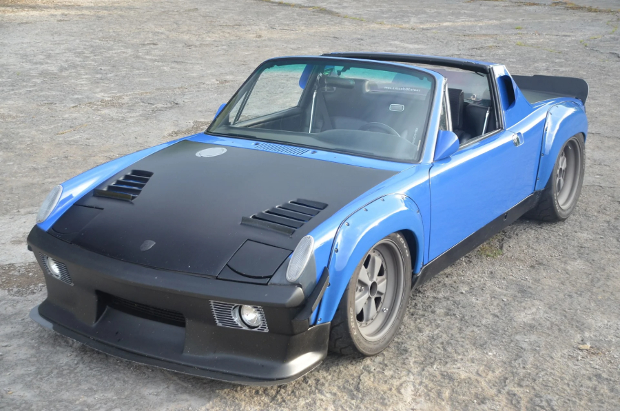

Good luck creating your vision! I have a well made set of glass flares that, from what I gather, was made by a company that is no longer in business. I planned to put them on my '72 as one of the factory fenders wasn't in good shape. Long story short I got a '75 with fenders in good shape and didn't think it appropriate to cut them to put glass flares on it.
