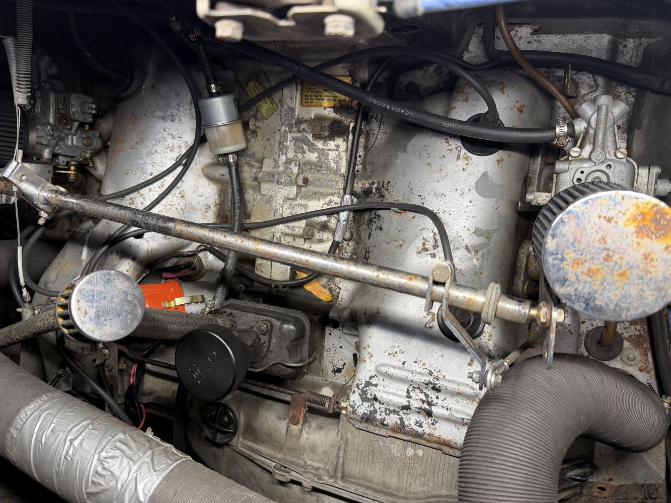

Hi all! first time post and I am a novice on 914s. Is this the right tube for the 1.7?Dip stick tube
I cant seem to find on that definitively says its for a 1.7.
Thank you for any thoughts!

From this angle it does not look like 914 case. Look at the location in picture. Could be any size bore.

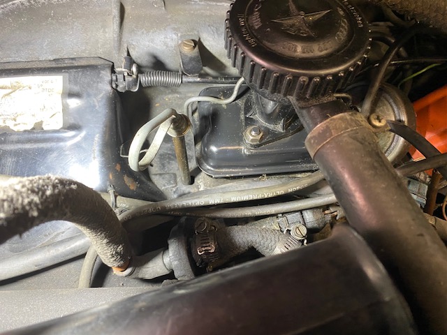

This is the only bore I can find.

Looks like a VW bus case from a 1.7. Carbs are typical bus ones. No dipstick or provision for one in the tin. See if there's a dipstick next to the driver's side of the fan.
The dipstick in your link is not form a 914.
Best wishes for your project!

Sorry, yes that's where a 914 dipstick should be. Maybe someone pulled it out or broke it during ma rebuild?
Could be a 914 motor, check the fan area for a dipstick. What's the case number?
If this motor originally came from a bus, the dipstick tube was blocked off at the case or it's still there (between the fan and the alternator).

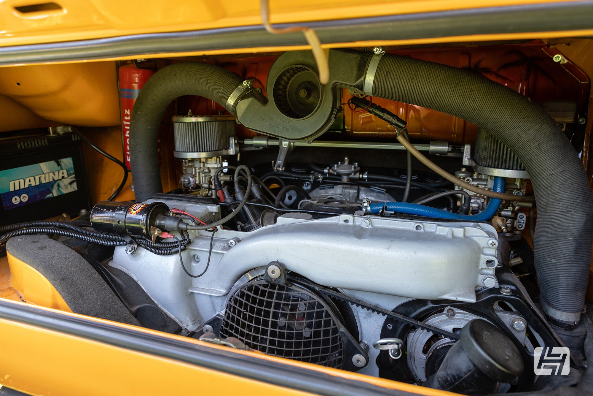

Possible it's a bus motor with 914 fan housing and oil filler/breather ,the bus/411 case has an oil tube which incorporates the dipstick ,if you have this you cut the filler tube off and weld it closed as I have done when using the 914 oil filler/breather.
The fan if a bus one it will need the timing marks redone to the same marks as the 914 fan unless that is already fitted ,cheers.

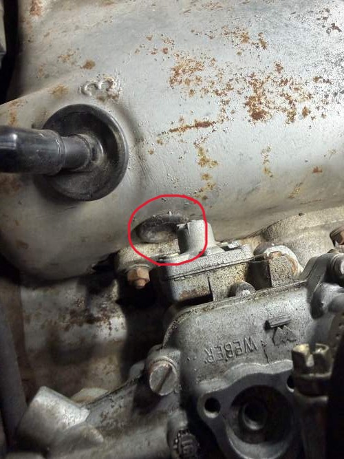

What are the chances this is it? Bottom left corner of picture is passenger rear. maybe dual carbs were put in? BTW I found out from the engine id its a 1.8.

That isn't the dipstick tube, it's the cylinder head temperature (CHT) sensor grommet.
Definitely could be a 1.8 liter case. Displacement could always be different now if someone has changed the crankshaft or cylinders.

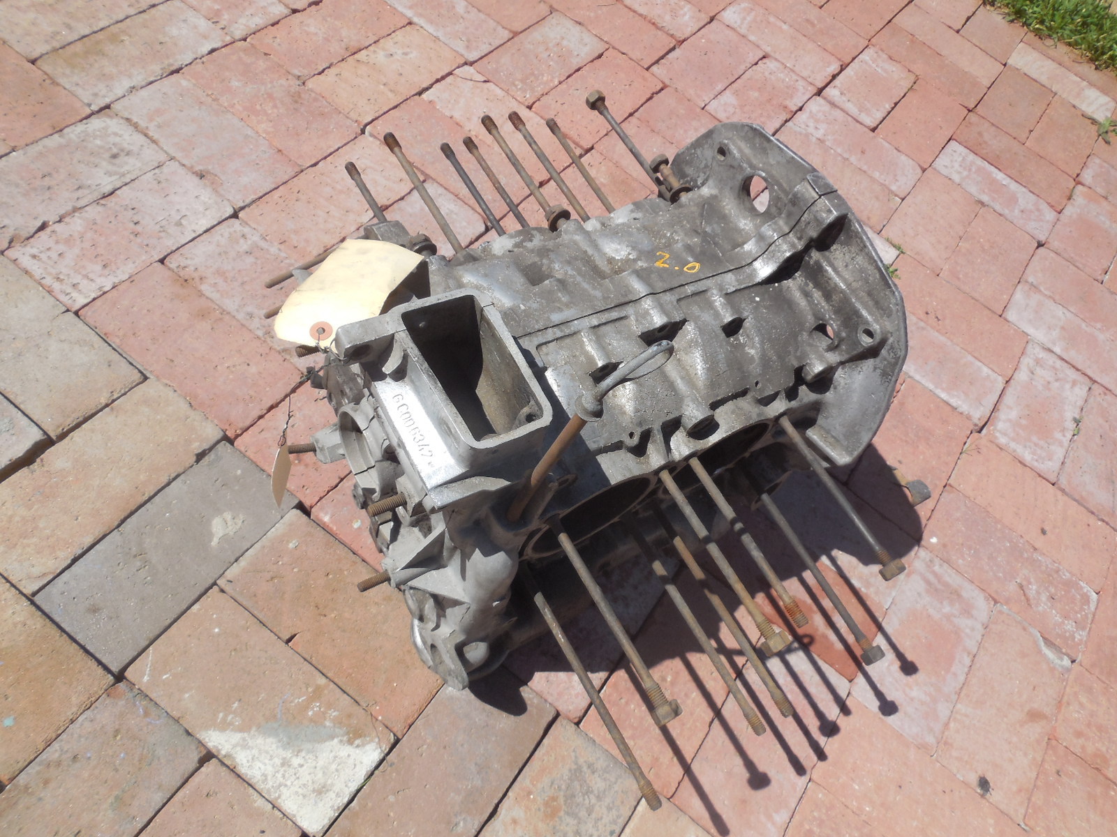

Here's a picture of the location of the dipstick tube on my 1975 1.8. Looks like you have the penetration through the tin but are missing the tube and dipstick. Needs a bit more investigation on your part to find out what the story is. Just to let us confirm what your engine is post a picture of the case number. The back story on this engine might also help us help you. There is definitely some funky stuff going on there. Never a good sign to see duct tape....
