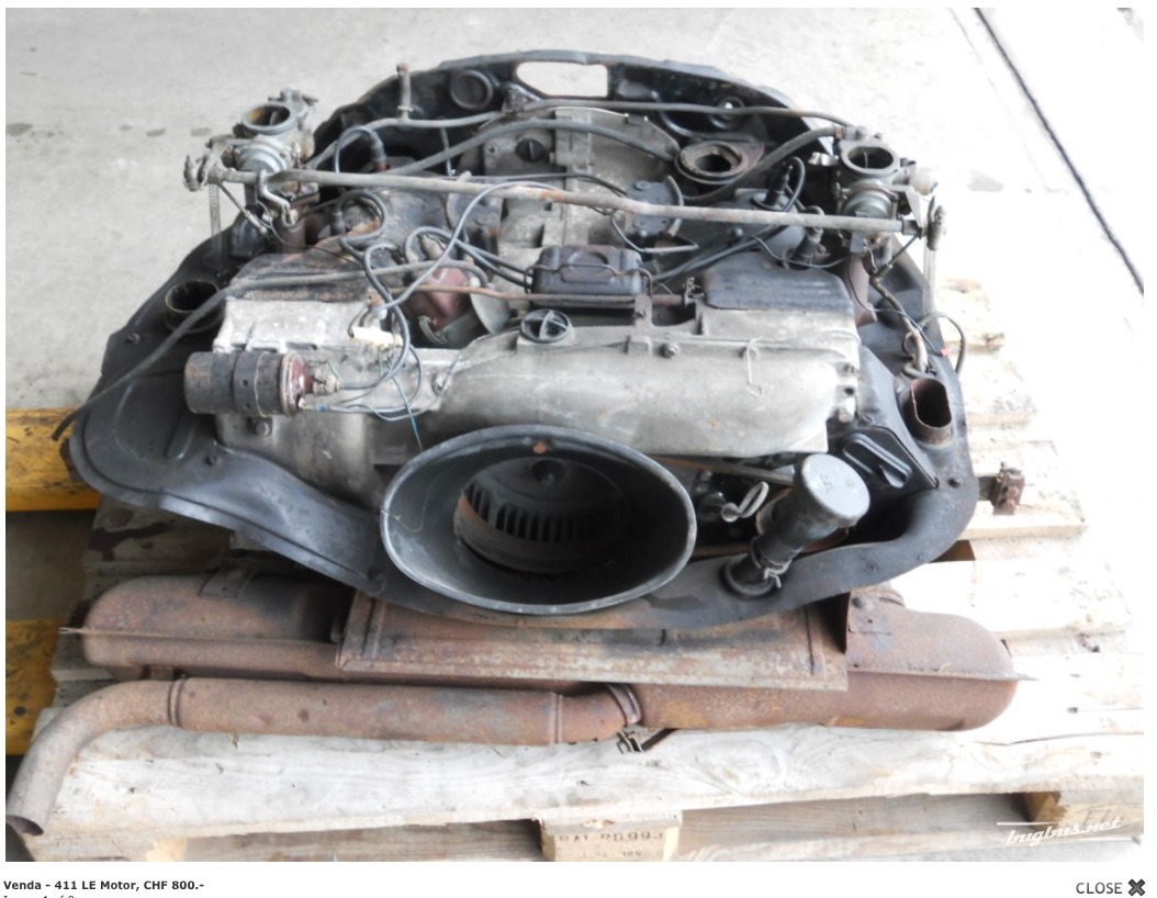

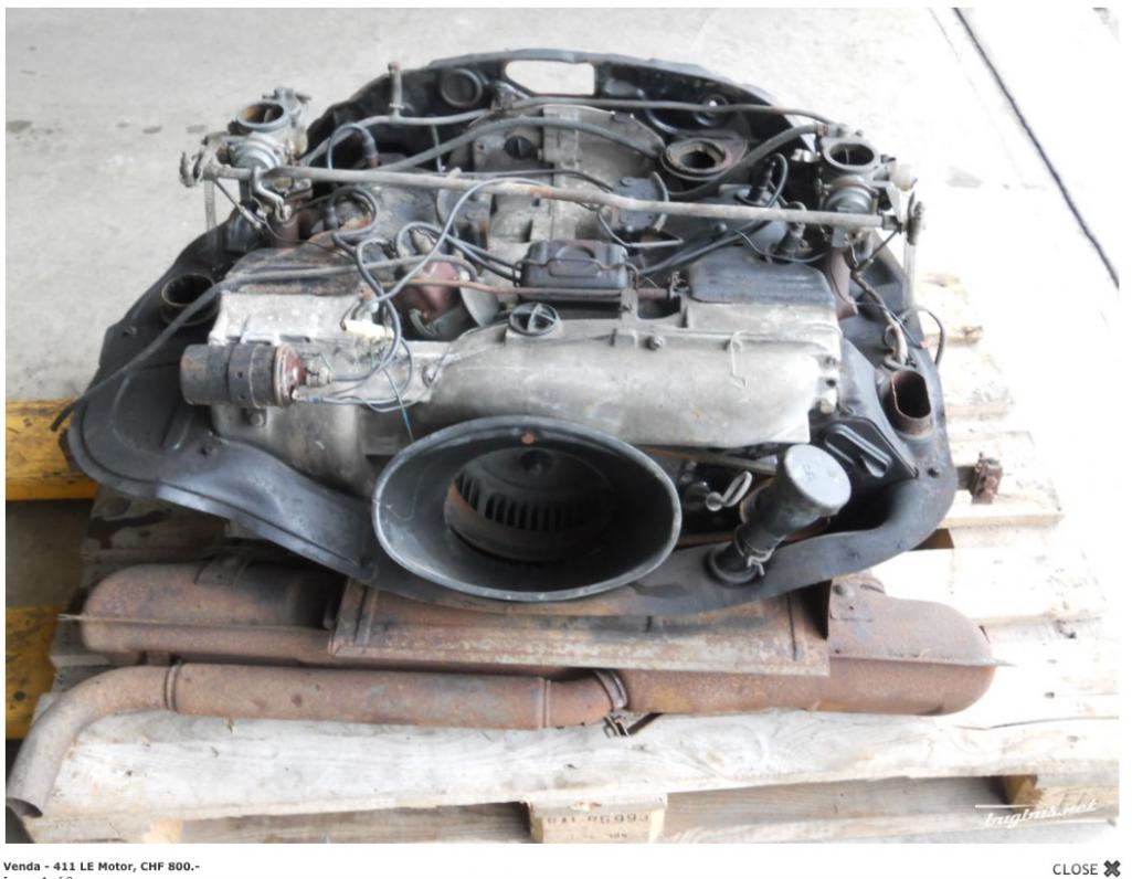

Only the six cylinder 914s came with carbs in the USA.
Still haven't figured out what this European Motor came in. Could still be from a 411, even though unlikely.
Did you see a dipstick here? (Check out photo)

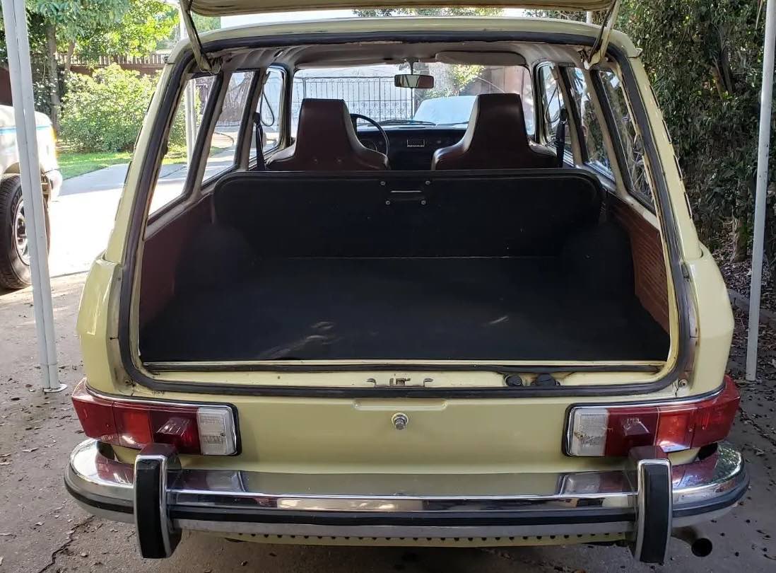

i remember it had a dipstick that ran up through to the tailgate reveal.
pretty much the same as a type 3.
it was a V 0etc engine too. still had its solex carbs.
but that was back then. don't know if that car even survived.
the sedans had the dipstick in same spot as 914s. the engine was not an underfloor job in the sedan and fastback.

some stuff to help.
74 412 sedan/fastback L jet engine. dipstick same as 914. (apron tin etc different of course.) earlier d jet sedans were same. and carb versions.
411/412 variant engine. dipstick and oil filler remote through tailgate.
reason - underfloor engine in the variant. same goes for the d jets and twin carb versions.
