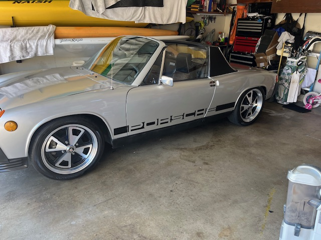

I’m running 16x6 Fuchs with 205/55-16 tires and I get slight rubbing on my right rear occasionally. Wheel wells aren’t rolled.

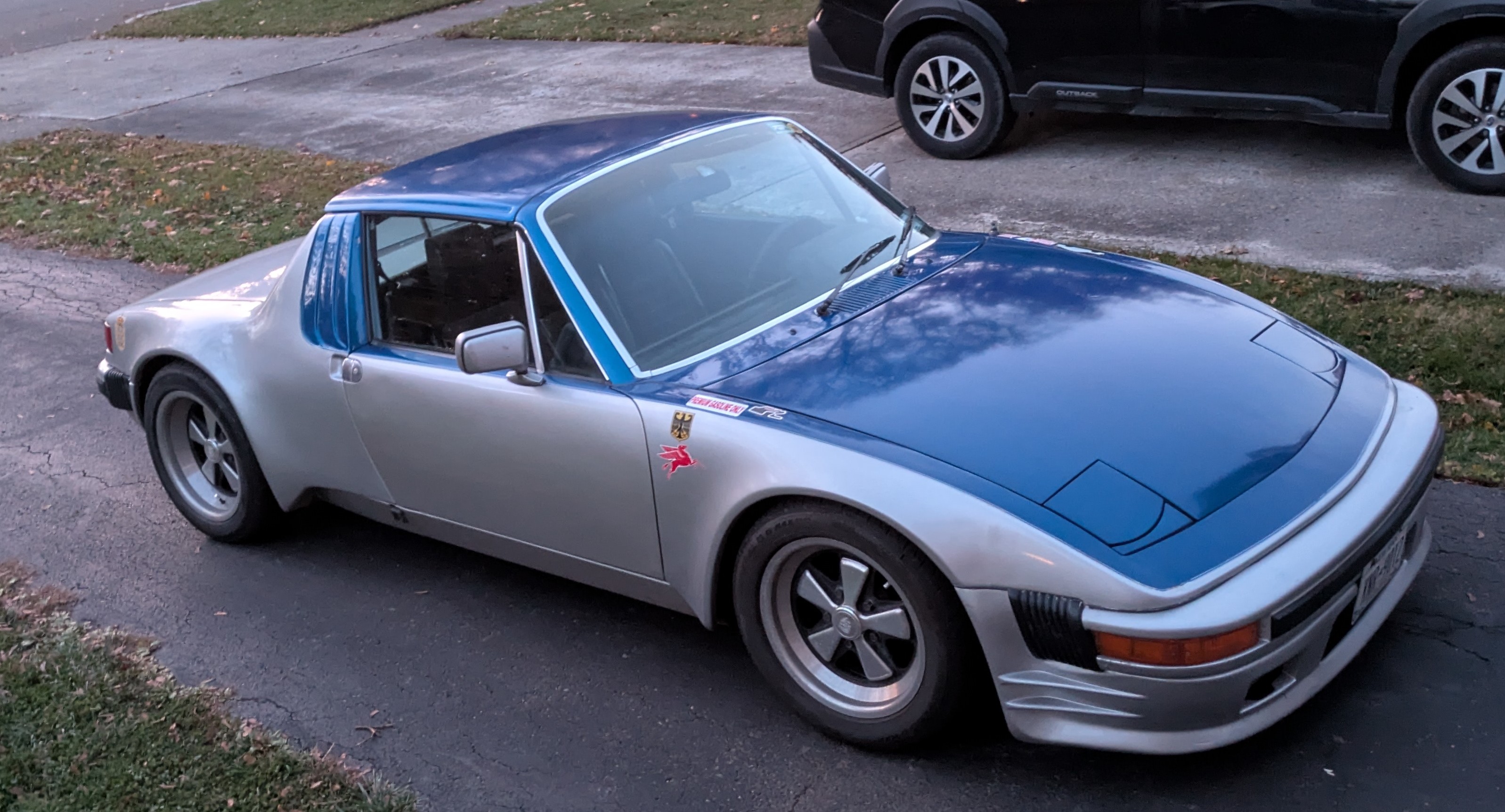

Let's see 205/55/16 vs 215/55/16. I want to use a set of 6X16s i have on my 6. I agree with Sir Andy that low profile tires look weird on 70 vintage cars. Maybe I should switch back to 15s. (IMG:style_emoticons/default/idea.gif)

Wills 951 16 x7/8s rear fenders worked over.. What you should have went with IMHO..
JKH empi 17 x 7s fit but low pro tires
