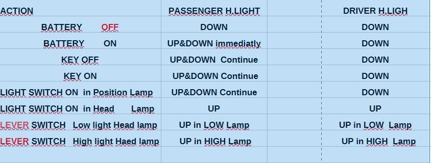

1) On my car, I have modified the fog lamp to DAY LIGHT with Attached Imagetwo LED connected directly to the POSITION LIGHT -
My FOG SW is completely detached from the diagram.
2) The DRIVER Headlight is OK, follow all commands
The PASSENGER Headlight have this strange gremlins
This DIAGRAM can elucidate better: Passenger HEAD L. DRIVER HEAD L.
CAR BATTERY EXCLUDED DOWN DOWN
CAR BATTERY CONNECTED UP & DOWN immediately DOWN
KEY OFF UP&DOWN continue DOWN
KEY ON UP&DOWN continue DOWN
LIGHT SW ON -POSITION Light UP&DOWN continue DOWN
LIGHT SW ON -HEAD Light UP Light ON UP OK
LEVER control - ON Low Light UP Light ON UP OK
LEVER control - ON Head Light UP Light ON UP OK
[/b]So My 914 can be drive on the road only with the Head light on UP positionAttached Image

One more understandable 914 GREMLINS FRAMEWORKS Attached Image
