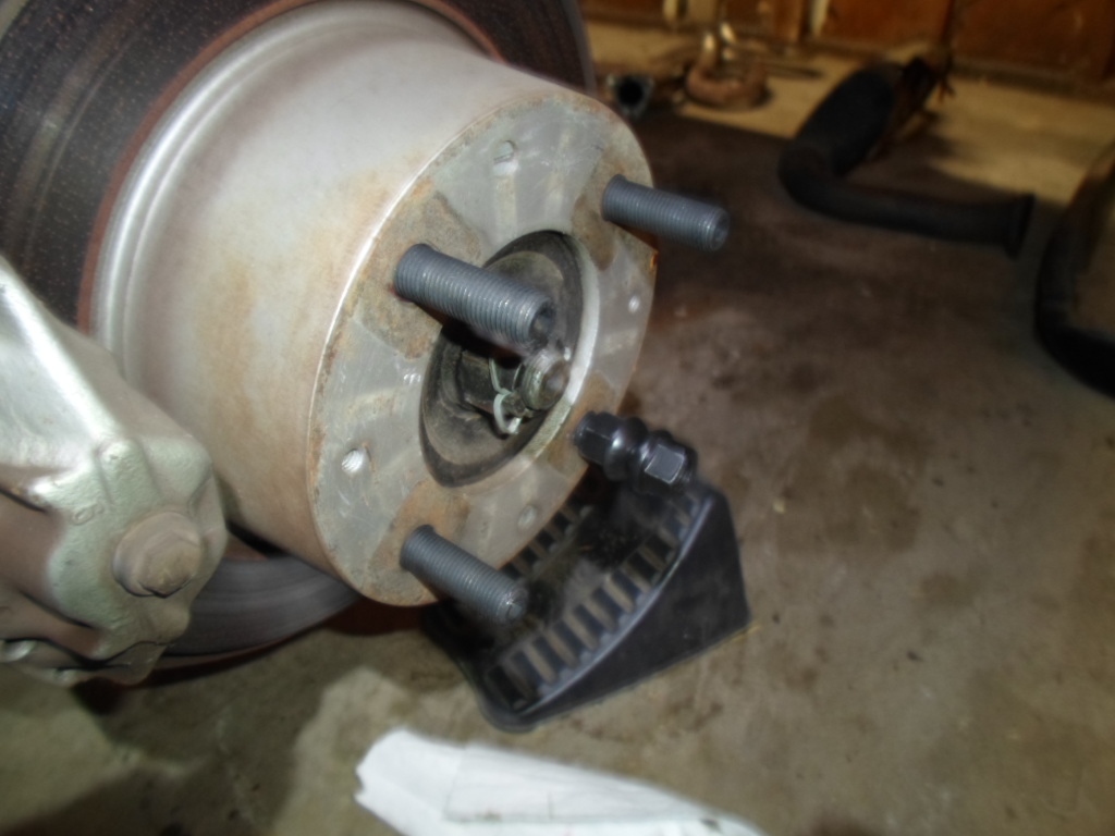

Both "Hub-centric" and studs are the recipe in my book.
My current set up uses 14-6 rotors drilled for 5 lug (PMBs stuff) with studs.
This set up is still lug centric in the back.
A member on here CNCd a set of hub-centic adaptors.
I bought extras...
The reason they went lug centric was associated with cost IMO.
It very quickly became apparent that a hub centric mounting was significantly stronger and easier to achieve wheel centering during installation.
In accidents the wheels stayed on the cars better with hub centric mounting.
I do not believe I've seen lug centric mounting on ANYTHING built in the last 3 decades...
