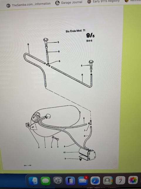

looking at parts diagram above and made me think.
checked the PET diagrams.
the later cars like mine with the black squirters have an inline check valve.
not part of the squirter.
i could get the inline valves from porsche.
if i recall correctly they are 2 straight inline valves and not a single t valve as shown on the parts diagram for later cars. i dunno whether they changed it again or i put inline valves in it way back 35 years ago when i was preparing the car for road registration in australia and i got the windscreen washer system up and running way back then.
and i dunno if the earlier squirters come apart and the check valve can be removed from the bottom of it. but you definitely could get the inline valve. tube in and tube out. and the valves can misbehave and stop the system squirting.
