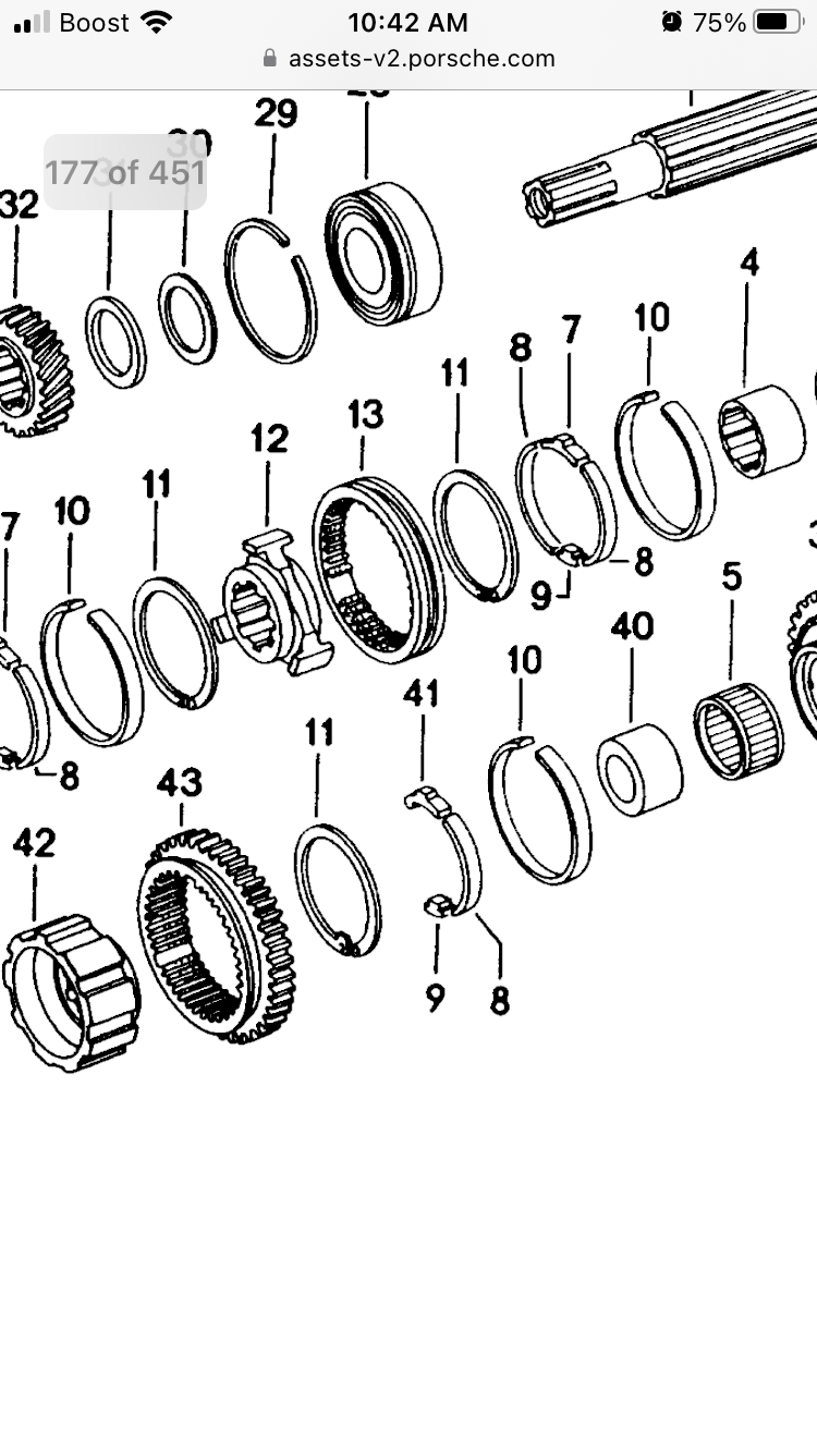

Please observe parts 41, 8 and 9. Syncro only on one side, up shift only.
Just saying.

Actually, those are the brake bands and stops/anchor block/thrust block. The "syncros" (synchronizer rings) are actually #10.
And yes, only one brake band on first gear (although, IIRC you can use parts from gears 2-5 to run two brake bands on first gear if you want to for some reason).

43 is $$$$$
Dr. Evil sold me one that was really good - I bought a core to raid for parts and it was the cleanest transmission of all of the ones I have!!!! Sometimes you get lucky.
