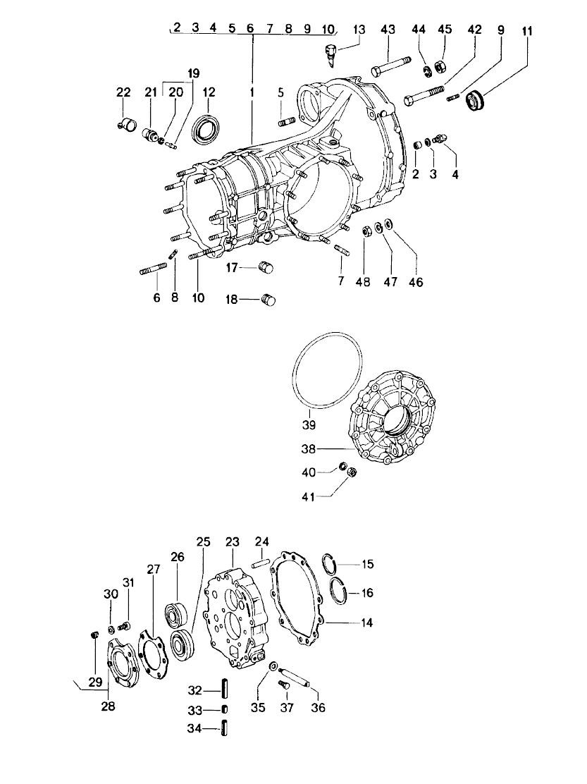

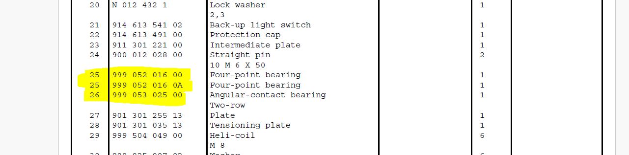

Thanks. I had been looking at the shaft exploded diagram.
Do you know the difference between the ...016 00 and ...016 0A?
These things are not cheap!
Montreal914
post Apr 7 2026, 11:27 PM
Post #44
Posts: 2,229
Joined: 8-August 10
From: Claremont, CA
Member No.: 12,023
Unfortunately I do not. Numbers gets superceded. (IMG:style_emoticons/default/confused24.gif)
Nope, not cheap. The differential bearings are but they tend to last.
