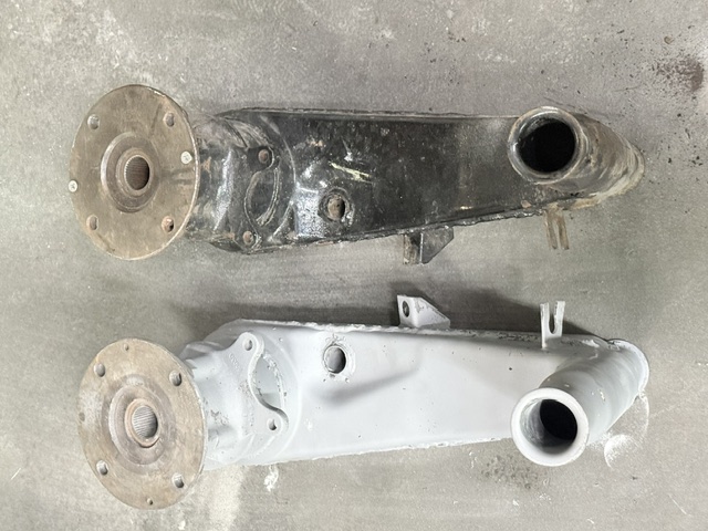

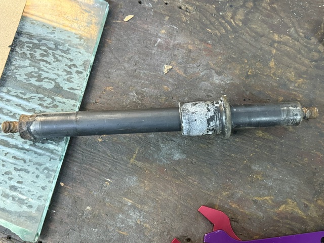

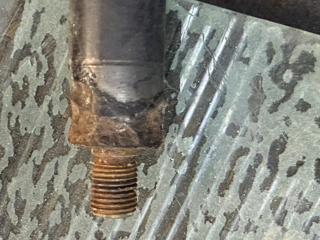

Started cleaning up some trailing arms. They will get the tangerine mod so I can use 911 e-brakes and then I will figure out some sort of finish that doesn’t have to cook in the oven (the tangerine mod has a plastic liner).
Typical east coast corrosion on the pivot axles. I have a better set somewhere.

for a finish you don't have to bake,,,,,maybe consider an alkyd enamel like they use on trailers. That's what I'm planning to use on my suspension pieces. They even have a few different colors at places like tractor supply.

QUOTE(Alain V. @ May 26 2026, 07:24 PM) *
Good idea. I'll try it.

Cerakote offers the C-Series, a line of ambient-curing ceramic coatings specifically designed to air-dry without the need for an oven or catalyst. I believe Chris Baker used this coating on the exhaust and other pieces on his LS Swapped 914. I've seen the coating in person and it looks the same as the oven baked Cerakote on my fan shroud / exhaust.
I'm a powder coating / Cerakote convert - I powder coated/Cerakoted everything that came off my 914 while I was doing the motor swap. I wish I had powder coated the sway bars, brackets, etc. before I installed them. If I ever have to tear into the front / rear suspension, I'll Cerakote all of those parts too! I'm addicted to it. (IMG:style_emoticons/default/biggrin.gif)
We powder coat and cerikote at the shop. I was looking for something with more thickness than cerikote for the trailing arms. Then it will match up better with the rest of the suspension. But realistically, once its under the car, I really won't care.

My body shop guy used his (non oil base) automotive paint, clear coat, in the spray booth and results are good. Durable too, easy to clean and not easy to chip .

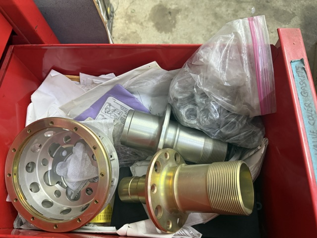

Love the center locks. We have a set at the shop but my customer would be pissed if they ended up on my car and not his.

QUOTE(mepstein @ May 27 2026, 08:13 AM) *
QUOTE(Maltese Falcon @ May 27 2026, 10:04 AM) *
Don't Don't it (IMG:style_emoticons/default/happy11.gif) !¡!

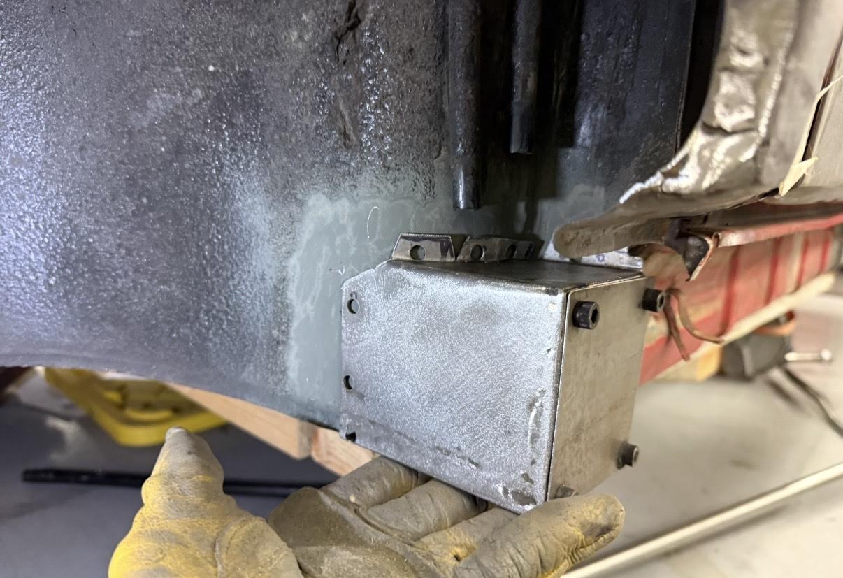

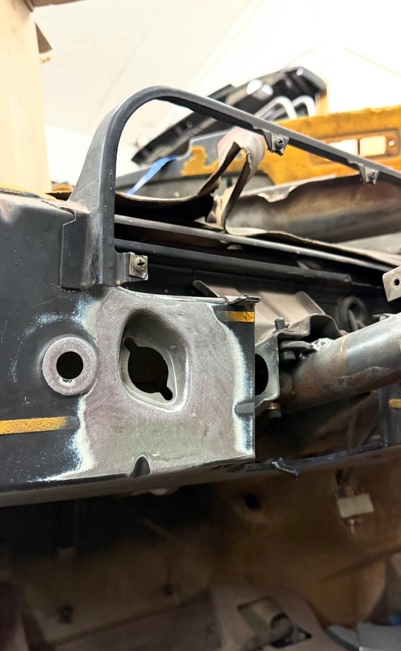

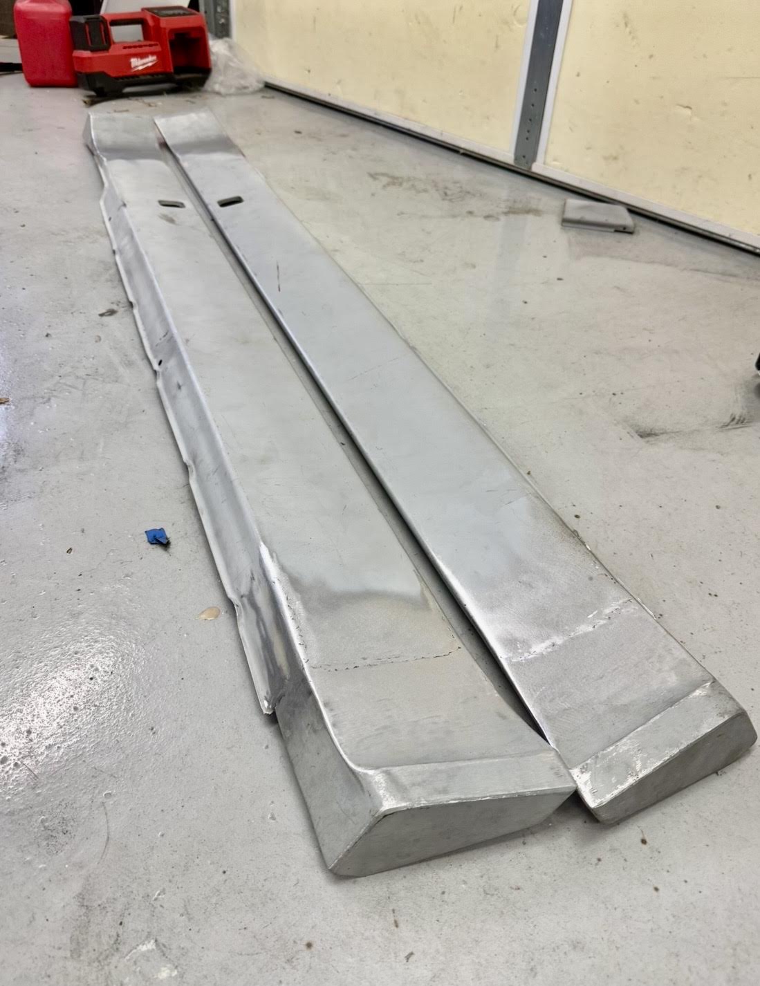

Didn't realize there was a build thread for this. I would have contributed sooner (and sent Epstein nicer photos, these are just proof of life quickies, haha)
I think the car will be 100% done today. I've had it about a year and a half, the bulk of the work (reinforcement, etc) was done quickly. Its the GD last 10% that takes the longest. Find a new hole here and there, patch it up, find another...
Lots of previous work done on the car, some very poorly, some ok. Many hollow spot welds, rough blends, etc. I fixed a good bit of it....
Mark and I went back and forth a good deal on what we fix, and what's acceptable for a driver level. I wish i had more time to devote solely to make this the a crazy bad ass GT. Eitherway we agreed, at some point you just gotta phone it in.
Anyways, what's left written in my notebook:
-Rusty area found on the bottom lip of nose panel
-Rust hole on front DS 1" or so needs patched
-Blend the fender roll on front DS better
I think thats it. Here's a couple pics of other work.
Looooove this 911 ignition:
(IMG:http://www.914world.com/bbs2/uploads_offsite/i.imgur.com-23209-1779979964.1.jpeg)
Flared side skirts:
(IMG:http://www.914world.com/bbs2/uploads_offsite/i.imgur.com-23209-1779979965.2.jpeg)
Cool little box with an bolt on lid to hide the Oil cables:
(IMG:http://www.914world.com/bbs2/uploads_offsite/i.imgur.com-23209-1779979965.3.jpeg)
That duct was by far the most time consuming - don't tell my job how many hours I spent in solidworks making a 3d model of that, with 3 full assemblies built for testing. Shew!
Cannot wait to see it painted. Glad Mark will finally have this car back. (IMG:style_emoticons/default/smash.gif)

Those Centerlocks are cool, but what a pain for a street car haha

QUOTE(2mAn @ May 28 2026, 11:24 AM) *

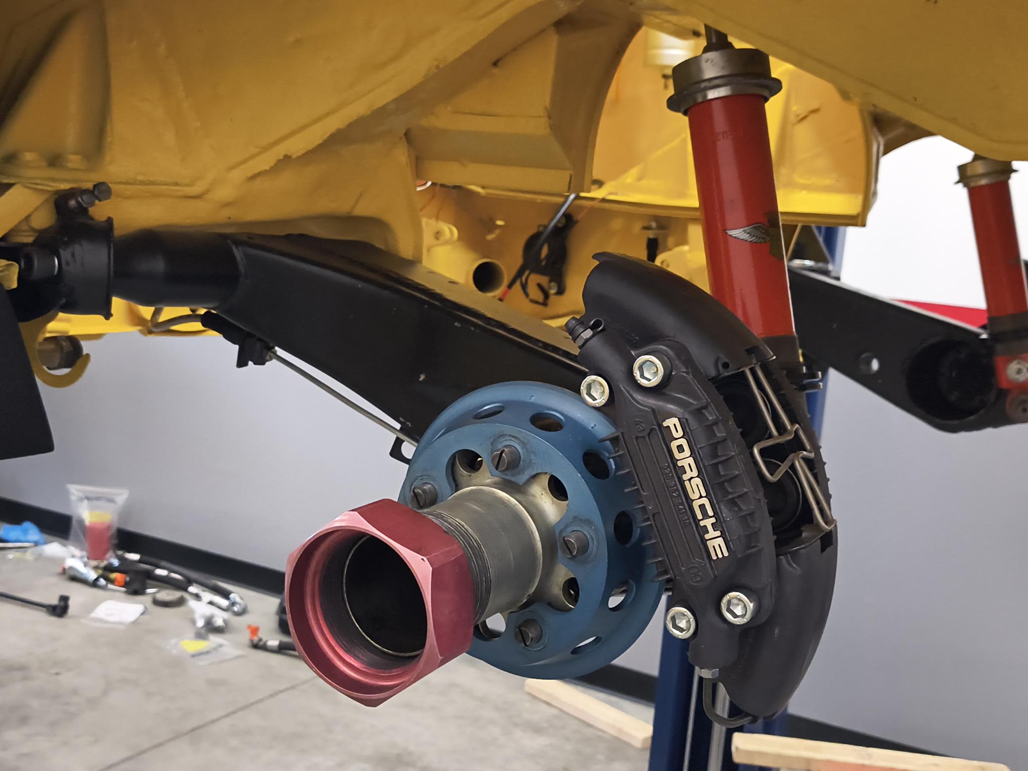

Got that covered with Paoli c/l elec for ride-along / Paoli nitrogen-tank powered for time-trial days ¡
ForgeLine Wheel Co. does supply a basic Torque bar for basic wheel mounting in the shop.
(IMG:style_emoticons/default/marty914.jpg)

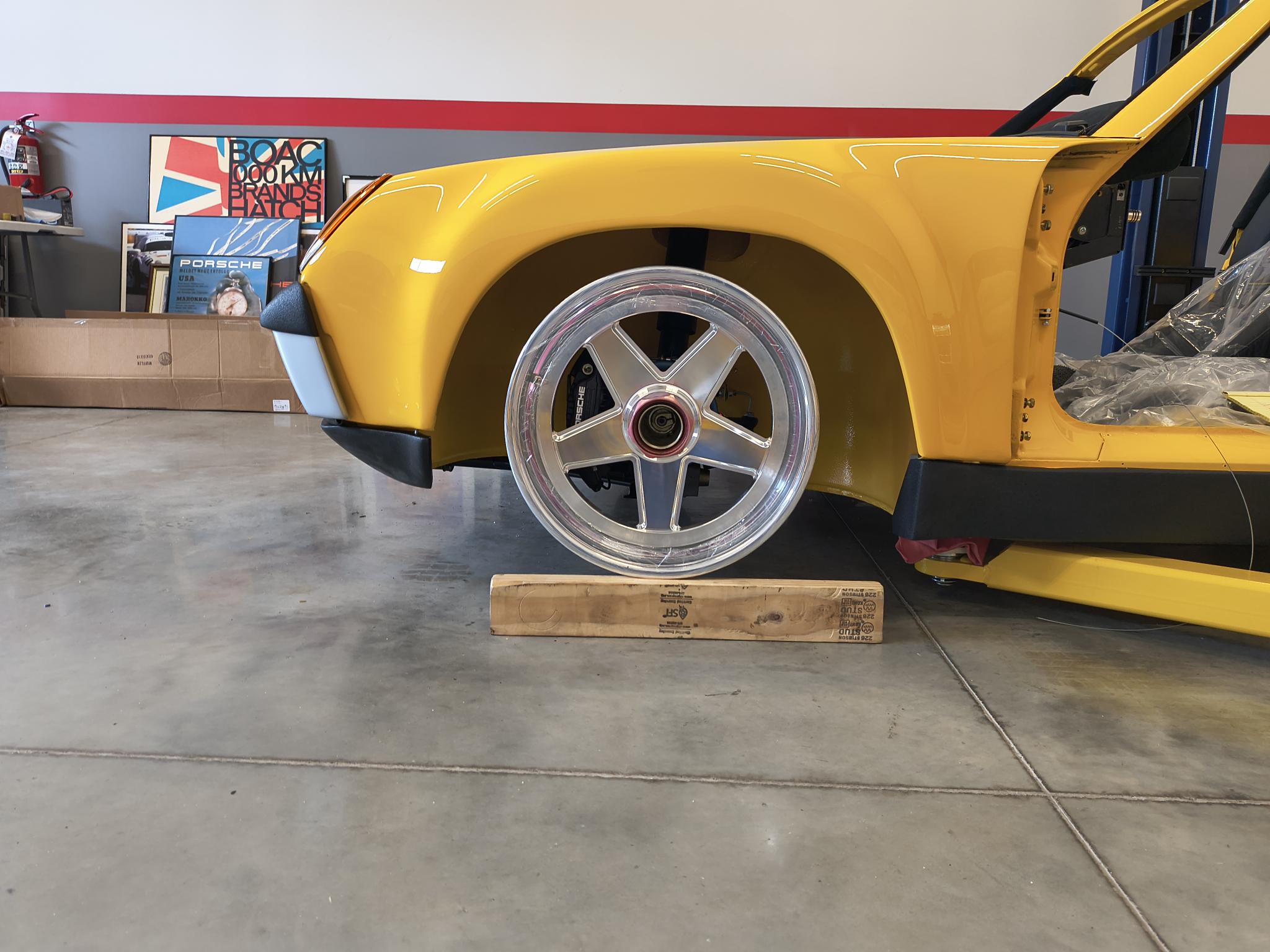

Center Locks are cool, but they require a bunch of work. Forgeline built a test wheel for me for fitment purposes. We are in the final stages of powder coating. I have them fitted to the car with early RSR hubs. Not the later stuff.
Don't worry about the red & blue being mixed up as the brake hats are only for fitting. Turbo brakes all around. It's going to be a hot rod.....
Fronts are 8x17
Rears are 9x17
