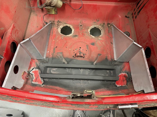

Prepping the front trunk before we cut the hole in the nose.
Did this exact same bracing
I’m not cutting a big hot air exit hole - using the stock openings that have the round plates glued down. I just felt better about strengthening up the metal that connects the two mounts for the front suspension. A lot of people add a lot of metal to the back but seem to neglect the front.

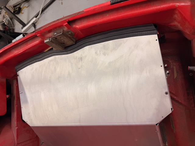

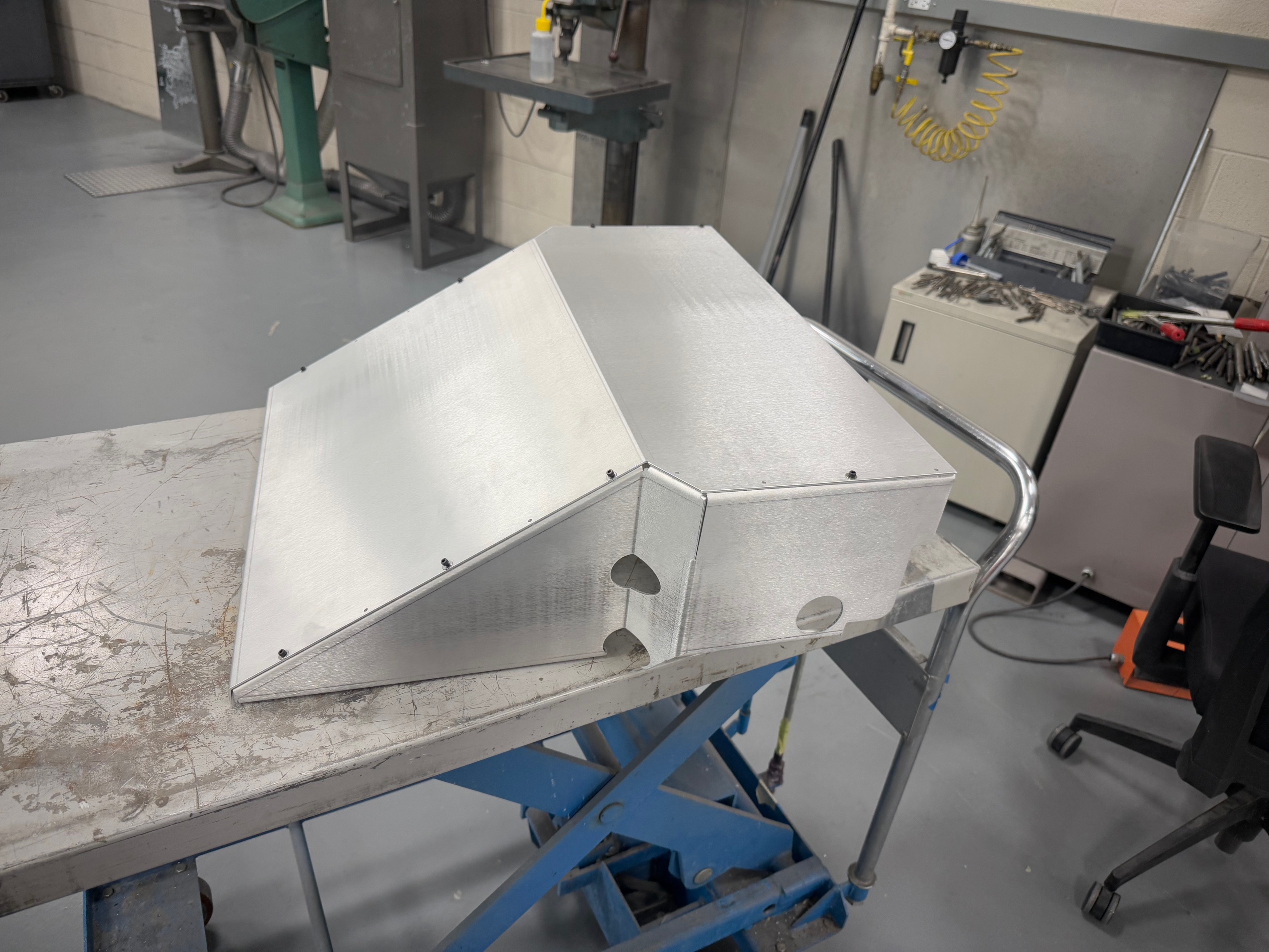

Jared made the big box. It will hold the a/c condenser, the oil cooler and fan pack

QUOTE(mepstein @ Feb 24 2026, 08:02 PM) *
@Steve
@mepstein very nice! Where are you going to mount the compressor?
Probably on the bulkhead in front of the fuel tank. The CR unit comes with a mounting bracket.

Jared has made some adjustments to the big box. I think we are almost there.

@Steve gave me the template for how to install it in a 914. We’ve installed six of the classic retrofit a/c systems in 911’s over the last year. The 914 won’t accept their cowl mounted evaporator/blower. Steve has basically duplicated their kit but used an in cabin evap/blower unit that’s available from many sources. A 911 Carrera condenser in front of the nose mounted oil cooler and it’s pretty well set.
Note - Steve sourced all the parts separately and built his system. I bought a classic retrofit kit and will substitute the cabin unit for the stock cowl blower.
I still have to get the car painted so the a/c isn’t going in any time soon.
Other than the ecu that comes with the classic retrofit kit, all the parts are still basically available off the shelf. I bought the kit for under $2k from someone who got it early on and never installed it in their 911. Currently, the kits are about $6k and the last one I bought for a customer came with a $2400 tariff.
Steve also pointed out to me the Patrick Motorsports install. It looks pretty clean but they install the condenser in the rear quarter, opposite side to the oil tank. Our experience is getting the condenser away from the engine and in front of as much air as possible, maximizes the efficiency of the condenser. I am concerned about placing my a/c condenser in front of the oil cooler but I have a bank of electric fans that will hopefully keep radiant heat from the condenser and existing out the back of the cooler box. I can enlarge the rear openings and even add more fans if needed.

QUOTE(East coaster @ Apr 5 2026, 06:27 PM) *
Curious about the cuts here (are they cuts?) and why they had to happen. Looks like it’s coming together nicely!
It's a common GT mod. Reinforcing the area between the suspension mounting points. Maybe helps, maybe not. Between cutting a big hole in the front and running big tires, I like the idea and had Jarred execute it. The small pieces were cut out so the metal stock could be welded to the top of the suspension points. Then the pieces are welded back in place.
I've always felt like a lot of attention is paid to the rear of the car in regards to reinforcement but not much in the front.
