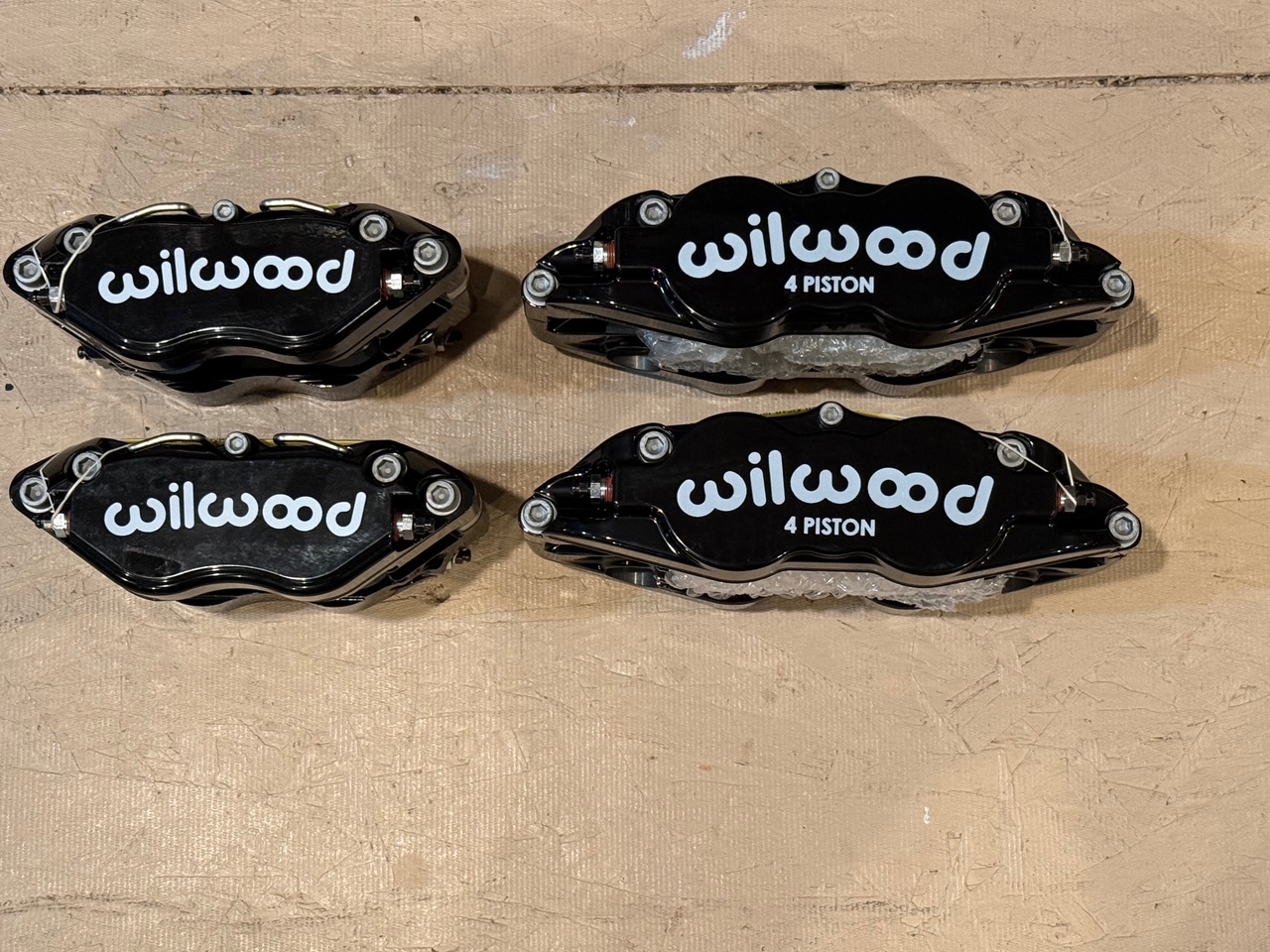

Wilwood calipers are not an obvious choice on classic Porsche’s but we put a set on a customer’s hot rod 911 and I thought they were fantastic. I use a long down hill to bed in pads. It makes it easy to accelerate to speed and get the rotors up to temp. By the time I got to the bottom of the hill, the brakes had gone from good to great and were hauling down a backdated Carrera with power to spare. The RSR flairs had wide Michelin TB15’s and 320 hp and the brakes took control of the car. They are probably a bit overkill for a 914 but more is better, right? My 67 hot rod is also getting a set. No rehab needed. Just pull them out of the box and bolt onto the car.

3 or 3.5" front?
Rear E-Brake with 911 inner shoe?
post Apr 9 2026, 09:04 AM
Post #90
914-6 GT in waiting
Posts: 20,892
Joined: 19-September 09
Member No.: 10,825
QUOTE(Montreal914 @ Apr 9 2026, 10:07 AM) *
3 or 3.5" front?
3.5” front
They have a rear e-brake add on for about another $1k but I’m using 911 ebrake with the kit from tangerine racing.
My 67-911 will actually have MCS coil over shocks and 935 style front suspension but that will burn the wallet for a while so I haven’t completely put together the suspension for the 914.
Plug - We are an MCS dealer if anyone wants a set for their Porsche.
