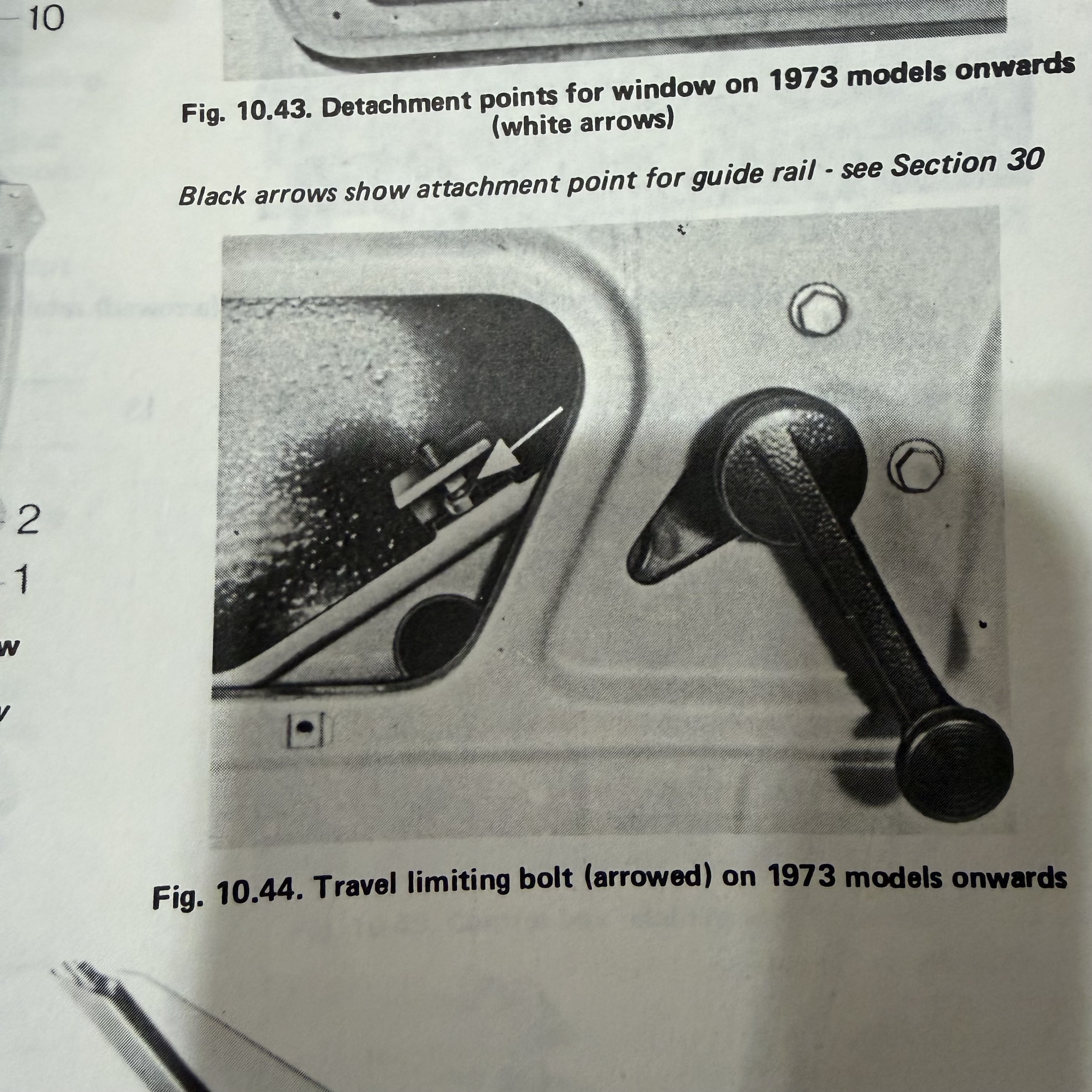

Page 205 of the Haynes manual. (but i think that may be for UP only...)

Thanks for sending this - it really helps.

I think you're totally right. The bolt only works with the up mode. Thanks for the feedback.
