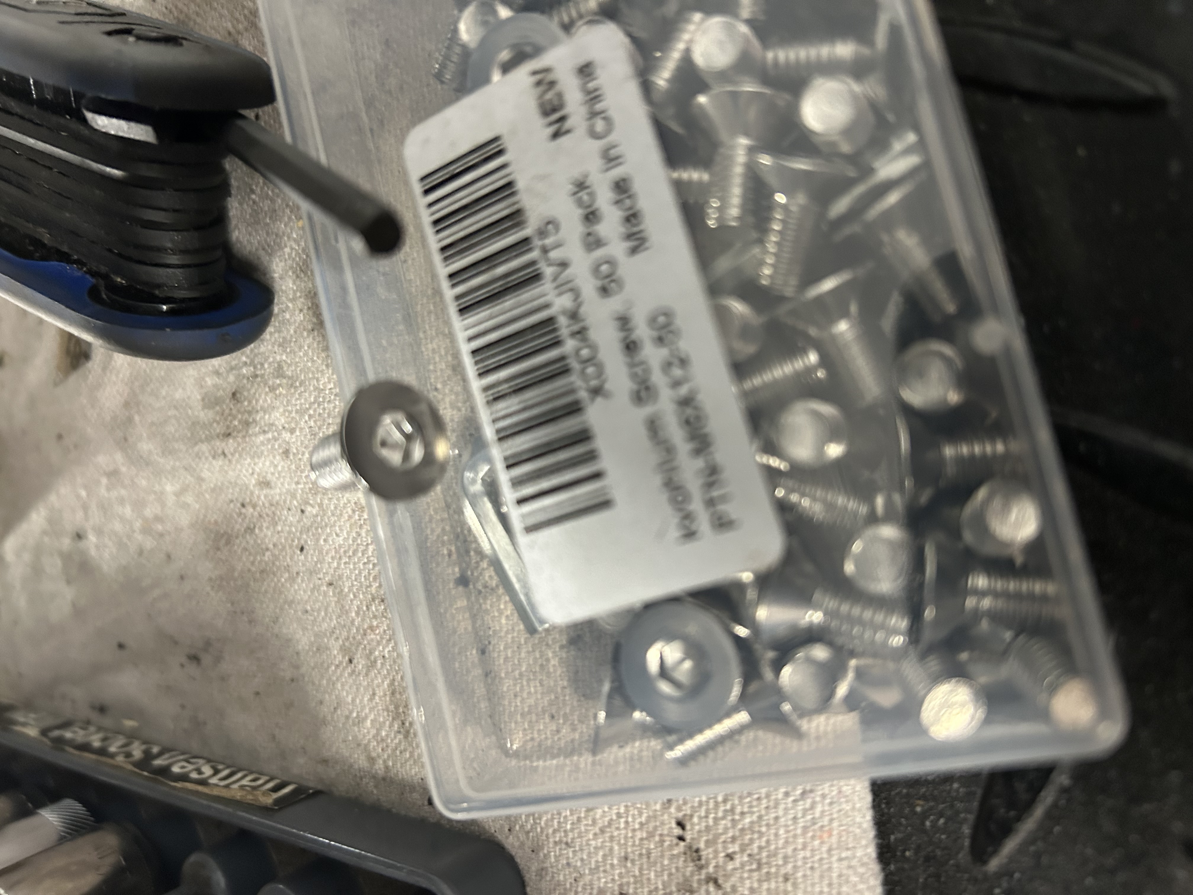

HFC3   Started on the sails. Trim is just laying there. ...   May 22 2026, 05:47 AM
HFC3   Sail panels and trim completed. Rear suspension is...   Jun 4 2026, 04:59 PM
