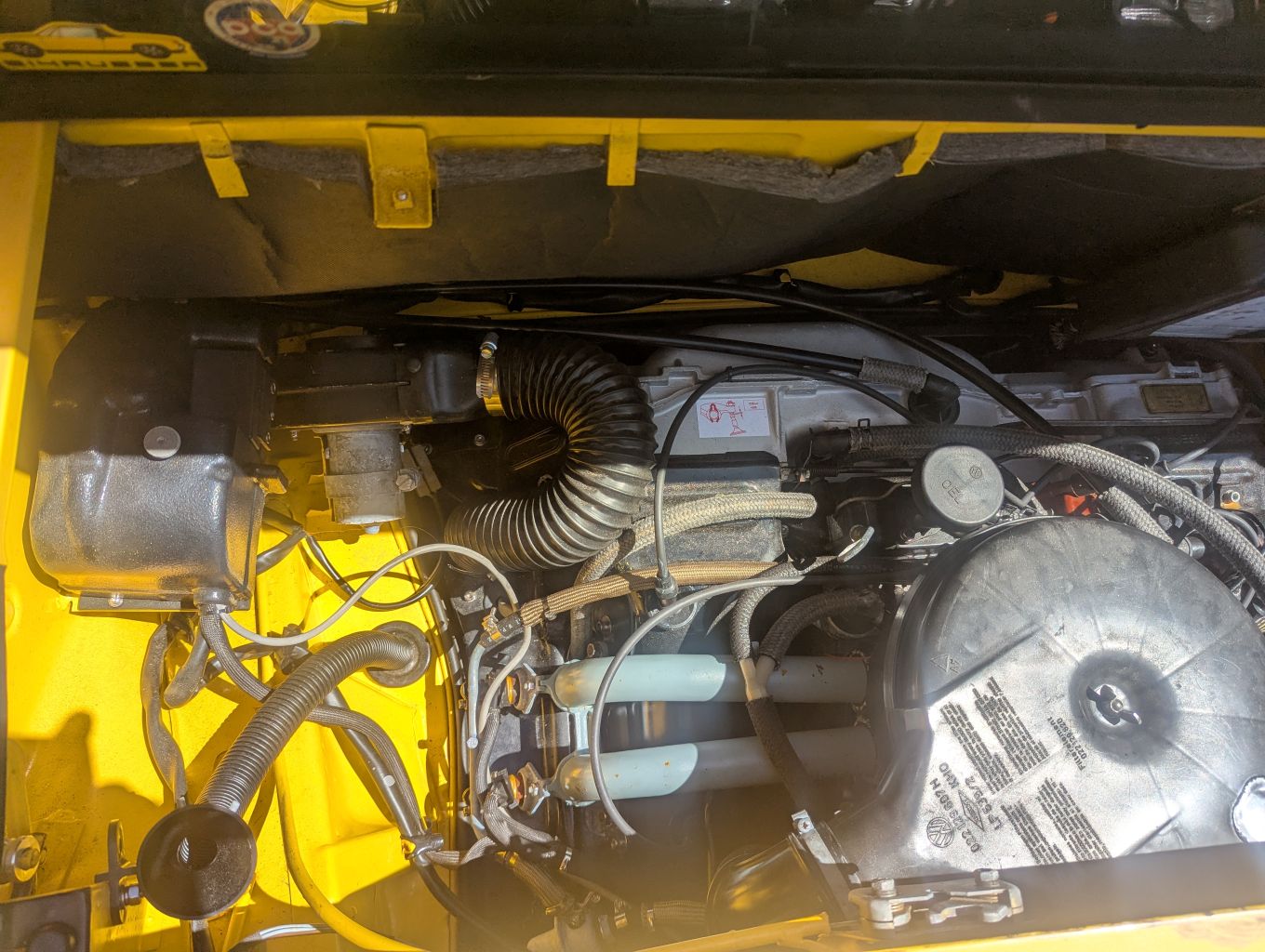

Please post a few photos of the engine bay & DJet components and connections.

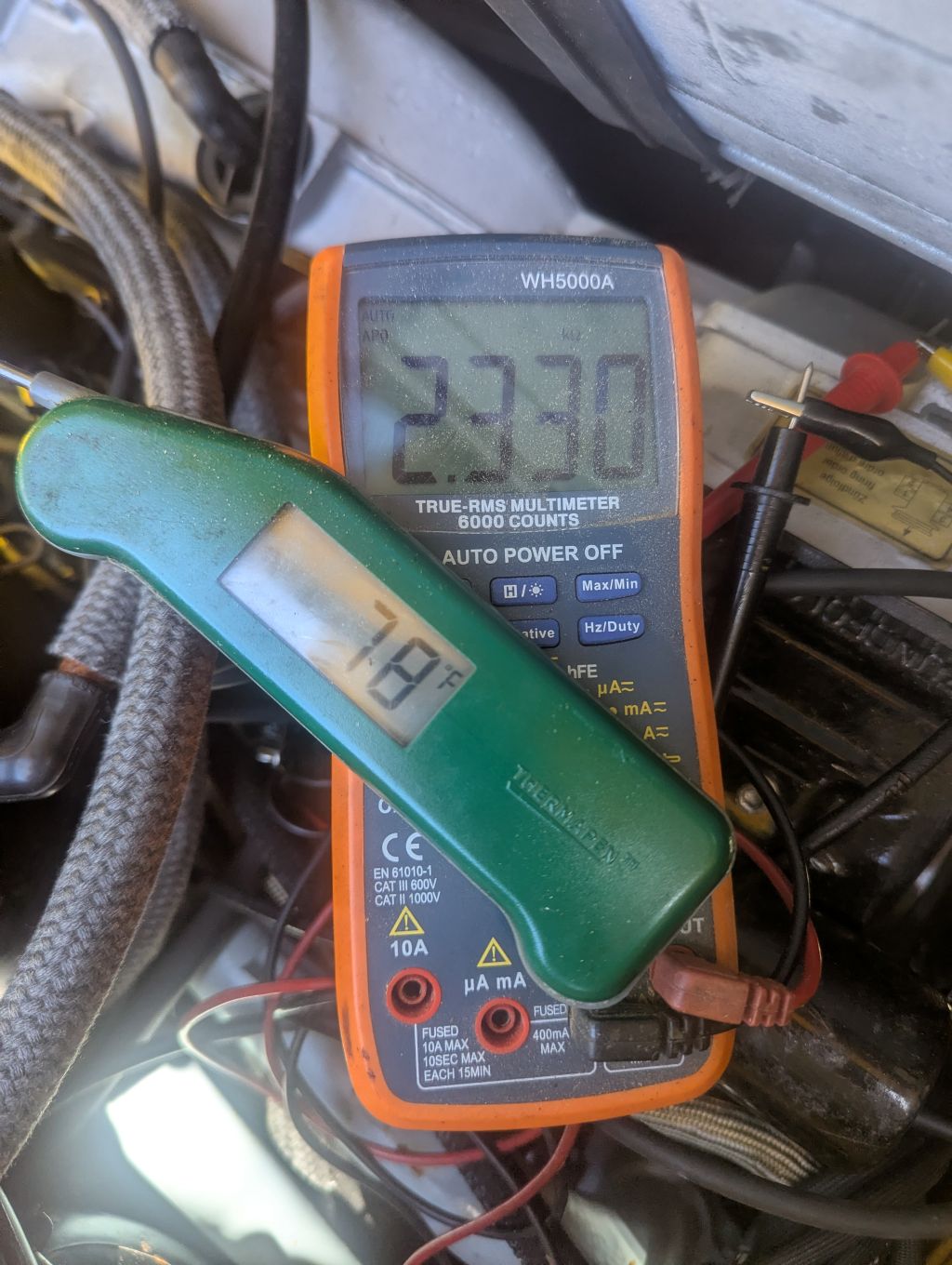

CHT problems - your description of how you verified it is too vague. Which CHT do you have 012 or 017? I’ll post the full calibration curves for each across the whole temp range.

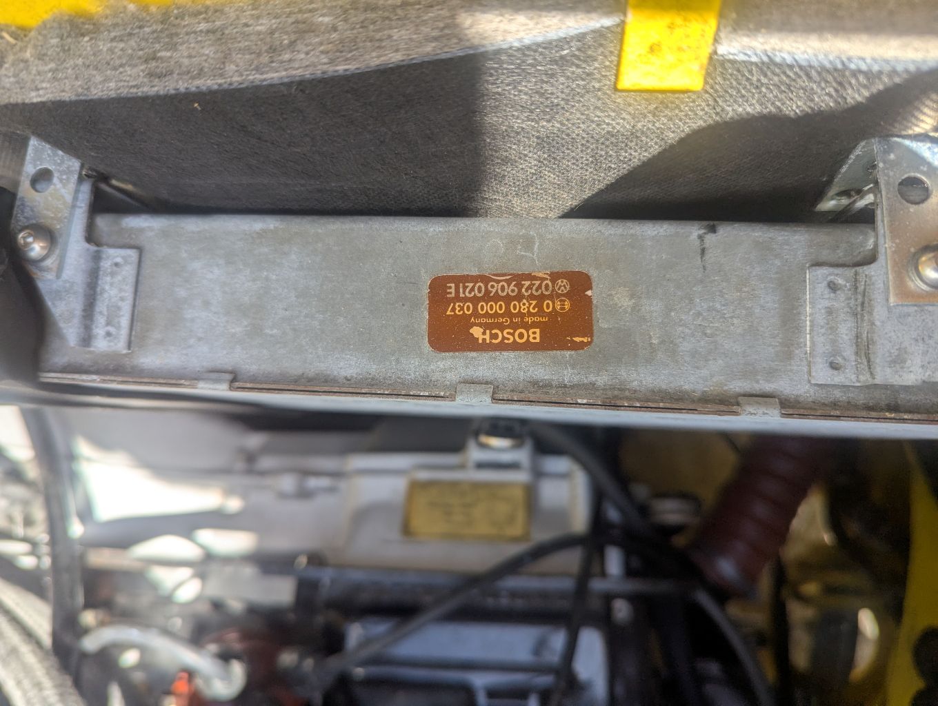

Mismatched components. You reference the Anders and D-jet site but didn’t explicitly confirm you had matching ECU, MPS, CHT, etc.

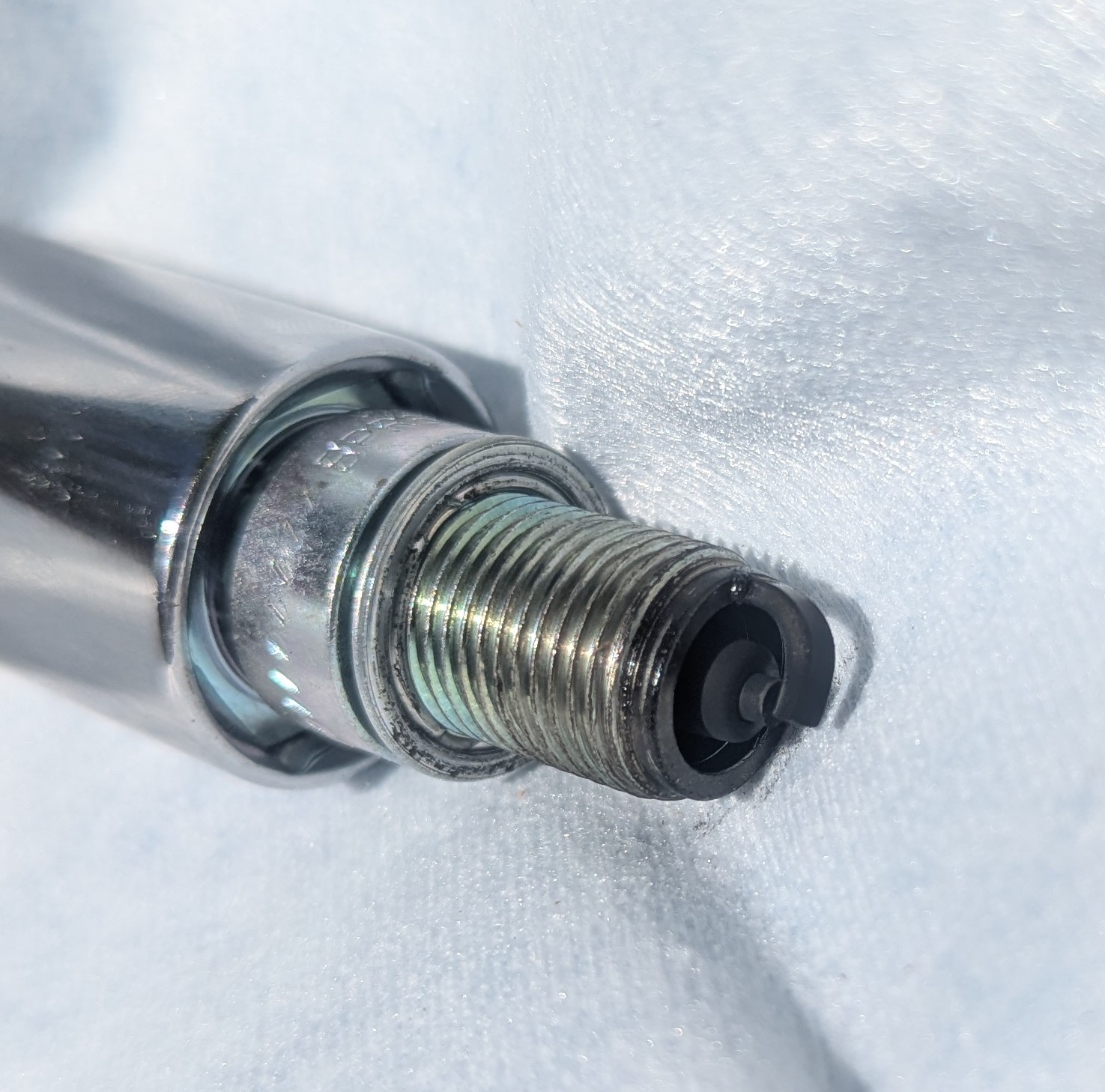

Post photos of plugs. Have plugs been changed since they were originally fouled? Plugs that are heavily carbon and fuel fouled don’t reuse well and can be a source of frustration. It sounds like you have - if so post photos of how they look now.

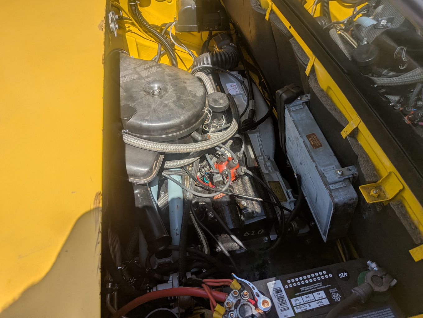

Aloha and thanks for all the valuable inputs!
I wasn't able to do any heavy duty troubleshooting today, still had to work and all that. But I was able to do some basic things and take some pictures.
I thought I figured it out when I looked at the remanufactured MPS and it was not the 049, but instead 003 part number. I called Auto Atlanta where I bought it and talked to Dr914 who assured me that the 003 part was fine, so that does not appear to be the issue. The remanufactured MPS has the adjustment screw epoxied, plus without an AFR hooked up, I wouldn't even try to adjust it. The MPS holds a solid vacuum, no leakdown after 5 minutes.
I pulled all the plugs and they looked carbon fouled, which is strange since they are brand new and I've only been able to get the engine to run in fits and starts for a minute or two since I replaced them. Probably less than 15 minutes total run time with those plugs. I assumed the mix was way too lean, that's why pumping the gas kept it running, but maybe not. But I would think if the mix was still too rich, I wouldn't be having this problem.
For the rebuilt harness I tested each connection at the ECU plug and everything appears to be correct. I used the 914Rubber kit for the component ends and the ECU end is from Repo-Parts in Germany with all new weird fork-spade plugs. Good quality TXL 16 gauge wires, with 14 gauge going to the relay board plug. I'm pretty sure the wiring harness is good, but in retrospect, I should have just bought one from Bowlsby in the first place. Fuel filter is brand new, hoses were rerouted, I relocated the fuel pump up front and I don't think the lines are kinked, but I'll pull the tank this weekend to check.
I was not able to test the fuel injectors today, but I will pull them this weekend and test. I had sent them off to Mr. Injector to get cleaned and qualified, but with all of the fuel line installation and rerouting there could have been goobers in the fuel line after the filter that got sucked in, but I'm think that would have also been a problem when the failed MPS was in too, and I was gettimg way too much gas rather than too little.

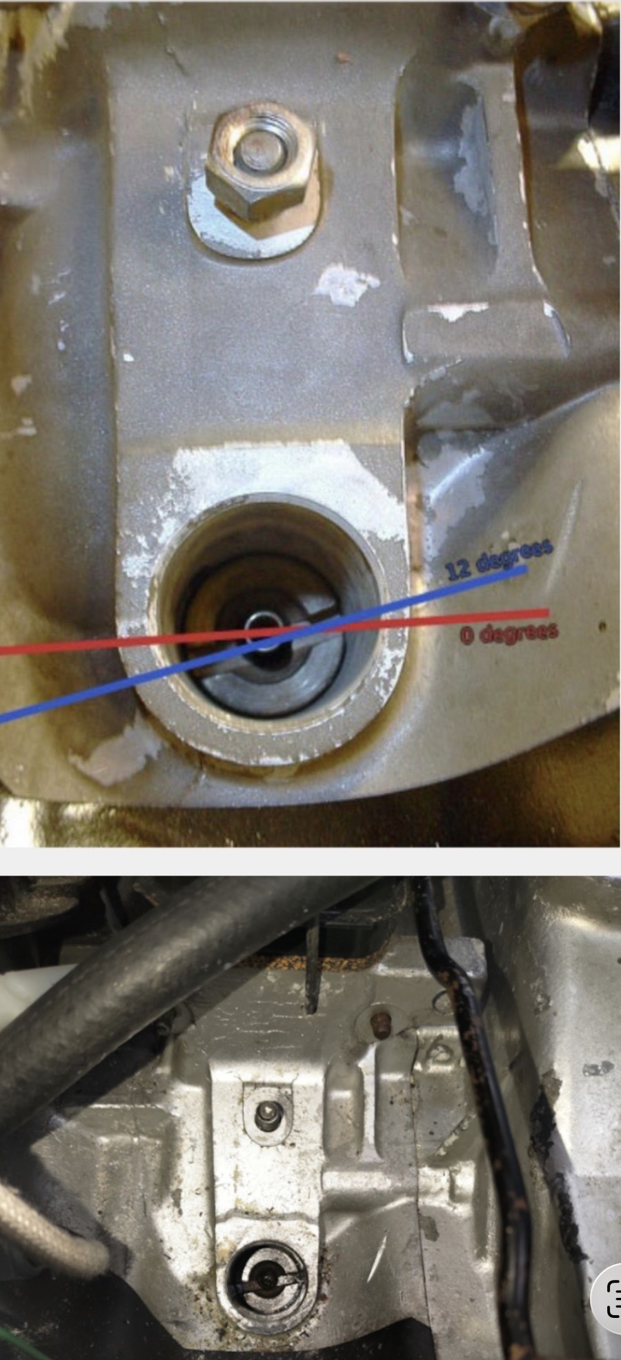

I'm almost certain the dizzy is installed correctly. I had the engine out of the car when I installed it and was able to verify I was #1 TDC by looking at the armature in the old dizzy, pointed at #1 and by checking the valves were both closed on #1, I could get the feeler gauge in between the rockers and the top of the valves but not on #3.
I've never adjusted valves before, but with a decent feeler gauge and the engine out of the car it did not seem like a real challenge.
Spark seems good, but with the new fouling on the plugs it's at best a subjective assessment. I ordered another set of plugs for this weekend.
CHT test out at 2.3K ohm at 78F, which puts it on the 012 curve, tested at the connector for the CHT and at the ECU harness plug. All injectors test out at 2.4Ohm at ECU plug.
I have replaced all the vacuum hoses and the intake runner plenum hoses, they seem really tight but I did not pipe clamp them on since they fit so snug. I just bought a smoke tester and will check for leaks this weekend. But, and check me on this, as long as the engine is relatively cold the AAR will be open so you in fact have a giant vacuum leak into the plenum until the AAR comes up to temp? I'm confused as to how important small vacuum leaks are until the AAR closes?
There is apparently a single air cooled mechanic on island now, I going to reach out to him and hope he has experience with D-Jet...
I'll include pics and here's a link to a video showing the issue.
https://youtube.com/shorts/F-Rci3Kvx88
Thanks!

Looking at your pics... you're getting fuel... it's not burning it correctly... you know you have compression... My best guess is you have a timing or spark issue.
On the dizzy... several thoughts... Is it seated correctly. On mine I had to remove ( or move I cant remember) the little ring to get it to seat down properly. Make sure its seated all the way in. You also need to go back thru the TDC check. Get #1 to TDC... remove the distributor cap and make sure it's pointed where the #1 wire is connected. That's the key. Recheck that you have the firing order right. You may need to change those plugs again. Make sure those wires are good.
Is it a 123+ with bluetooth? if so... there is a log file created on your phone. This can show you the voltage at the dizzy and the coil current. There is a youtube video on 123+ app training. The log file is a little weird but you can load into a spreadsheet... it grabs data every couple of seconds.
I’m not convinced.
There is more to it than just matching where #1 was on the old distributor combined with the fact that it wasn’t running properly even back then.
The position of the distributor drive gear is actually what establishes the timing relationship between the crankshaft and the distributor.
Good job with all the follow up pictures and the video. (IMG:style_emoticons/default/smilie_pokal.gif)
I suspect your timing isn’t correct and that you’ll need to pull the dizzy and check the orientation of the distributor drive gear. I believe your dizzy drive gear is off by one tooth (30 degrees). I think the position of your distributor cap relative to the engine fan shroud also bears this out. Late (retarded) ignition timing kills manifold vacuum and that also seems to be consistent with your inability to get a steady idle.
I understand if you are reluctant to do this but if the timing & orientation of the dizzy drive isn’t correct, it will affect everything else (vacuum, RPM’s, engine power, etc).
Here are two pictures of the correct orientation. The two c-shapes are not symmetric and the smaller one should be oriented at the bottom as shown in roughly the 5 o’clock position.

What superhawk said.
The engine sounds like it wants to perform but it does have the feels of a timing issue.
Don't worry about vacuum leaks, that will, as you said, just raise the idle. After you get this hashed out then you can go chasing leaks if there are any.
The sootiness doesn't look bad enough or wet enough to simply be too much fuel, but definitely turn that fuel pressure back to stock.

I understand that you have checked the CHT and it Seems to read correctly
But I had a similar issue, and the problem was an intermittent failure of the CHT.
It read good hot and cold, but when running would act very wonky. I FINALLY substituted a 100 Ohm resistor in place of the CHT to mimic a hot condition and it ran better.
Now it also could have been a bad ground connection at the CHT, But since changing it things are much better.
Just another thing to check out.
