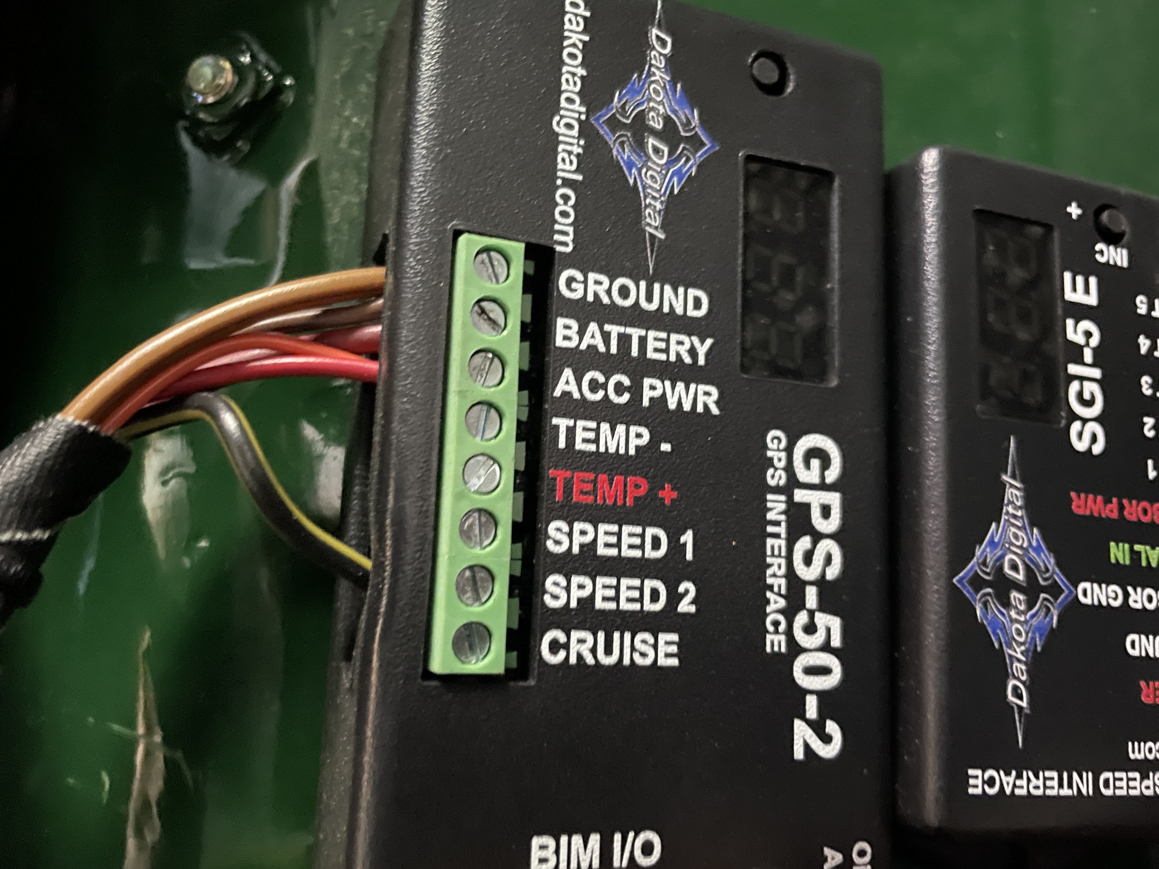

Chris @Biggles - I have a later 911 electric speedometer and I went with Dakota Instruments digital GPS speedometer unit. I have been using it since my car got back on the road about 7 years ago. I hope this helps. (IMG:style_emoticons/default/beerchug.gif)

QUOTE(Cairo94507 @ Feb 18 2026, 09:31 AM) *
Michael - Is that 2 units or 1. I need to get something for my electric speedo but I don't see the second SG1-5E listed. Just the GPS-50-2

Hi Mark @mepstein - Yeah, 2 units. The 2nd one is a speedometer "interface". Dakota Digital said I needed both to make it work. If you need it, I can look for my paperwork. (IMG:style_emoticons/default/beerchug.gif)
