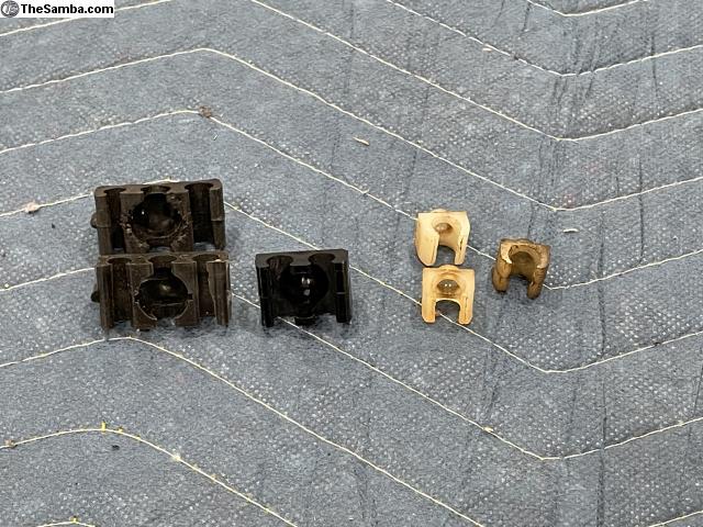

The maybe available at VW sites. Single ignition wire holder. Used one in picture from theSamba

(IMG:style_emoticons/default/agree.gif) Those are available new (I have them listed on my site).
The dual fuel line clips Mark posted an example of, I've not found a replacement source for, although Ive been rat-holing good used ones for a while.
