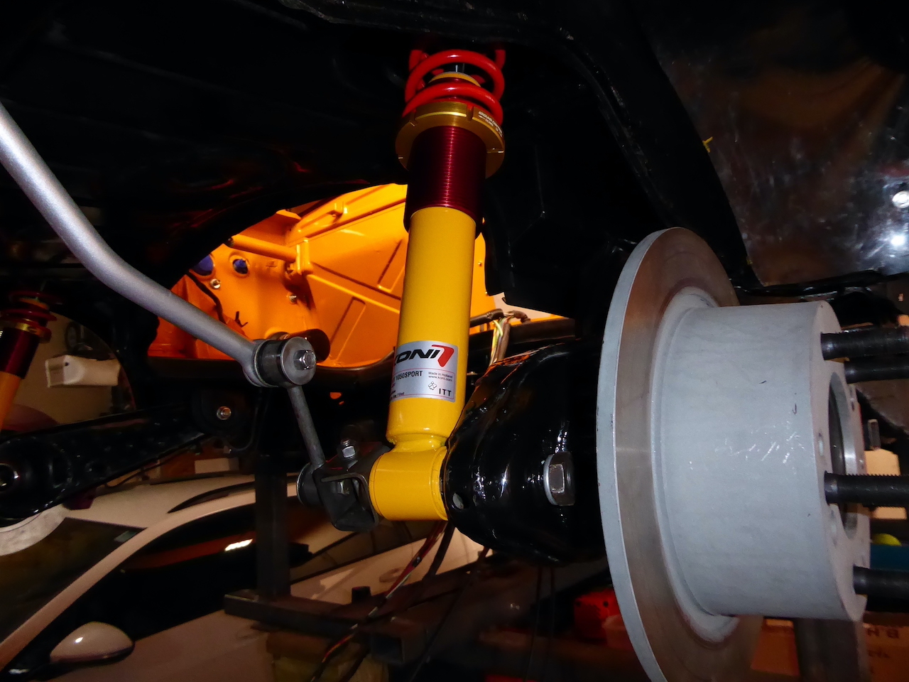

Ground Control, for 914's, adjustable perchs. Great product and people.Attached Image

what you will find with the B6 rears is if you measure the spring perch on the boge units that the dimension falls precisely between two of the many adjustable spring ring perches on the B6. go for the lower one of the two and the car will sit slightly lower and the upper of the two sits slightly higher. adjust front torsion bars accordingly. factory manual says to adjust car so its level front to rear. (i know most folks go nose down - but i have set mine level). have at least 3/4 of a tank of fuel in it when you do that.
reason - i figure when i fill the trunk with stuff and with full fuel tank its going to be nose down slightly anyway.
I started out on 4th from the bottom. I believe I set the clip 5th from the bottom (2nd from the top) after you gave me a mm measurement of where the stock spring perch sat with the 100lb springs I decided to go with. Surprisingly I think my car sits pretty level. Still have a lot of work to do to the quirky little 914 1.8 haha.
(IMG:style_emoticons/default/biggrin.gif) (IMG:style_emoticons/default/beerchug.gif)
mine are set up on 6th ring from bottom. but using orig springs.
i thought about going down to 5th but once i had front of car levelled out it all seem to sit pretty good and i was happy with it. it used to sit slightly lower at back but then again the front was showroom stock USA and was nose up. (IMG:style_emoticons/default/biggrin.gif) (IMG:style_emoticons/default/biggrin.gif) arse dragger style. (IMG:style_emoticons/default/biggrin.gif)
its going to be either 5 or 6 up from bottom.
if i was @StarBear i'd probably start at 5 and see how it pans out.
if you don't like it you can always raise it. not too time consuming to do.
