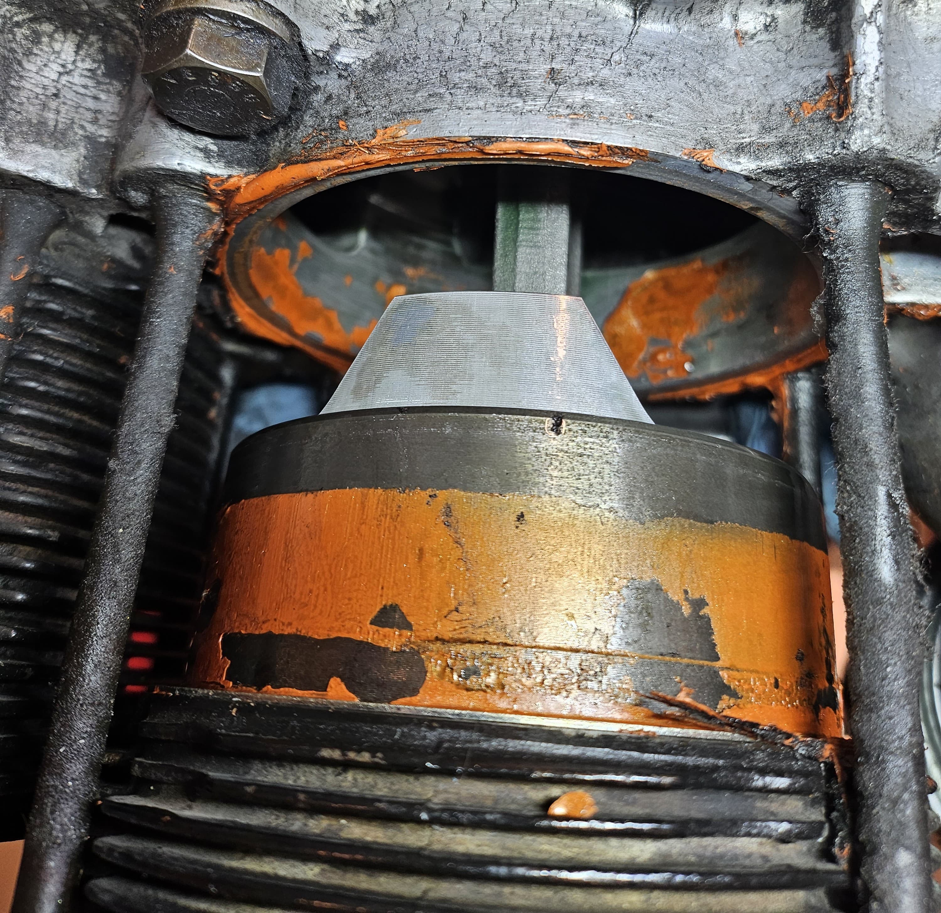

Yes, just bank 2 head is removed, and as you suggested, I have no plans to remove the bank1 head at this time - that will come later this year. But based on what I found tonight (see below), this decision will gnaw away at me until I remove it.
So, I started pulling #4 cylinder to get a look at the wrist pin, and OMG the RTV is everywhere! (see photo) I will obviously try to avoid any falling in the case when cleaning this mess, but I will be checking the sump screen after I run the engine for a short time to see if any fell in.
Regarding the wrist pins - I see snap-rings on the ends, so yes they are floating.
