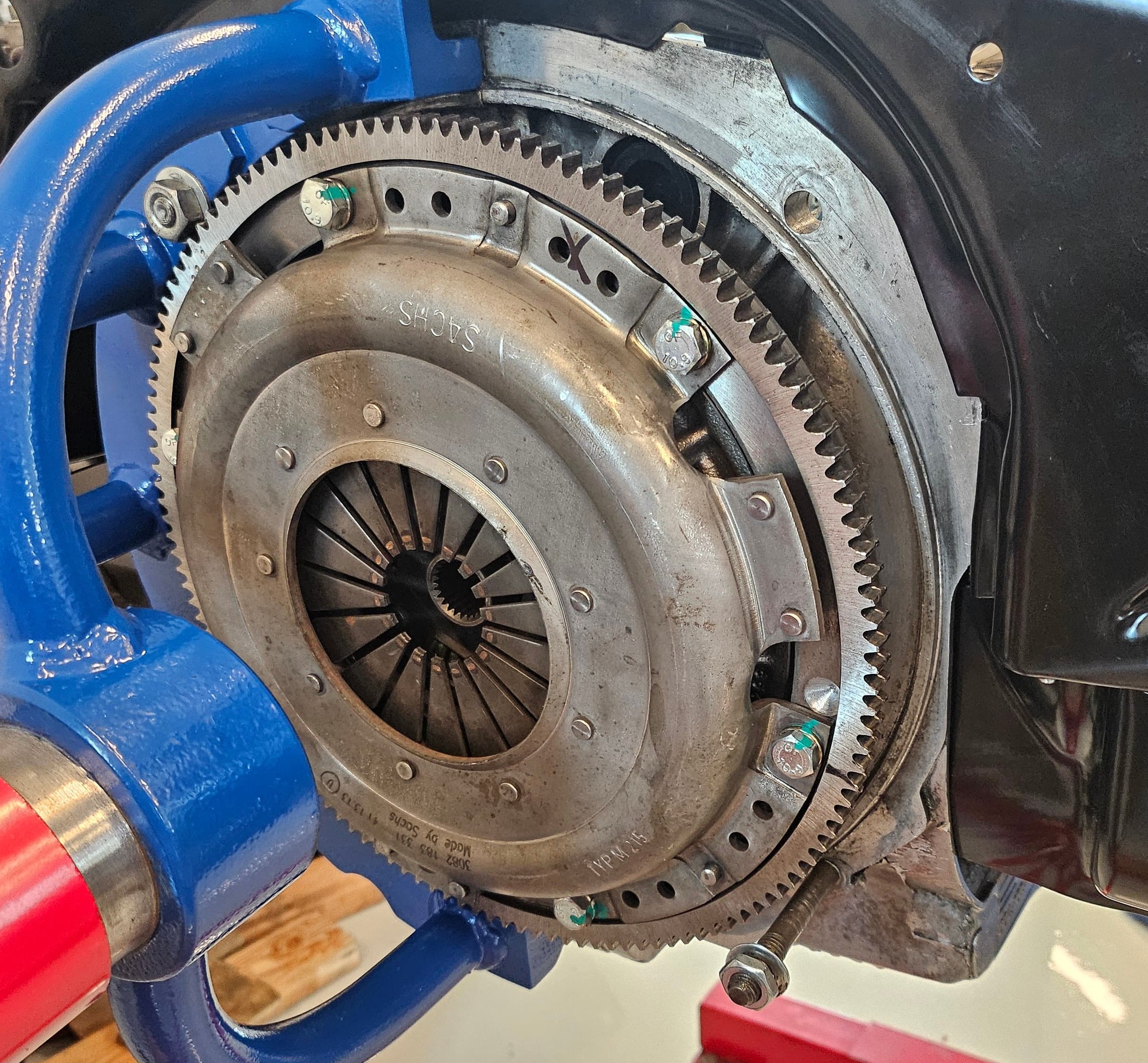

frank_c
post Mar 4 2026, 04:41 PM
Post #25
Posts: 83
Joined: 29-December 24
From: Austin, TX
Member No.: 28,542
Thanks guys. I went with oil on the shims, Red Line Assembly Lube on the seal lip, and a little blue Loctite on the new flywheel bolts (with new locking plate). Posting a photo for closure (IMG:style_emoticons/default/smile.gif).
I'll post my experience with using the GoWesty tool a bit later - I have a goal to get the engine and transmission back together and ready to go back in the car by EOD.
