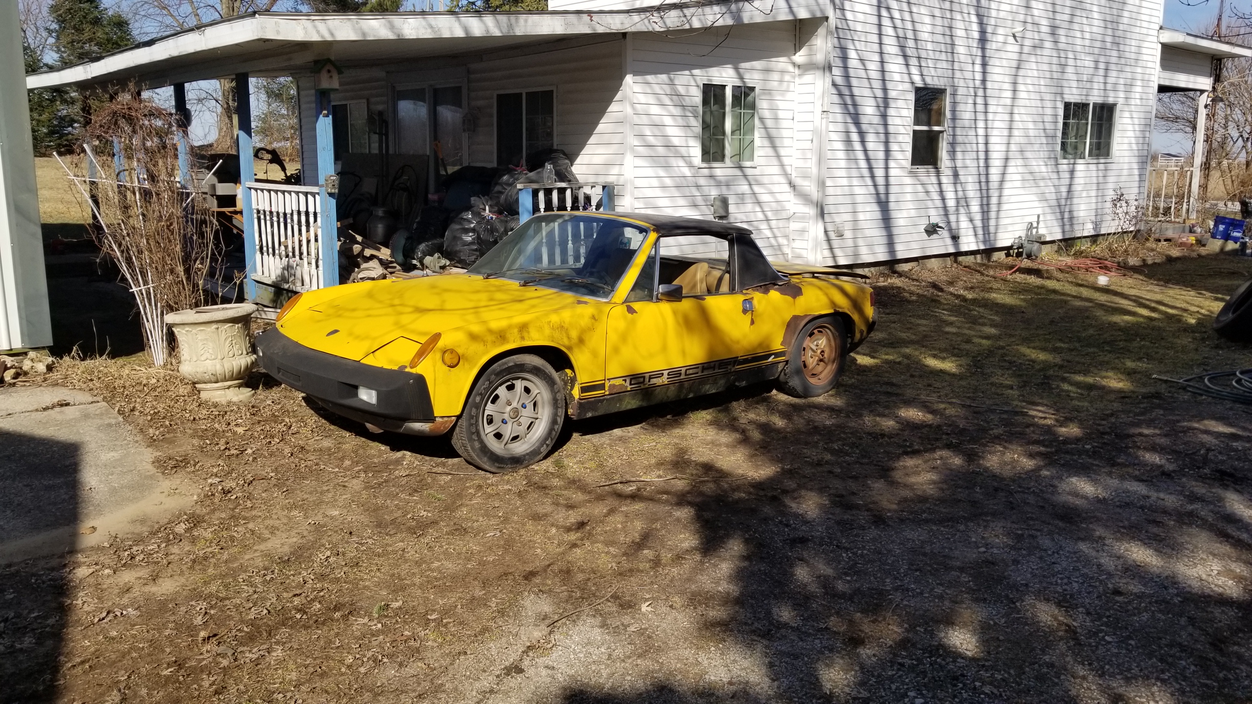

Hi,bought this parts car last weekend,it's a1976 2.0lt car. Can't get the front trunk to open. The release works as it should but won't pop the hood. Any ideas?Attached Image

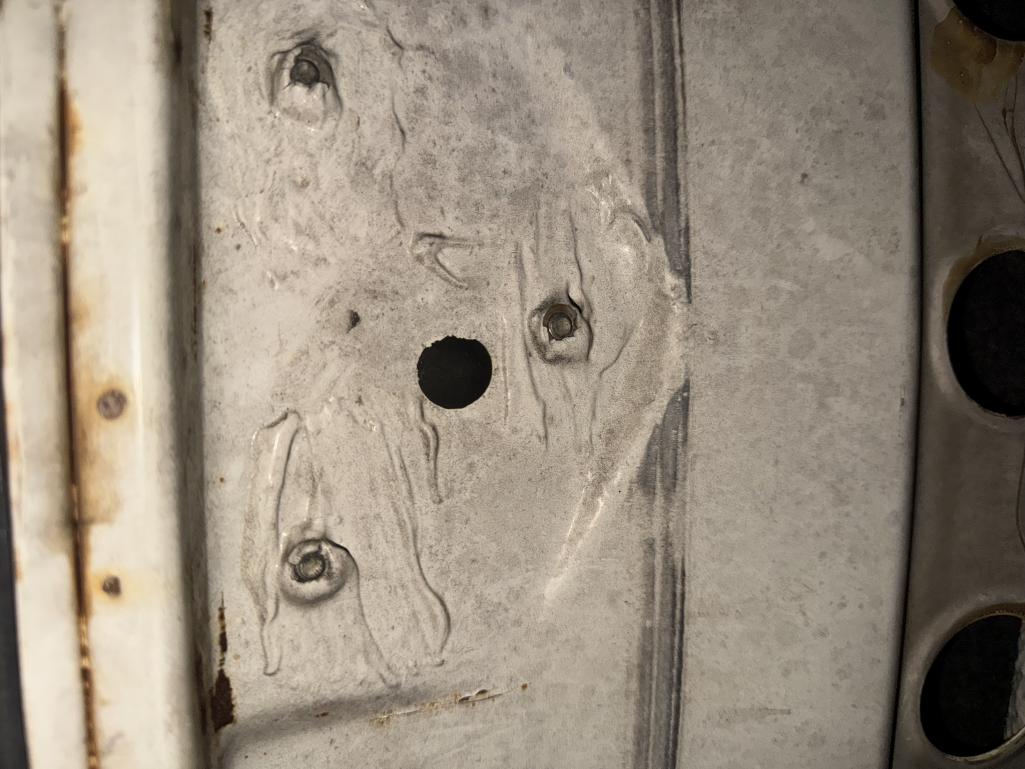

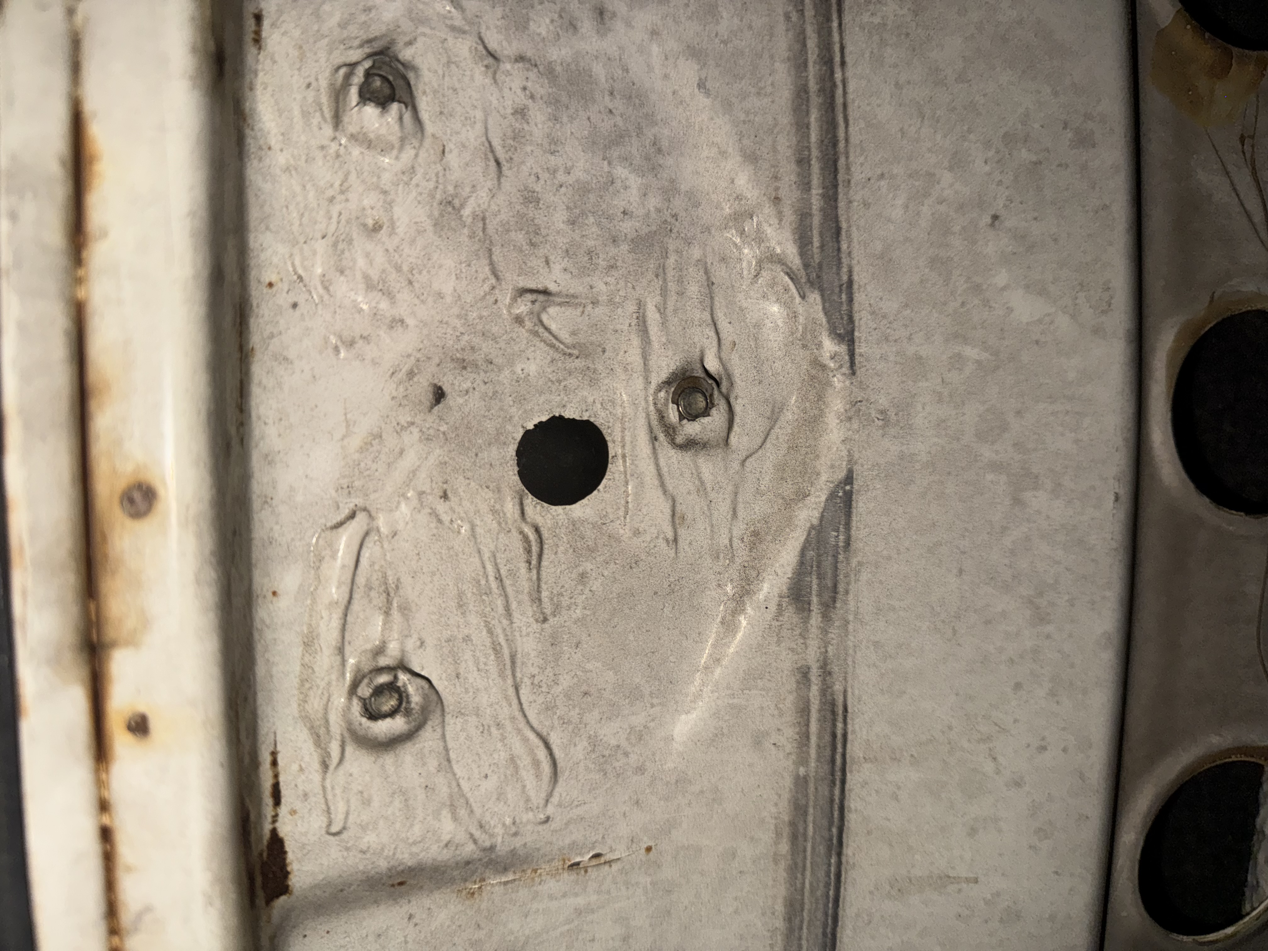

Looks like this.
