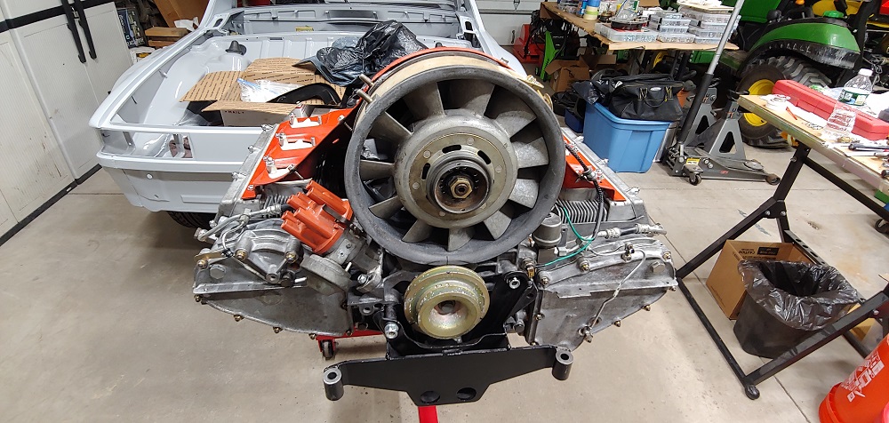

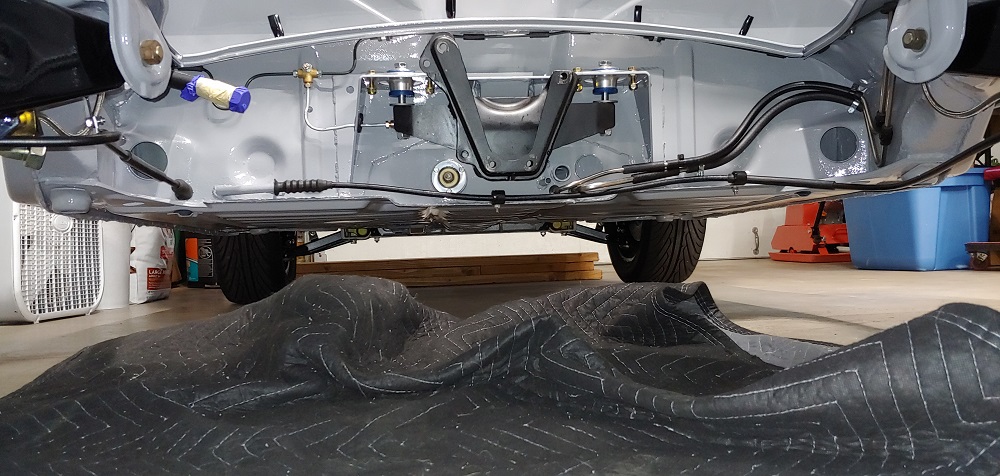

QUOTE(beltwerks @ Mar 9 2026, 01:19 AM) *
I am trying to gather the parts needed to install a 2.4S engine into my 914 restoration project. I have seen the various mounts that need to be welded to the firewall, but i'm yet to see a picture of the item that is fixed to the 911 engine. Does anyone have a picture or a link to a thread that might educate me further.? I assume the 911 item i removed from the case is 911 specific.?
Many thanks in advance
Dave
There's a few different styles. Here's a few links to view. I like the OEM copy vs the double mount version. My brother went with the double style mount on his 6 build. It was a little bit of a pain to get the motor hung and that's with two people. With the OEM mount I can install the engine by myself.

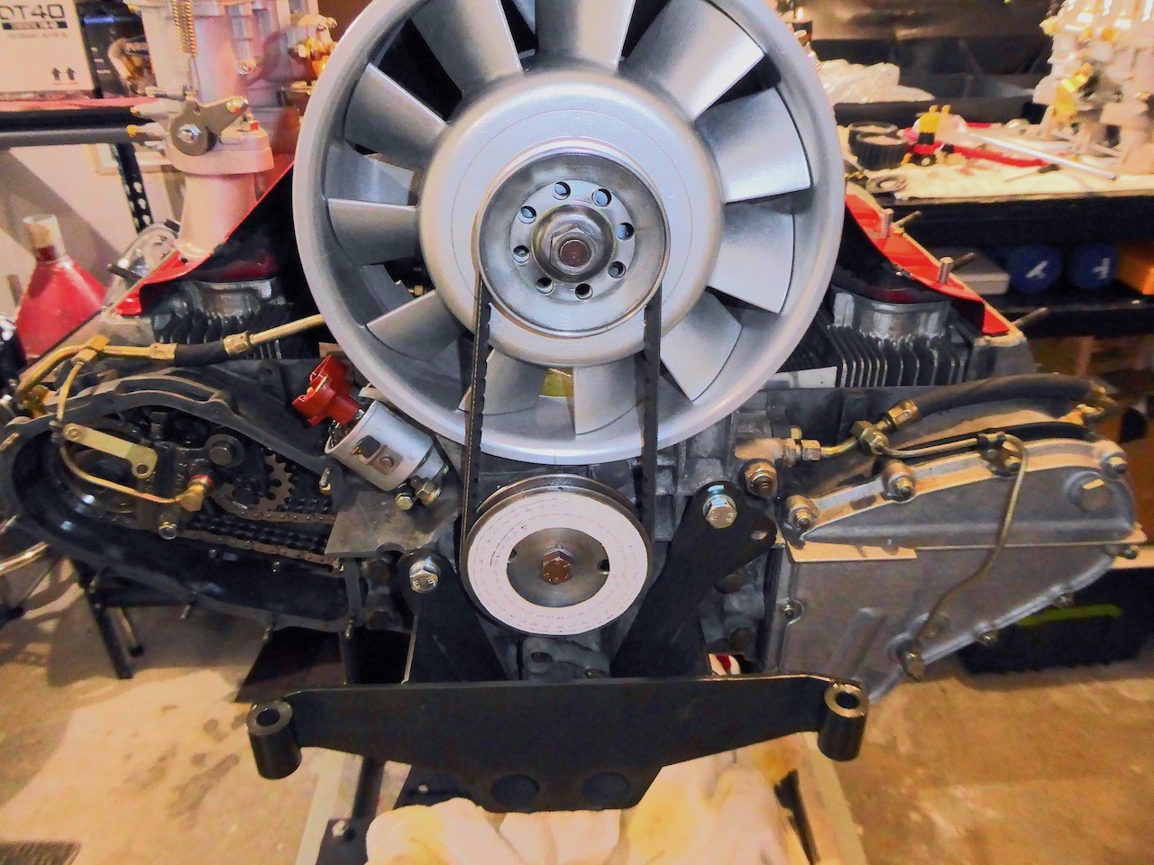

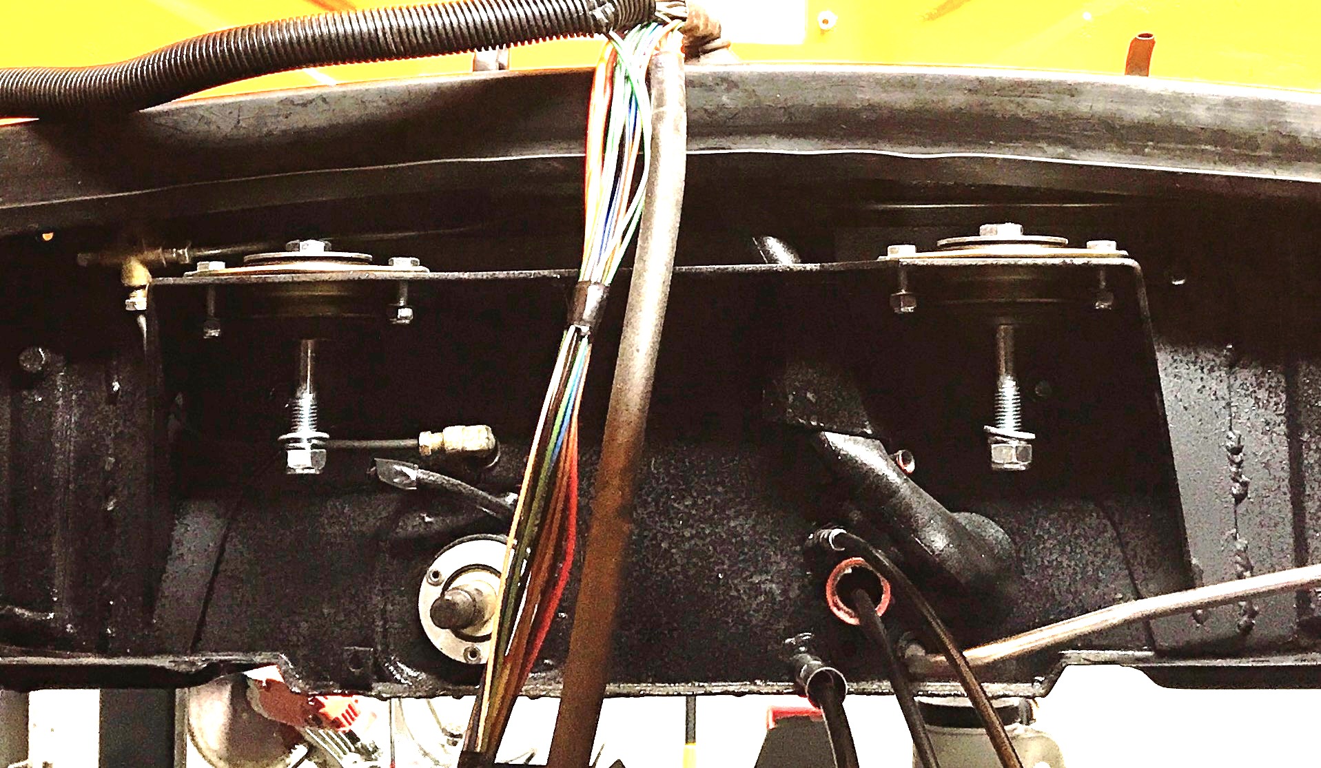

post Mar 9 2026, 06:03 AM
Posts: 1,742
Joined: 11-November 11
From: Merrimac, WI
Member No.: 13,770
This is mine Dave, bolted and welded to fire wall. And bolts onto front of engine. MarkAttached Image Attached Image
