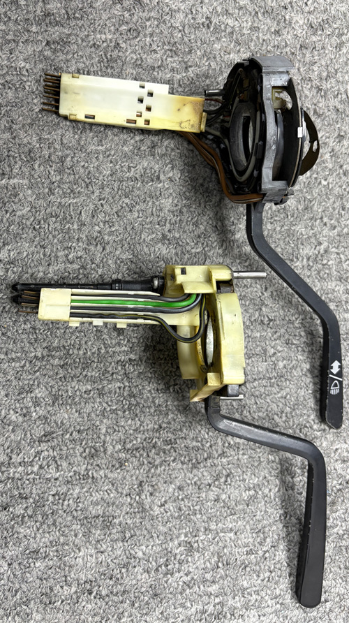

I need to replace the turn signal and wiper switch on my 1975 car.
Can someone tell me which version of switch and where I should buy?
Below is a picture of my current switch. Tks.

Wiper switches rarely fail. Make sure you get the correct pin switch. 4 pin standard, 5 pin for intermittent wipers. Turn signal switch is 72-79 Beetle.
Do you think this will work ?
Tks.
https://www.ebay.com/itm/222900836739?chn=p...SIaAvLKEALw_wcB
