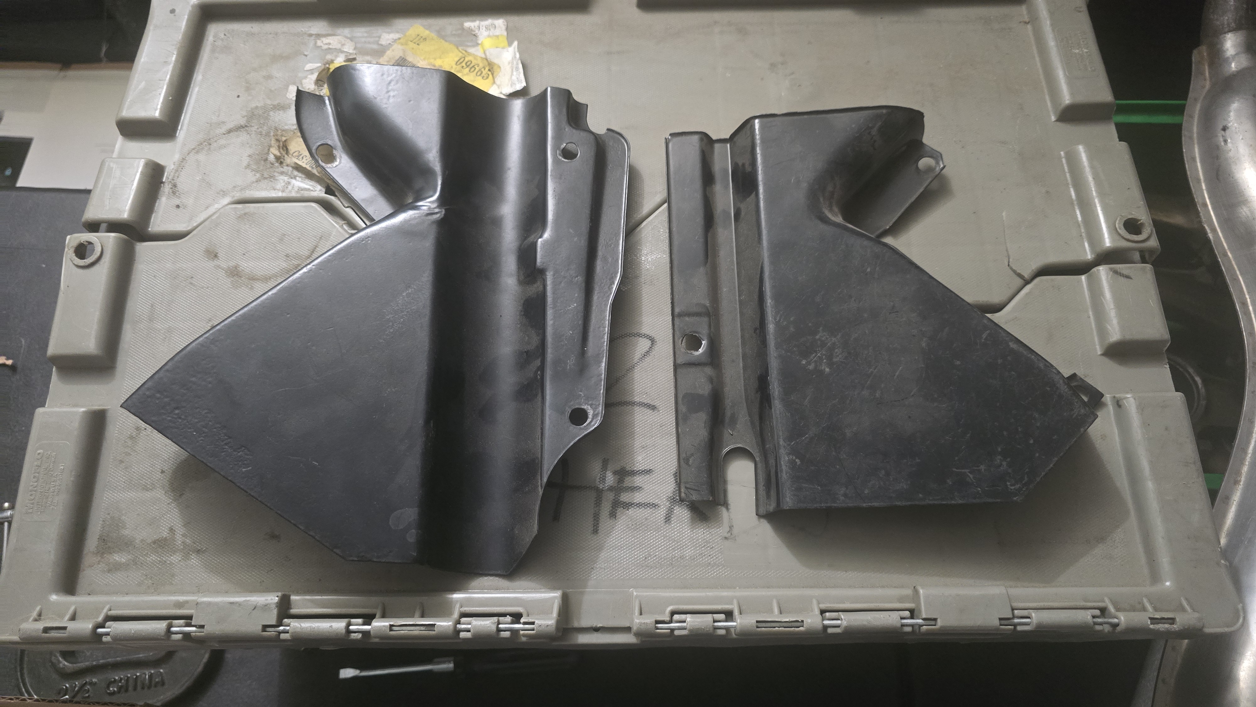

Does anyone have a pic or p/n of the engine tin(s) that are fit to the underside of a 2.0 with Dansk SS heat exchangers? I have a couple pieces of such tin in my parts assortment, but nothing seems to fit.
I have been running without these for the past couple years and after cleaning up some misc repairs noticed they are missing. Could be why I see 220 F when cruising in the summer months?

thank you, I have the one on the left in your pic, but cannot see how this can attach to either the case or heat exchangers

I wonder if that isn’t for the early transmission. I have the same and it doesn’t fit the side shift. I’m convinced they are different.

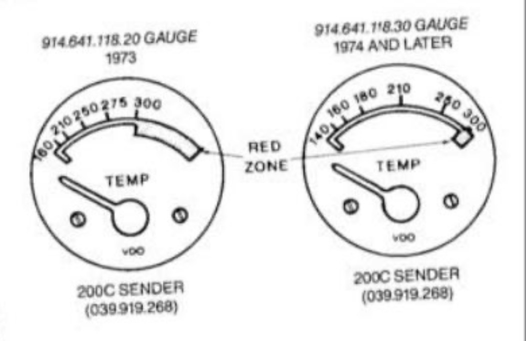

Even 250F isn’t a problem. If in doubt of this let’s review that the 914 and 911 temp gauge calibrations from Porsche don’t get into the red until 300F. Granted you don’t want to run 300F continuous but 300F is not going to completely destroy Dino oil. Synthetic oil laughs at 300F.
Per gauge calibrations it should be obvious the engine is normally expected to operate in the 180F - 250F temp range.
