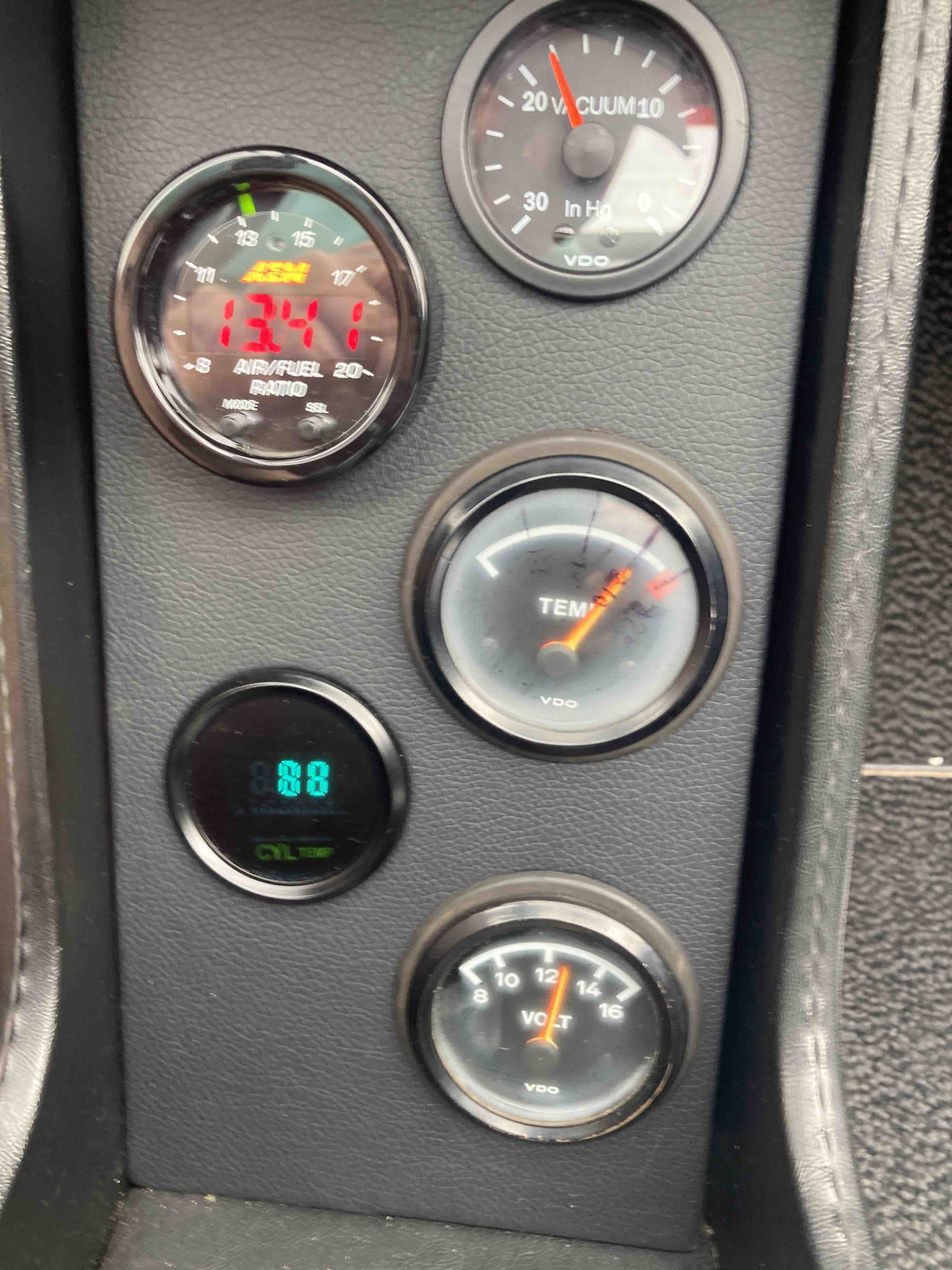

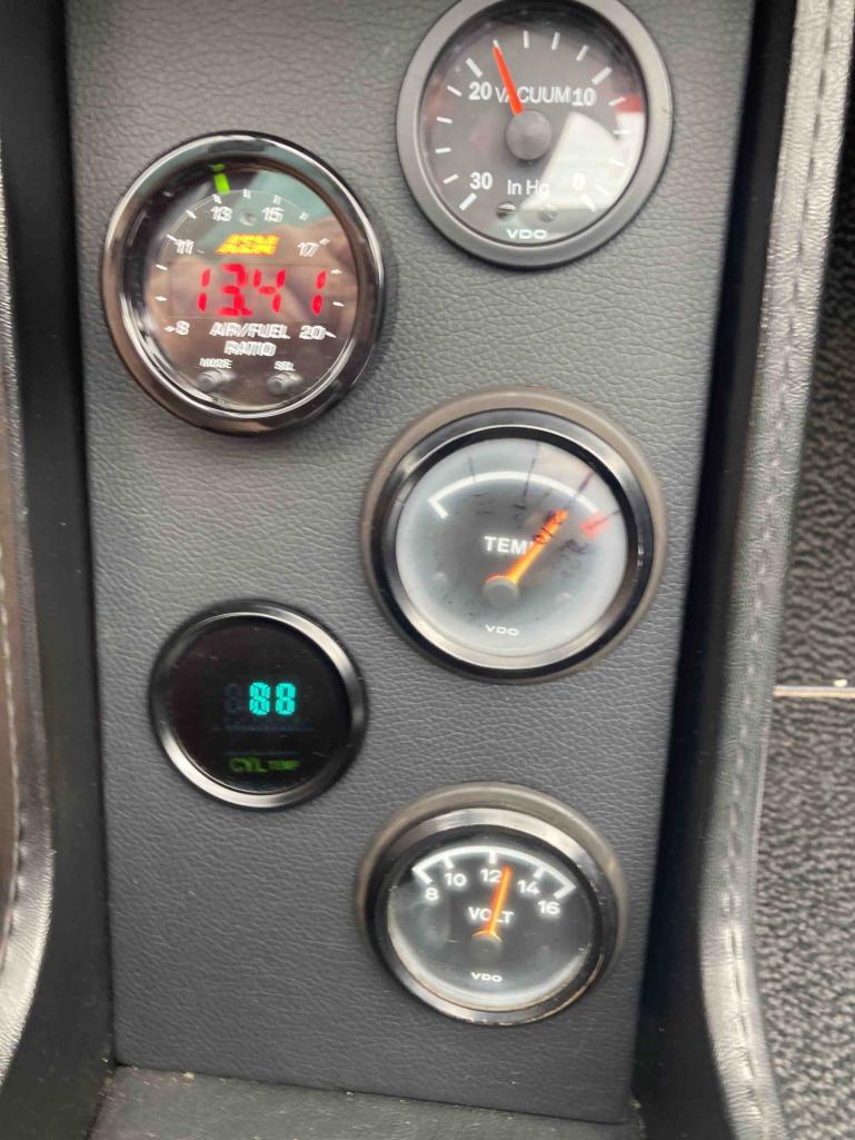

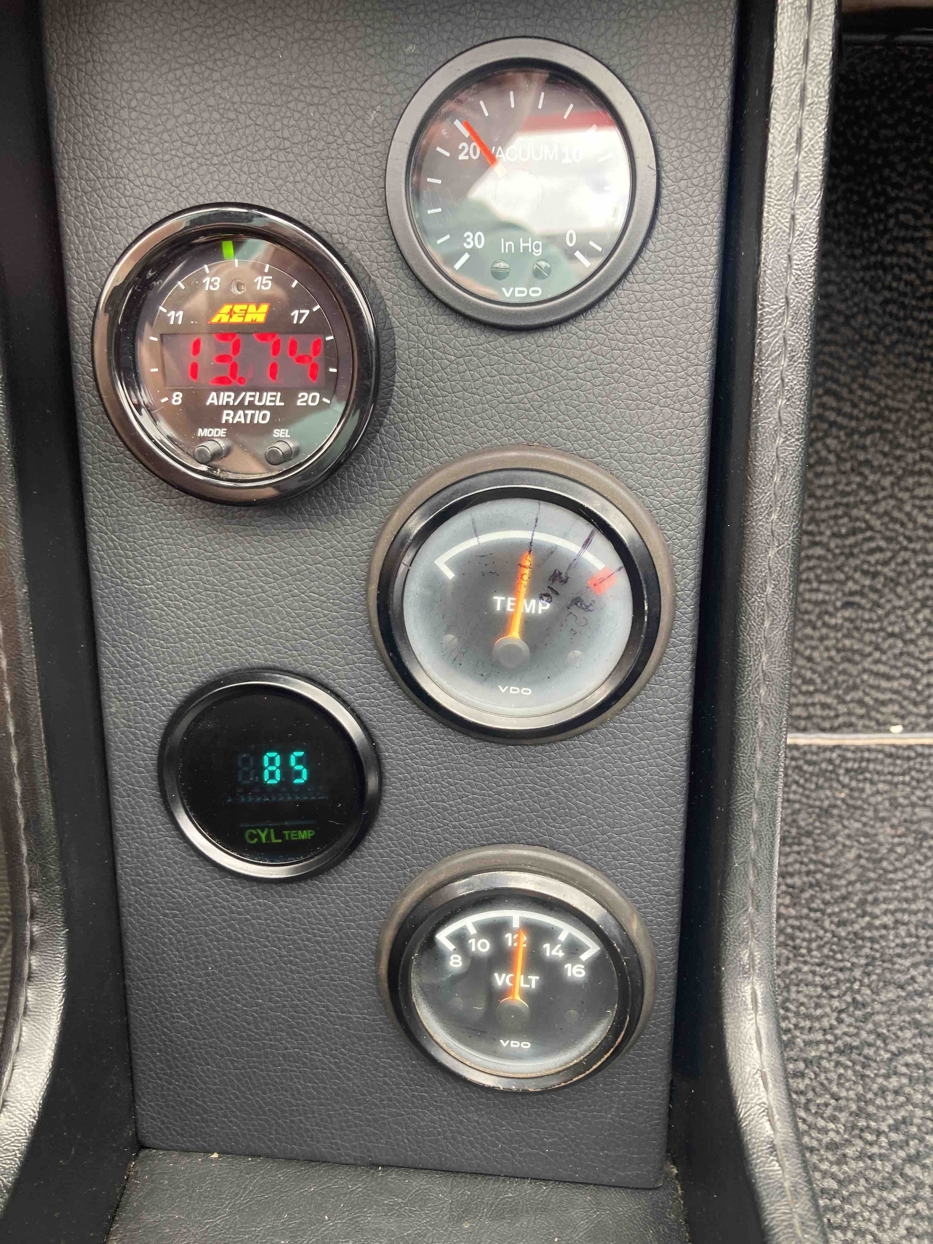

Well I finally was able to get my AFR gauge installed and was hoping something as to lean would be the issue but I don't think so.
I also talked to Dakota digital about confusion from the readings . I ended up sending them my gauge and sender to be checked and they returned it saying there is nothing wrong with it , added something about the internal temperature (?) effects the gauge if you let it warm up without no temperature change . I reconnected it and made sure the F appeared in display but I still question the readings . I am not a fan of this gauge as it does not show a C/F next to value , you only see this in set up .
I am still running on the hot side so not confident on driving more than 20-30 minutes as the needle on my temperature gauge comes right up to the red box on the gauge .
I also am looking for information on what value of readings I should see at warm/idle. My understanding is I should be looking for ~14.7 % .

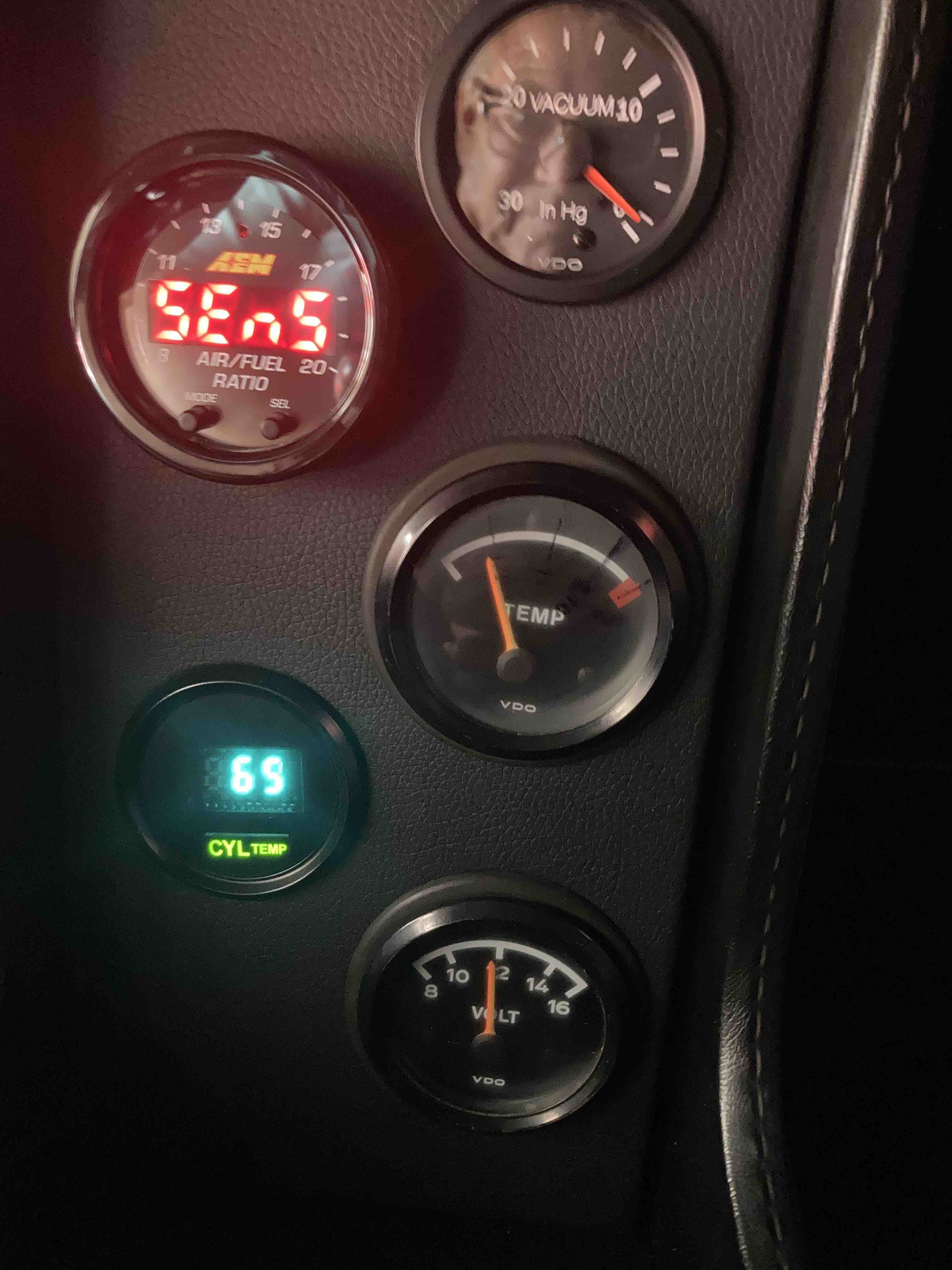

I turned the key on and gauge showed heating and then somewhere around 12.07 % , the CHT showed 69 which was close to ambient temp in the morning . Not sure if this is an normal but my temp gauge moves almost 1/4 of full range when I turn on key (so it seems like I start out high before I start my motor) Car is pulling 18-22 on the vacuum gauge
I have a hard time believing the CHT is only 88F. I know I need to make adjustments to the MPS but I think I need to solve the overheating issue first .

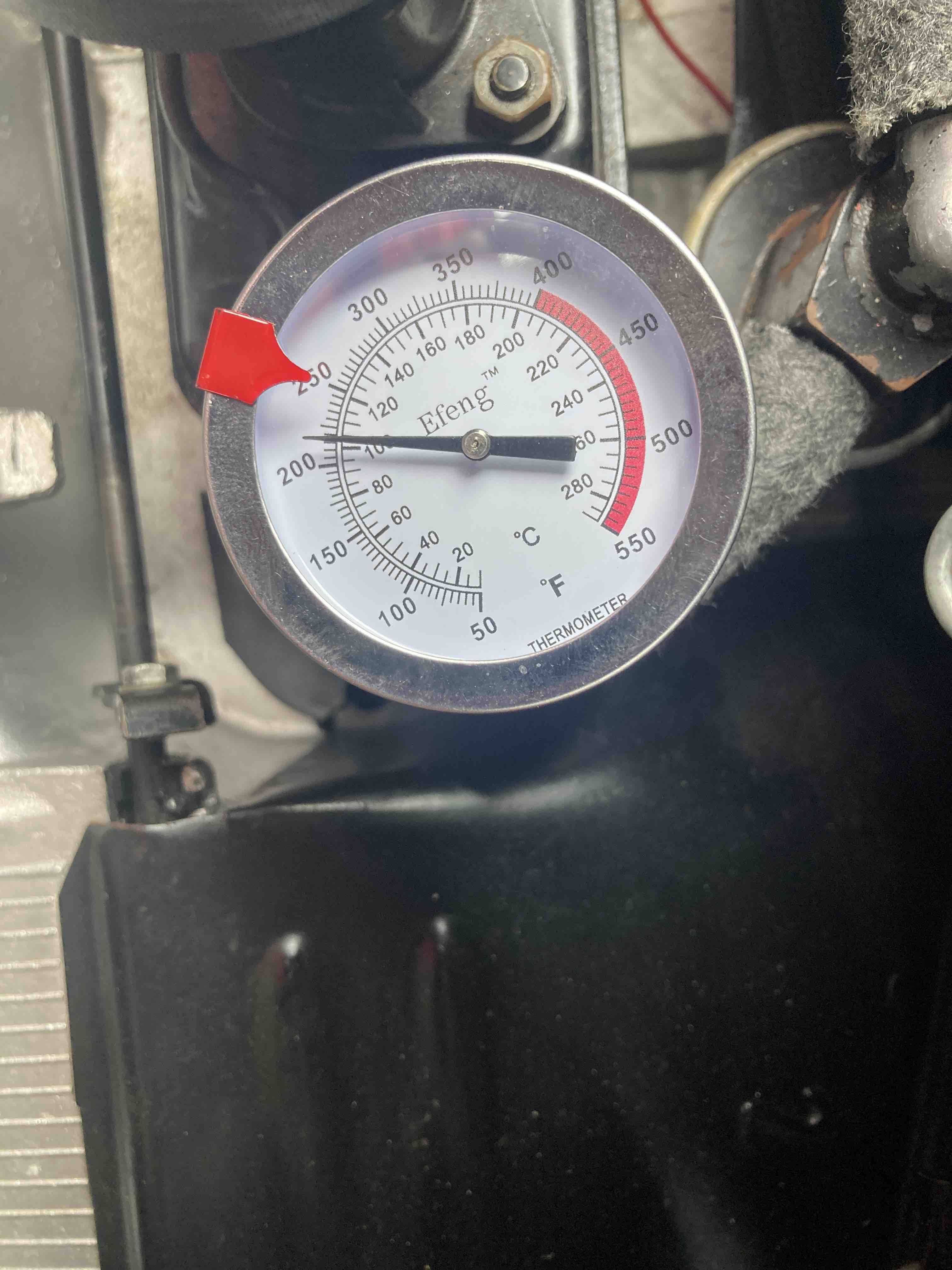

Shows gauges after 26 minutes of driving and the temperature when I stick the turkey fryer thermometer in oil dipstick . When the gauge is getting close to the red I measured ~218 F .
I forgot an important question about the AFR . Should I disconnect the Lambda sensor or is ok to drive around with it installed . Seems like I read somewhere this bad if not actively monitoring the AF ratio .

where is your sensor for the CHT gauge?
Under #3 plug?
Are you sure you're not still in Celsius?
If you're not powering the AFR, you should pull the sensor and plug the bung. It's hard on the sensor.

Dakota Digital instructions to get from C to F display on that gauge:
To change your Cylinder Head Temperature (CHT) gauge from Celsius to Fahrenheit, follow the setup mode using the gauge's sensor wires.
Disconnect the red and yellow sensor wires from the temperature sender, and ensure the headlights are off.
Turn your ignition key to the ON position. The gauge will display "SEt".Briefly touch the red and yellow sensor wires together. The screen will flash "F" or "C".
Momentarily touch the wires together again to toggle between F or C.
Once "F" is displayed, keep the wires touching together for about 2 seconds to save the selection.
The gauge will display "HI" to move into warning settings.
Simply release the wires and turn the key OFF to exit the setup routine.
Also - confirming you have the connections between the gauge and the sender correctly oriented. I had them reversed on my initial install and was getting odd reading - similar to yours - maybe that's it for you.

Did you say your oil temp gauge jumps a quarter way just from turning the key on?
If the ring is not seated correctly it will read way off on the cool side.
Your afr looks fine so far.
How soon after starting the engine were you getting 212 oil on the meat thermometer?

Yes , as soon as I turn the key on. You can see how much in the first photo where vacuum is zero . This makes me wonder if the gauge is malfunctioning and maybe I do not have a problem .
I assume you're talking about the spark plug ring sensor being loose . This brings up a possible problem .My heads have slightly recessed openings for the plugs so getting the ring correctly seated may be an issue . I really need to put a bit of tongue to the wrench when installing the plug and do not want to strip the threads out so I could try to tighten down a bit more .
Time stamps on the photos show 68 to 212F in approximately 26 minutes . Doesn't seem right to me ?
I have pulled the temperature sender and verified its a VDO 200C sensor and tested it in 212F water while connected to the cars gauge but I cannot find that photo now .
