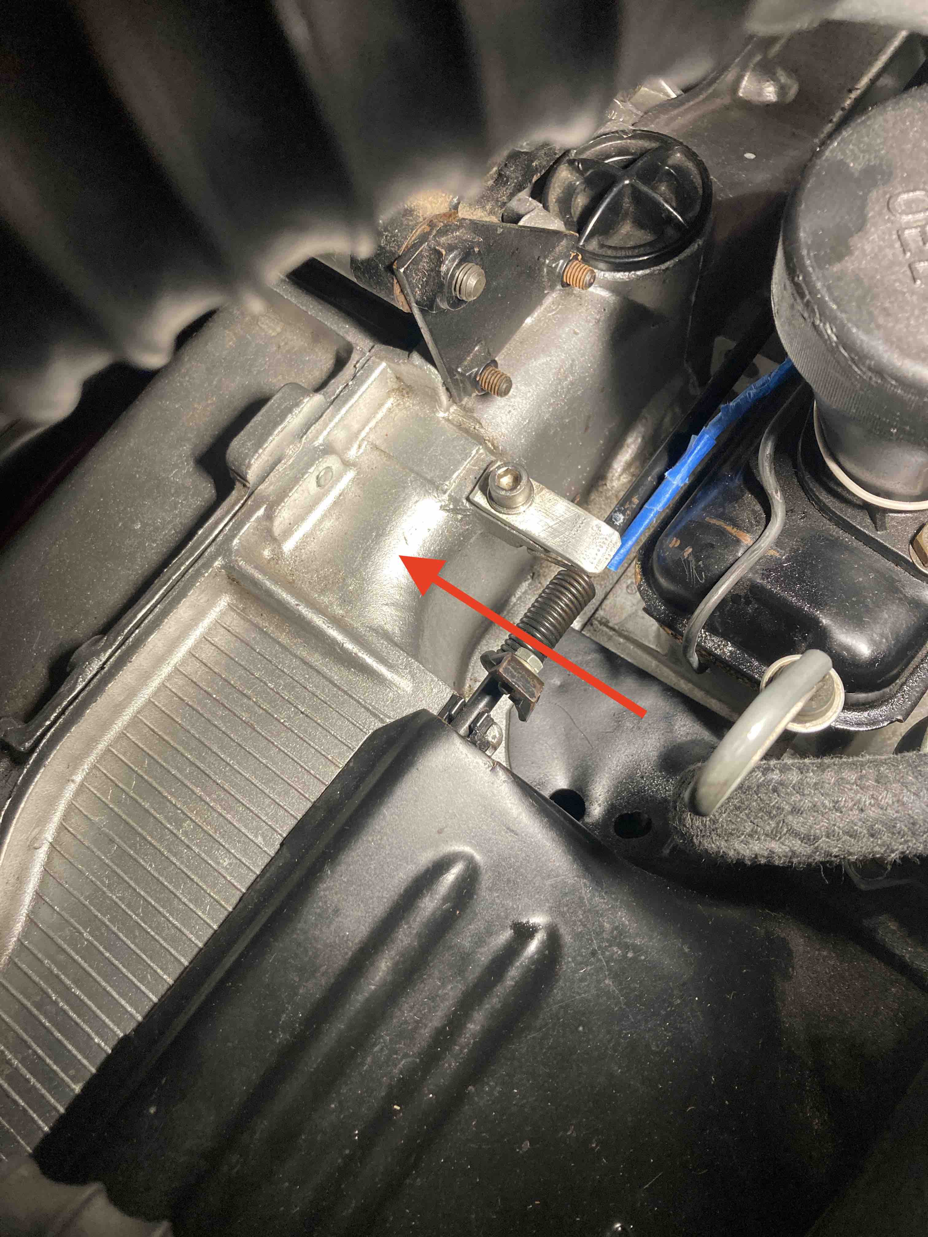

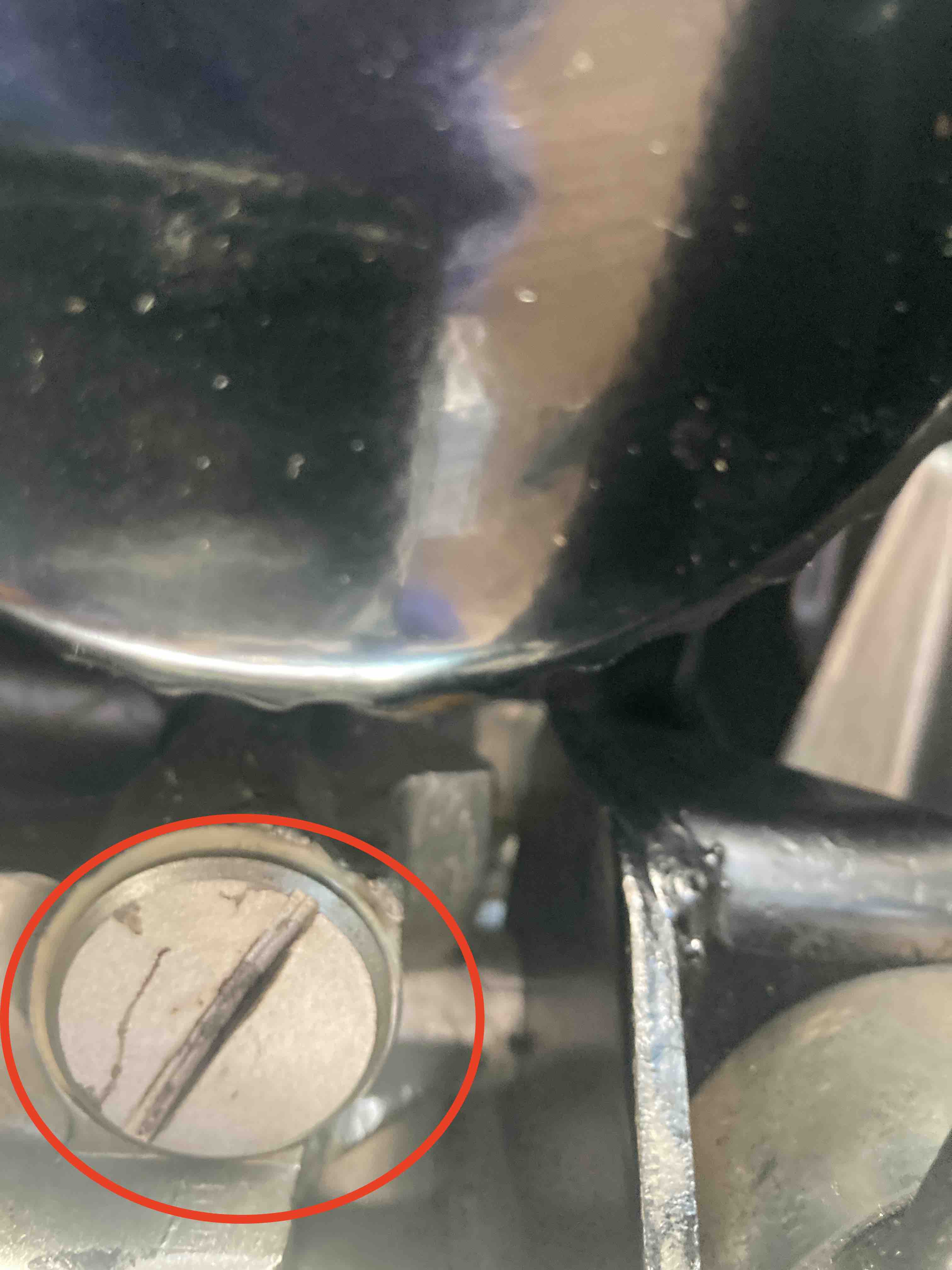

Thank you for the comments James . I will go ahead and order Chris's relief valve and report back after installed . My cooling flaps thermo is bad but I am sure I have the flaps forced open to max airflow as shown in photo, also I I did not replace my original oil cooler ,I flushed it and saw no leaks and good flow. Is the oil pressure relief valve behind the large screw I have circled? I will recheck my timing and adjust the ECU and see if this helps .

That's the spot for the bypass. Big flat head is a good idea.

Yes, oil pressure relief is under the big screw you have circled. Take out that plug and the spring and piston should just drop right out.

The only other thing that comes to mind is the orientation/position of the passenger side air diverter flap. As was mentioned the angle of your cooling flap linkage does not appear to be in the "full hot" position despite having the cable disconnected. If something is prohibiting the flap over the oil cooler from sealing on the tin then air is not being forced over the cooler properly.

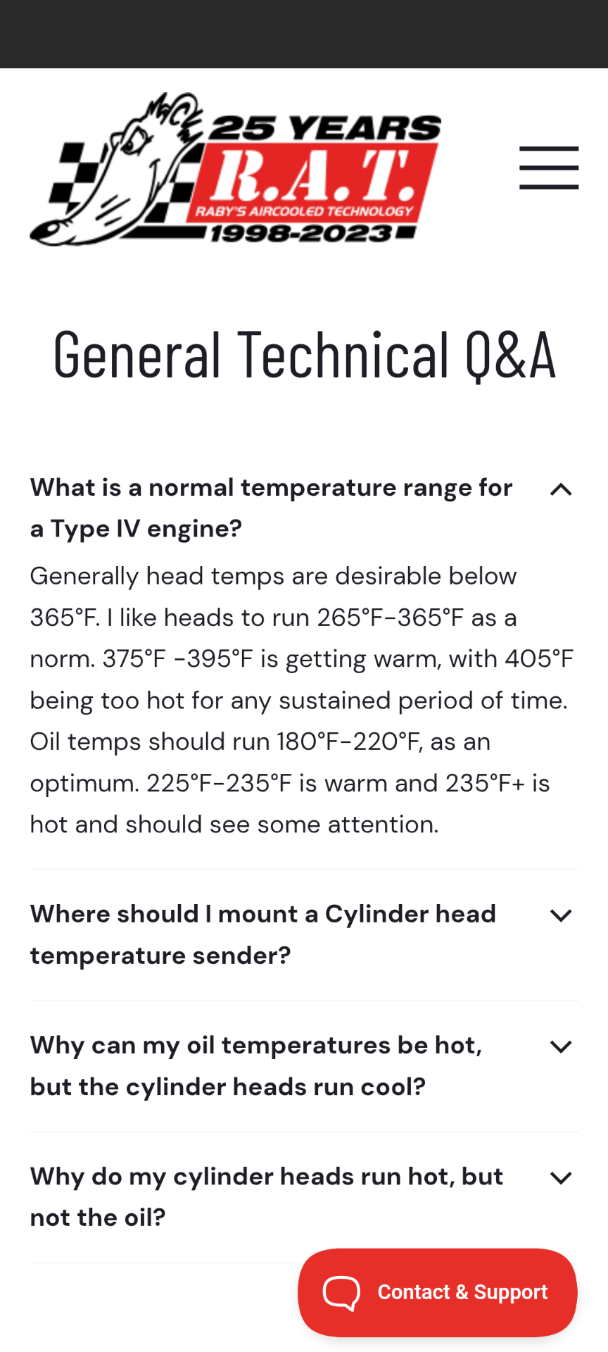

QUOTE(Geezer914 @ May 31 2026, 03:44 PM) *
I run a 2056 with Ljet, biral cylinders, remote oil cooler, 13.5 AFR, oil pressure is 45lbs T 3400 rpm, with Brad Penn 20/50w oil. Cylinder head temps get to 95°C and the oil temp is 200° after a 45 minute to an hour on an 85° day.
Your heads are way too cold. Are you sure you have the cht set correctly? How could your oil even reach 200 with heads that cold?
Of course altered compression ratios probably change some things but here is raby's stuff on head temp and this matches what I have read in the books on type 4.
