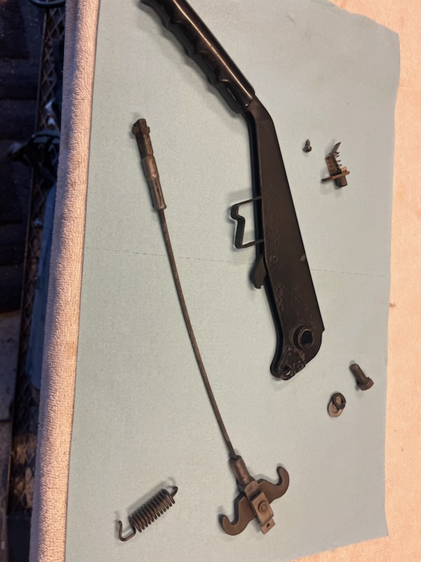

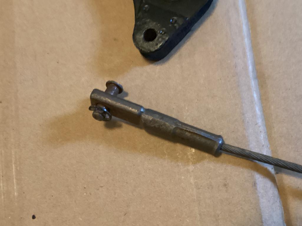

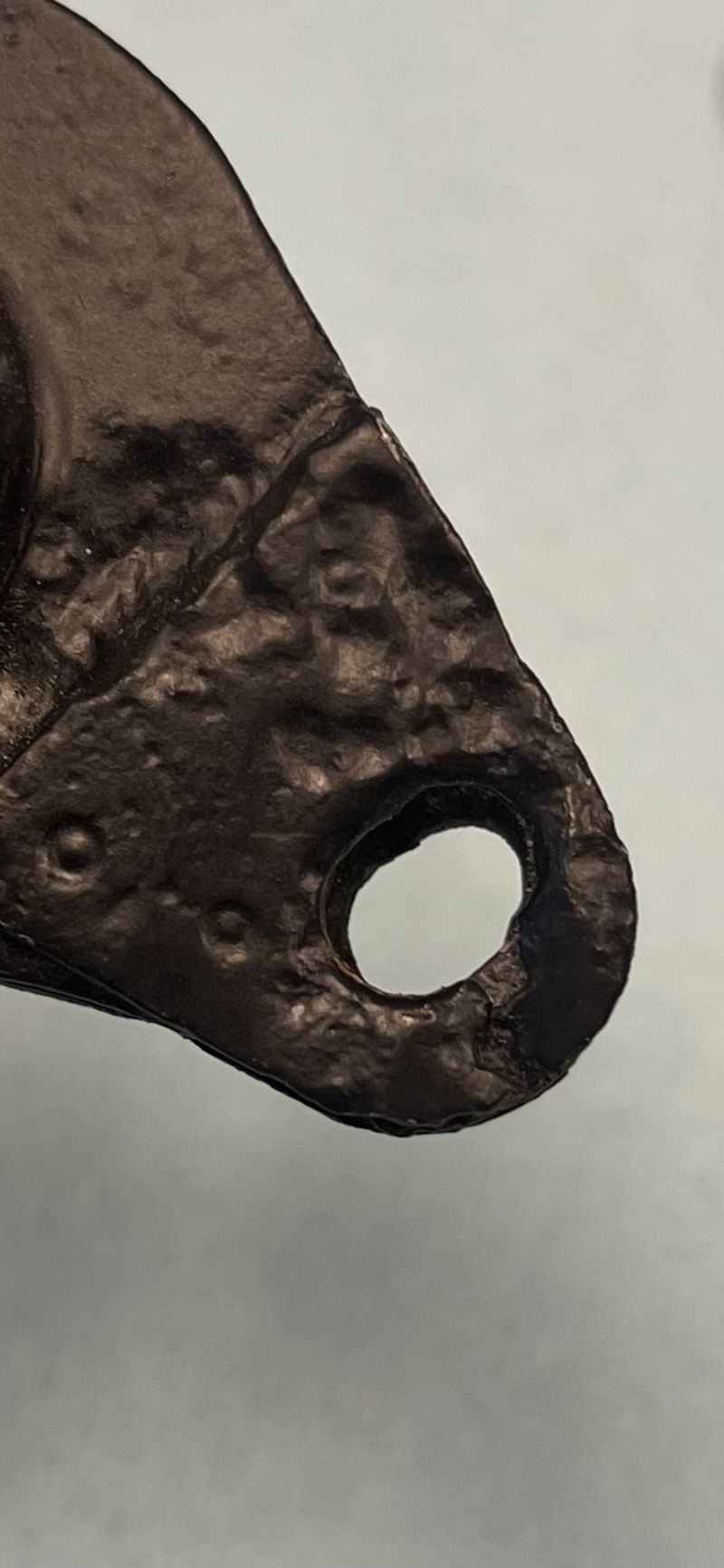

I am refurbishing the handbrake and im wondering how the handbrake itself connects to the cable. Mine was a bit rusted, but it looks like the pin thats in there is rusted together? or is it part of the cable? in any event, i was wondering if i need to drill that out and use a clevis pin with cotter. the end with the equalizer is in great condition. Just wondering what the mainstream fix is for this.
Thanks for any help!

thanks for the quick reply...would you happen to know if that is a porsche part for sale some where? it looks like i need to get out the rusted in clevis and get another one.

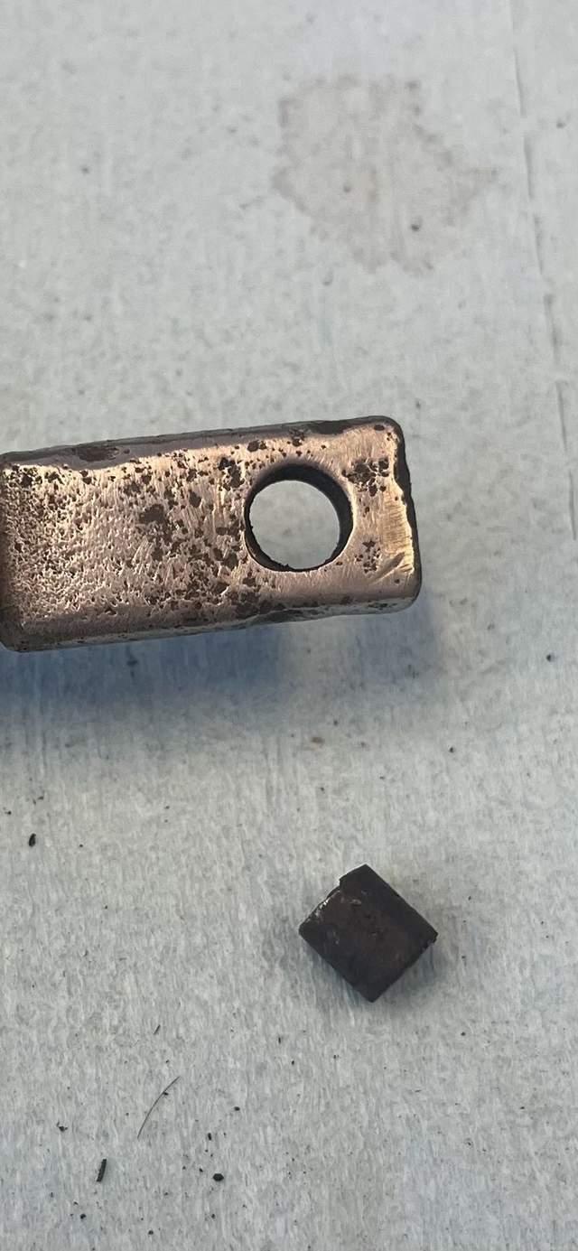

ok...after seeing Garland's post...i ground down my rusty pin and pressed it out. looks like the diameter of the pin is right at 6mm

and after some digging...it looks like 914 Rubber has this part:
https://914rubber.com/new-parking-brake-pin...lNV7aDoNb7dPm3b
its described as a "Parking Brake Pin for Yoke Assembly with 5mm E-Clip"
so if the "E-Clip" is 5mm, i would wager that the clevis pin diameter is probably right at 6mm.
im gonna order this. plus, it looks alot like Garland's (IMG:style_emoticons/default/smile.gif)
