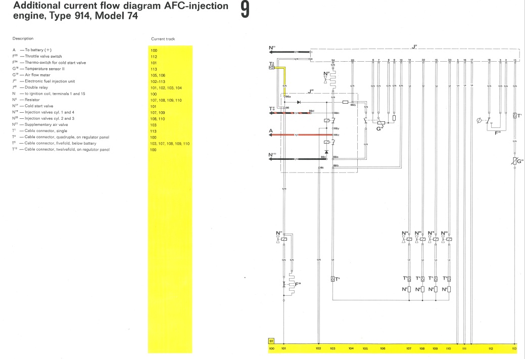

After a thorough investigation, it appears that the injectors are not getting ground to fire properly on my 1974 1.8L. Maybe it's an air flow sensor issue but not sure. All the other wiring seems to be okay. I would appreciate any thoughts from the knowledgeable folks on this forum. Thank you.

Check the schematic for these circuits. LJet injectors do not ground directly, they go through the resistor pack (look for broken wires) and then to the double relay.

QUOTE(JeffBowlsby @ Mar 21 2026, 08:58 AM) *
@JeffBowlsby
Thanks Jeff for taking the time to send the schematic and your thoughts. I've read many of your articles since I bought this car last Spring. I will print this out and review with my mechanic on Monday and get back to you. We've checked all the wiring, AFM plug and flap, vacuum lines, dual relay, dwell, coil but can't seem to get the injectors to ground and per your article they don't. It has normal fuel pressure and will start briefly at times but won't continue running. I will order a new resistor pack as mine might be the problem. Thanks Jeff.

QUOTE(nmkimosabe @ Mar 21 2026, 06:25 PM) *
Not trying to start a whole (IMG:style_emoticons/default/stromberg.gif) show but your mechanic should not be guessing and throwing parts at it blindly.
If your injectors are not grounding that ought to be addressed.
The injectors are switched ground via the ECU.
The resistor pack is on the +12v side. The resistor pack has nothing to do with grounding.
Has your mechanic verified power to ECU (pin 10) and grounds to the ECU (pins 5,16,17,35) ?

Also check the o-ring on the oil filler cap. A failure destroys the vacuum, vital for L-jets.
Probably/maybe not the cause, but simple to check and cheap to fix. Sometimes the cork gasket under the oil filler housing fails, too. Again, easy and cheap.
Maltese Falcon
post Apr 1 2026, 12:31 PM
Posts: 5,471
Joined: 14-September 04
From: Mulholland SoCal
Member No.: 2,755
Check your main grounds around the engine bay/ and the ground strap from Transaxle top-to-stud just under your trunk. Cleanliness + tightness at grounds are your buddies.
