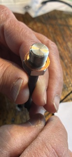

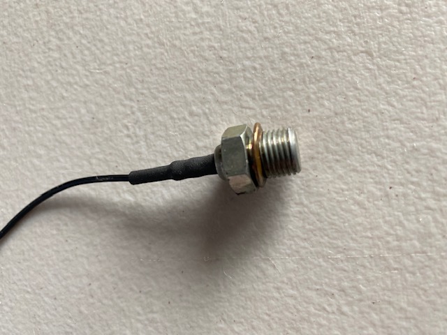

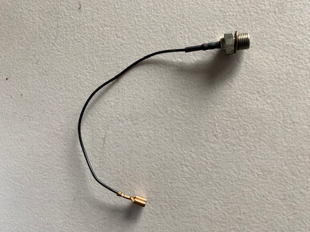

nmkimosabe   Well 2 weeks and learning a lot about L-jet inject...   Apr 7 2026, 02:38 PM
TRP   great job at debugging the issue! I have so m...   Apr 7 2026, 03:00 PM
Rob-O   The head sensor isn’t terribly difficult. Take ...   Apr 8 2026, 04:16 AM
nmkimosabe   The head sensor isn’t terribly difficult. Take...   Apr 8 2026, 08:24 AM
Rob-O   For gaskets it depends. The injectors could be le...   Apr 9 2026, 06:25 AM
Geezer914   If it's running like crap, it may be a vacuum ...   Apr 9 2026, 09:12 AM

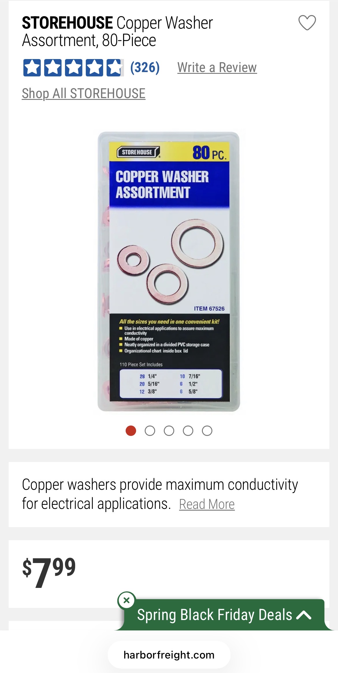

nmkimosabe   Can someone please tell me if I should use a crush...   Apr 11 2026, 02:22 PM
fiacra   Can someone please tell me if I should use a crus...   Apr 11 2026, 04:03 PM
nmkimosabe   [quote name='nmkimosabe' post='3252868' date='Apr...   Apr 11 2026, 07:35 PM
nmkimosabe   Can someone please tell me if I should use a cru...   Apr 12 2026, 08:43 AM

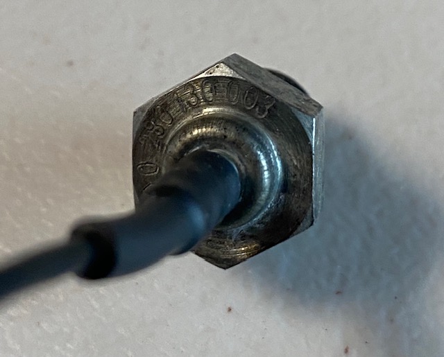

fiacra   @[url=http://www.914world.com/bbs2/index.php?showu...   Apr 12 2026, 11:39 AM
nmkimosabe   @fiacra My part # appears to be 032.096.041 which...   Apr 12 2026, 01:06 PM
fiacra   [b]@[url=http://www.914world.com/bbs2/index.php?s...   Apr 12 2026, 03:06 PM
nmkimosabe   [b]@[url=http://www.914world.com/bbs2/index.php?...   Apr 12 2026, 03:55 PM
Superhawk996   RE: L-Jet Injectors Aren't Getting Ground   Apr 12 2026, 02:30 PM
Rob-O   They’re available from Porsche again, I believe.   Apr 12 2026, 03:36 PM
