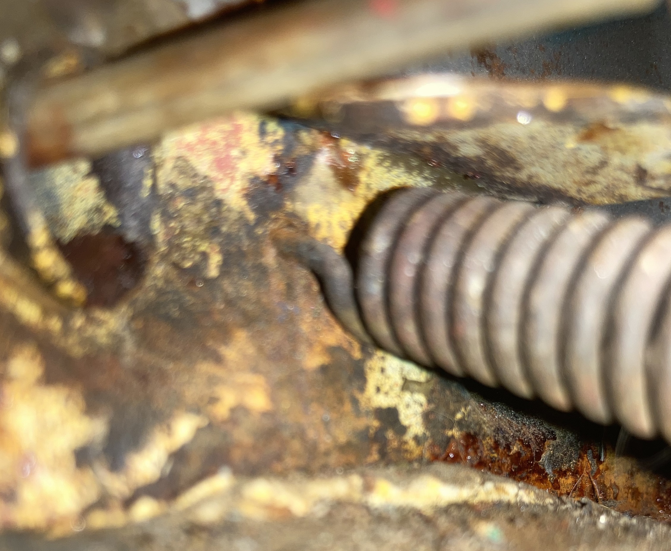

all,
i made some repairs in the area behind the drivers seat at the firewall. Im wondering if anyone has a picture of how the parking brake spring attaches to the firewall? Attached Image

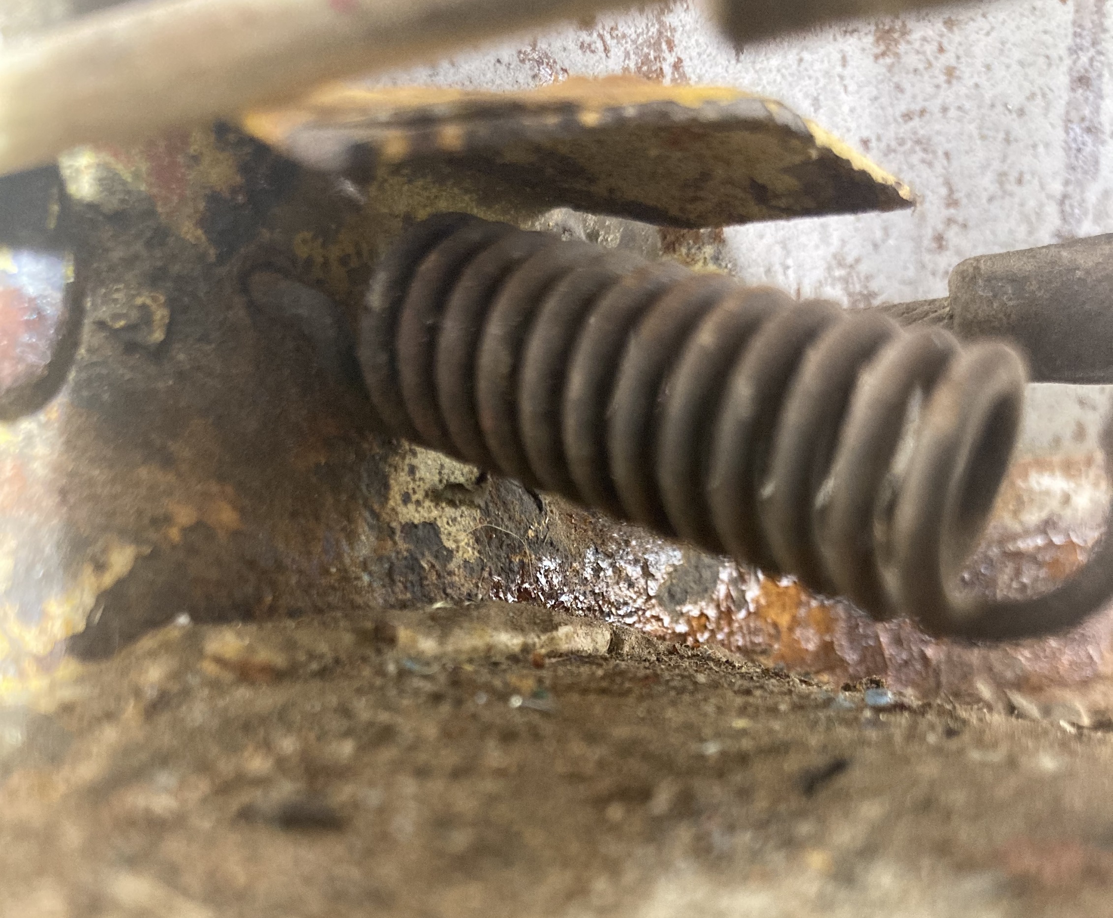

MasterCylinder
post Mar 21 2026, 02:00 PM
Posts: 11
Joined: 5-November 15
From: California
Member No.: 19,335
Not great pictures the tin cover makes it hard to photograph.

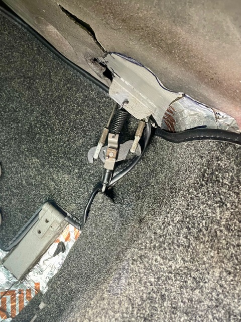

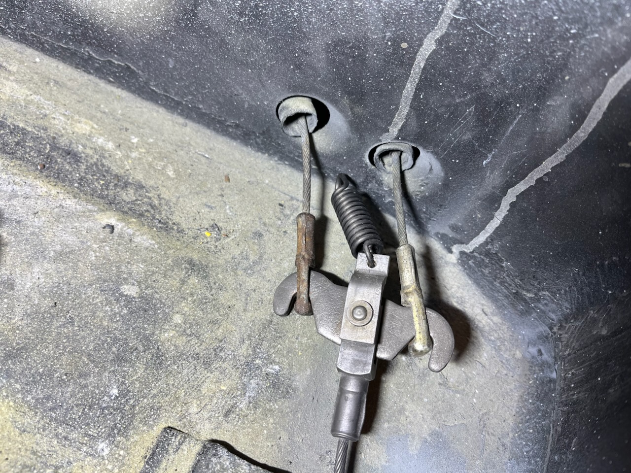

Ishley
post Mar 21 2026, 03:56 PM
Posts: 335
Joined: 4-October 21
From: Clarendon Hills Il
Member No.: 25,957
Here is what I did on my 72. Mine was completely rusted away so I used pictures. I made a little L bracket and welded to the lower firewall. The carpeting is covering the little cable guide house I made which is welded to the floor and inner long.
Only pics I have of it. I hope this helps.
Kemo
post Mar 21 2026, 04:11 PM
Posts: 39
Joined: 8-February 06
From: Austin, TX
Member No.: 5,546
thanks for the examples...i have a path forward!
