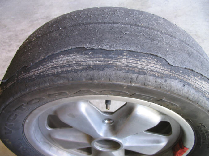

Ernie made me do it! ![]() ![]() ![]() ![]() Group: Benefactors Posts: 2,312 Joined: 6-February 03 From: Pleasanton, CA Member No.: 257 ![]() ![]() |
QUOTE(airsix @ Aug 1 2003, 12:54 PM) If I bought say, some Victoracers just for autocross, and assuming I only did a few events each season with them at what point would they be thow-aways? I assume they'd loose grip from age before wearing out. Unless you are super competetive, they are throwaways when they look like this. This is how mine looked after the autocross yesterday. They are about 4 years old. For the last 2 years I've treated them with Formula V tire treatment before each event to try and keep them sticky. They worked well until they corded. Attached image(s) ![]() |
ChrisReale |
#10
Sleazy ![]() ![]() ![]() ![]() Group: Members Posts: 2,665 Joined: 20-January 03 From: San Francisco Member No.: 176 ![]() |
Id say its time for a new set of shoes (IMG:style_emoticons/default/laugh.gif)
