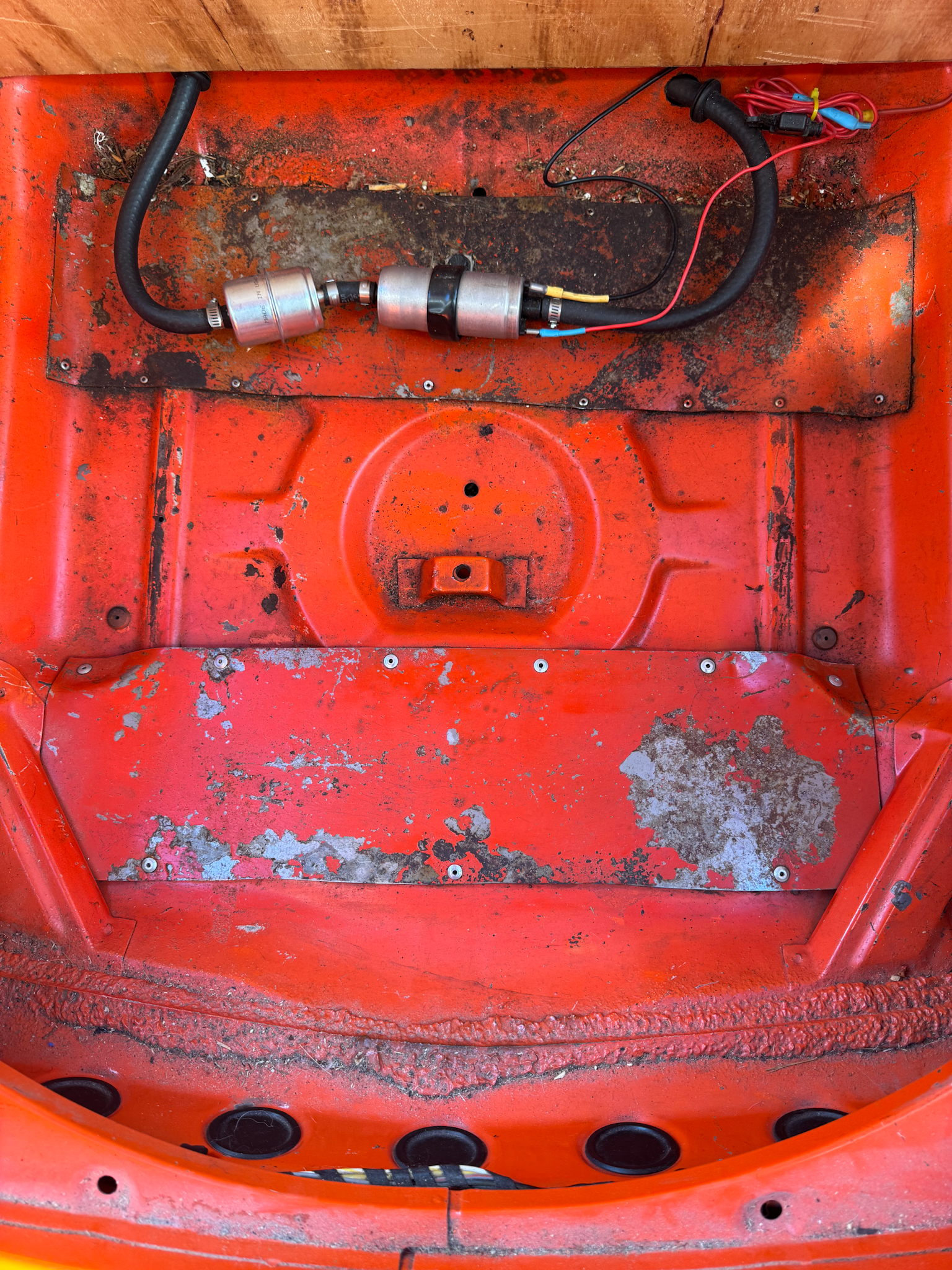

I want to fix the two holes that were repaired with rivets and a piece of metal in my frunks floor. I would like to find some one that would be willing to sell me just the two sections I need, rather than spend 300 on restoration designs repair piece.
Any one have the pieces I need… (IMG:style_emoticons/default/beerchug.gif) ?

Looks like you already have it covered (IMG:style_emoticons/default/slap.gif)

Don't know your welding skills but will comment that you really should find a whole used floor, stitching pieces just makes it harder due the ribs and contours of this panel,mine was cut for oil cooler and is a bit of a mess that is fixable ,cheers.
