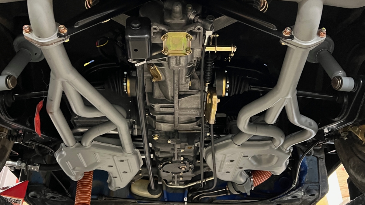

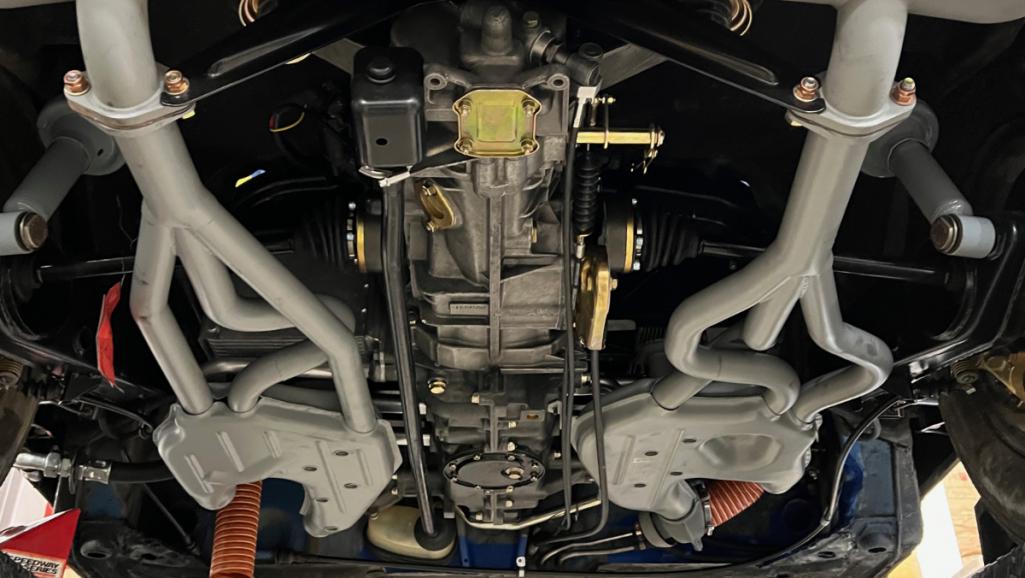

The engine and transaxle are installed. Thanks for the inputs from this thread and folks I spoke to offline.
We did it with 2 people and 3 floor jacks. Only lifting the rear. Stub axles attached. Engine tin installed, but loose.
I couldn't find videos of anyone doing it this way, so I made a brief one and posted to YouTube. I wouldn't recommend this approach if you have other options, but it can be done without damage or injury. (IMG:style_emoticons/default/smilie_pokal.gif)
