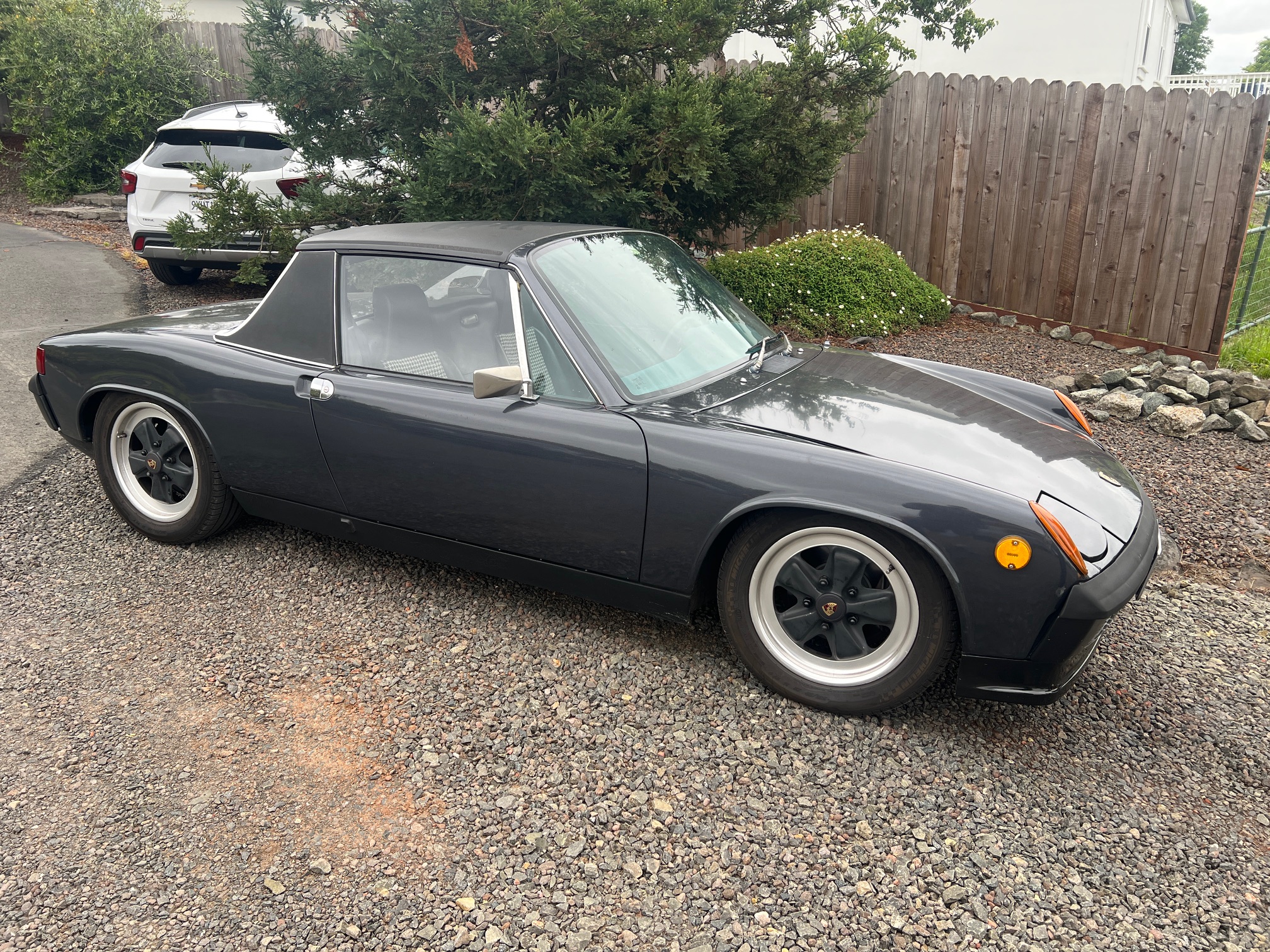

QUOTE(Ottomotion @ Apr 28 2026, 10:14 AM) *
Wondering whos car this is and if it might be my dads old project now completed?
Thanks for the compliments guys! I've had the car since 1990 and have done the majority of the work myself. It was a driver when I bought it. I used it as my daily driver for a few years before I took it all apart and built it. (IMG:style_emoticons/default/beerchug.gif)

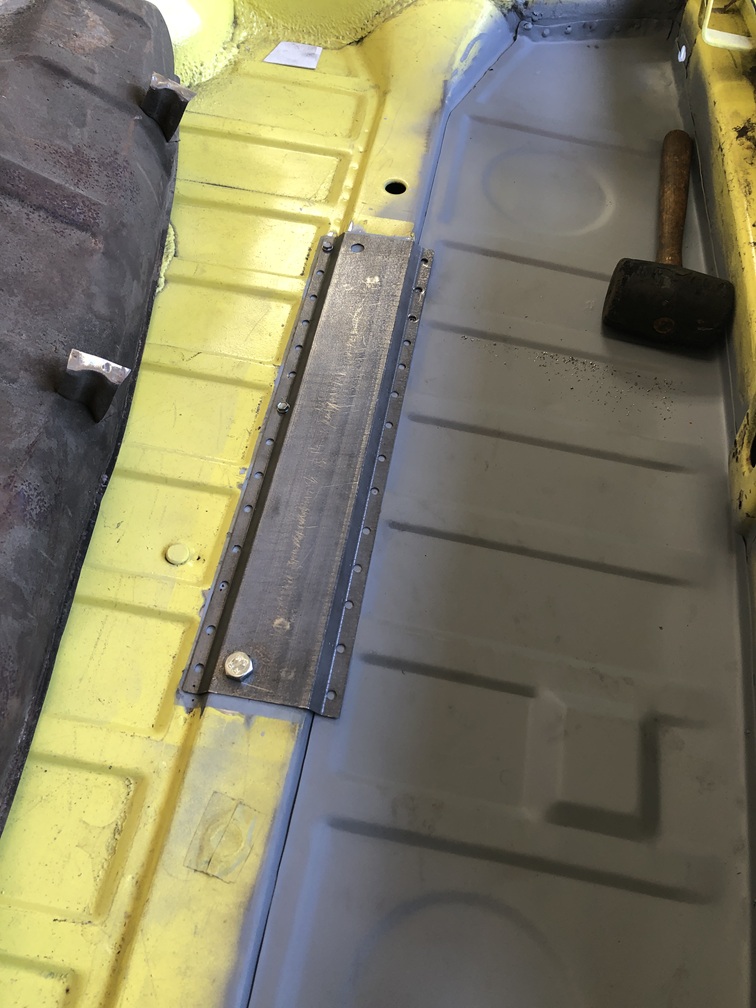

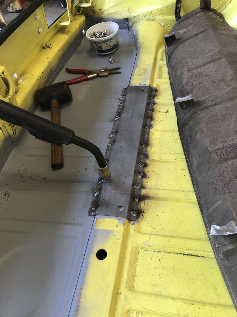

The fun continues with the trunk. The reinforcement panel arrived today and I wasted no time getting it installed:
First, use the old time hand punch and make the plug weld holes, then get it positioned. Nice that that bolt hole can be used to secure the left end. A couple self-tapping screws and it's ready for welding.

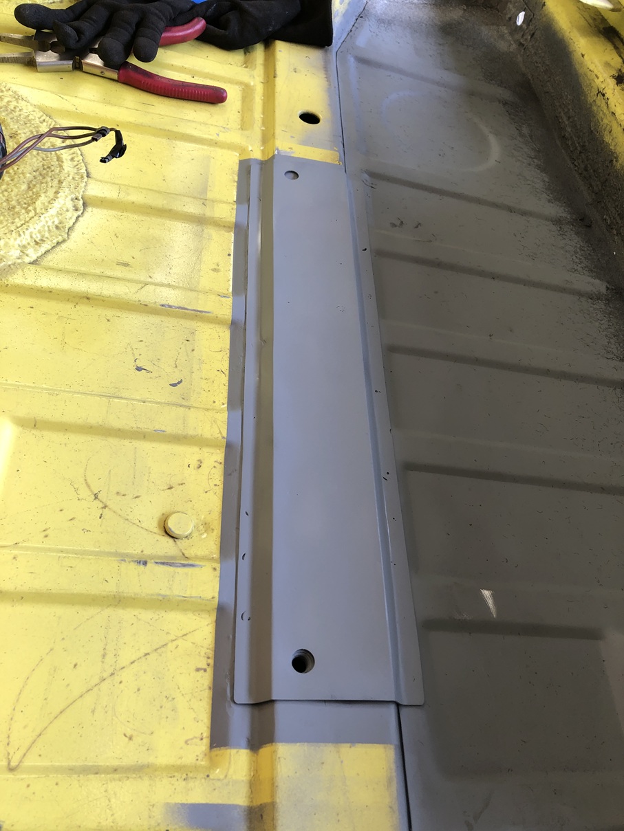

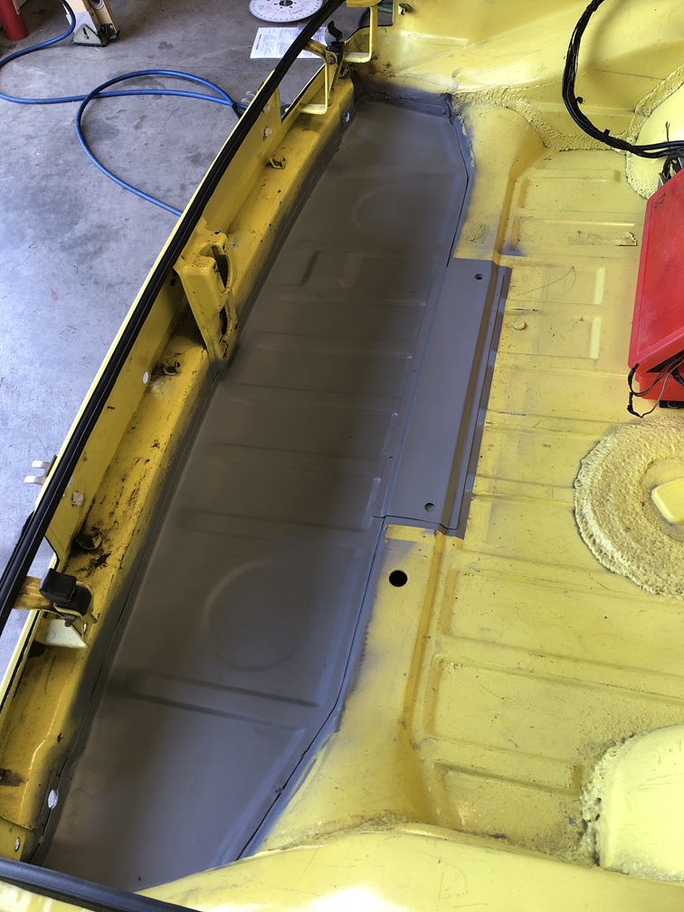

Then just plug weld, metal finish and prime.
Next, I'll break out the spray-able seam sealer gun and see how close I can come to matching the factory look.

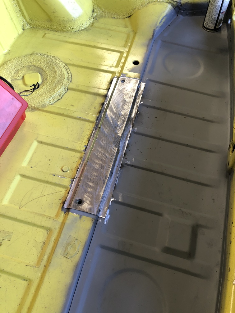

QUOTE(tygaboy @ Apr 29 2026, 05:53 PM) *
Hello Sir!
Curiosity has gotten the better of me; I am compelled to ask.
Your attention to detail is outstanding and your fabrication skills tremendous. Here with the cross base cover or reinforcement plate why did you only do the perimeter welds and nothing in the center?

QUOTE(seanpaulmc @ May 1 2026, 11:16 AM) *
Hello Sir!
Thanks,
@seanpaulmc Good catch. I'd originally missed that. My excuse is that I didn't remove the original panel so the locations of all the factory weld spots wasn't burned into my brain! I've already gone back and corrected things but didn't update with a new pic so here's one. If you look closely, you can see there are now plug welds on that surface.
