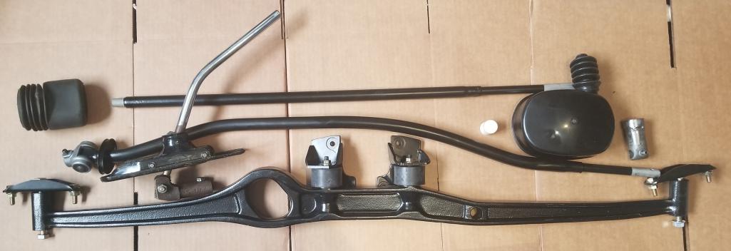

I am looking to get my tailshift gearbox converted to a sideshift. My car will have a 2.4
911 engine installed so i assume the engine bar and mounts in the attached picture borrowed from this forum are not required.? Is there anything else i need to alter/ modify ? Car is a 71. I am sure i read here somewhere that the bulkhead may require tweaking.?
Many thanks for any help offered.
Dave

To convert your 901 from TS to SS you'll need the internal shift rods, shift console & tail cover from a side shift as well as a gasket kit & the firewall conversion bushing. For a /6 the R. shift rod is different (than the /4 rod pictured) in that its nearly straight.
Contact me Im pretty sure I have most all the additional pieces you need.
https://914werke.com/shop/ols/products/side-shift-conversion-pkg
