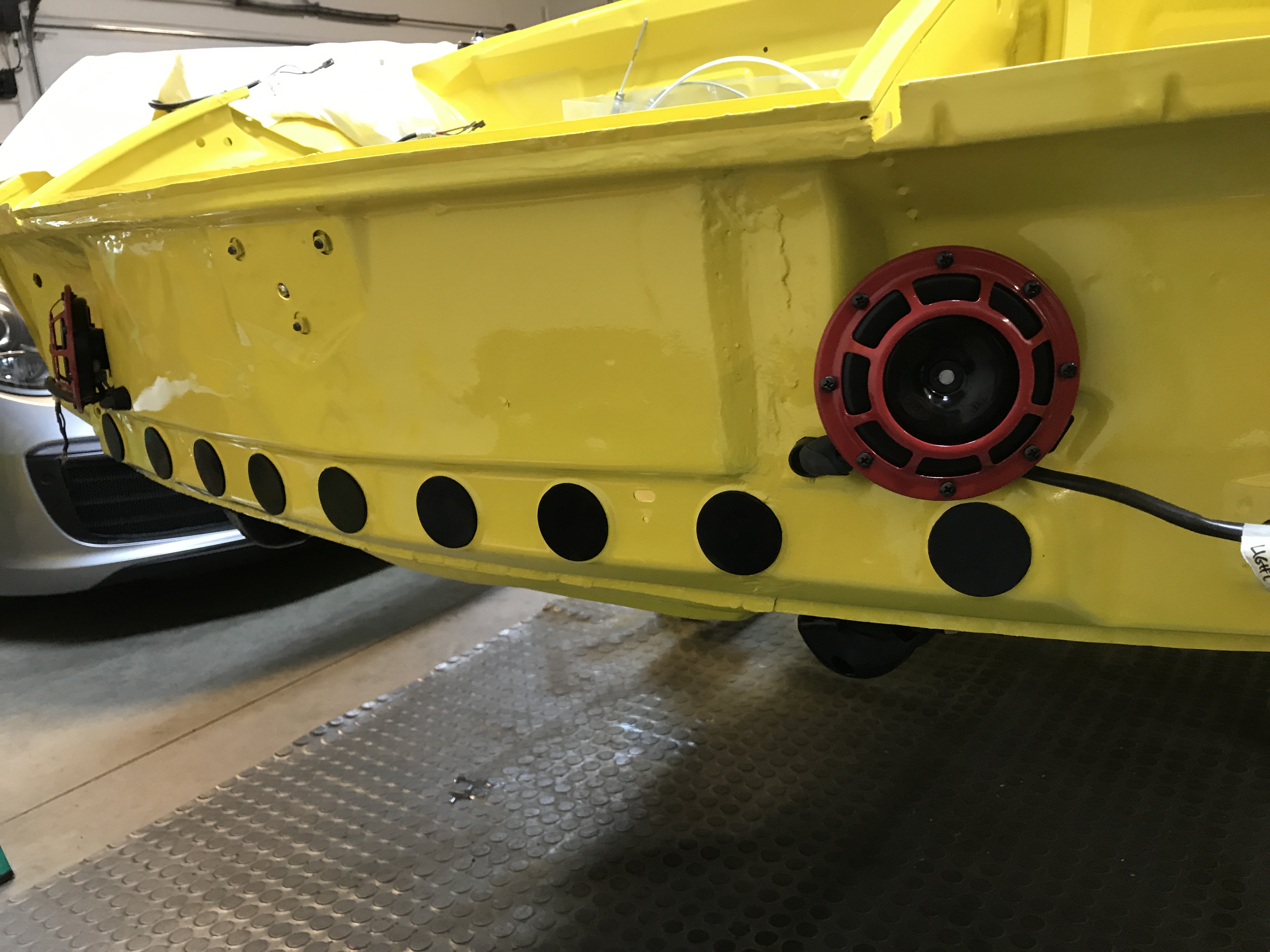

Thought about the Hella Supertone red horns, found an older thread where folks seem to like them and they bolt right up.
http://www.914world.com/bbs2/index.php?showtopic=309534
Any other bolt-in options people like? I have a single horn, but could install a dual system.

I went with Hellas. The sounds a little bit Euro beep-beep but get the job done.
