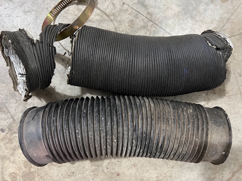

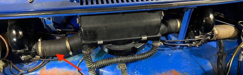

Blower to control box 914-571-123-10 (#15 in drawing). As of April 2026 NLA.
The OD of the tubes you connect to are ~60.25mm (2 3/8"). Hose length is 190-200mm (7 7/8"). A bit hard to measure accurately given the accordion nature of it.
The original hose from our 1970 914-6 is black paper outer with shiny foil inside. By comparison, a hose I took off a 1974 914-4 is all plastic.
Note: Porsche lists a different part number for:
Control box out 914-572-123-10 (#19).
Not to be confused with Engine Compartment Blower Hose.

early paper/foil... later plastic.. hard to find not cracked.. you can get the tan paper/foil hose which is correct for a 1970..
