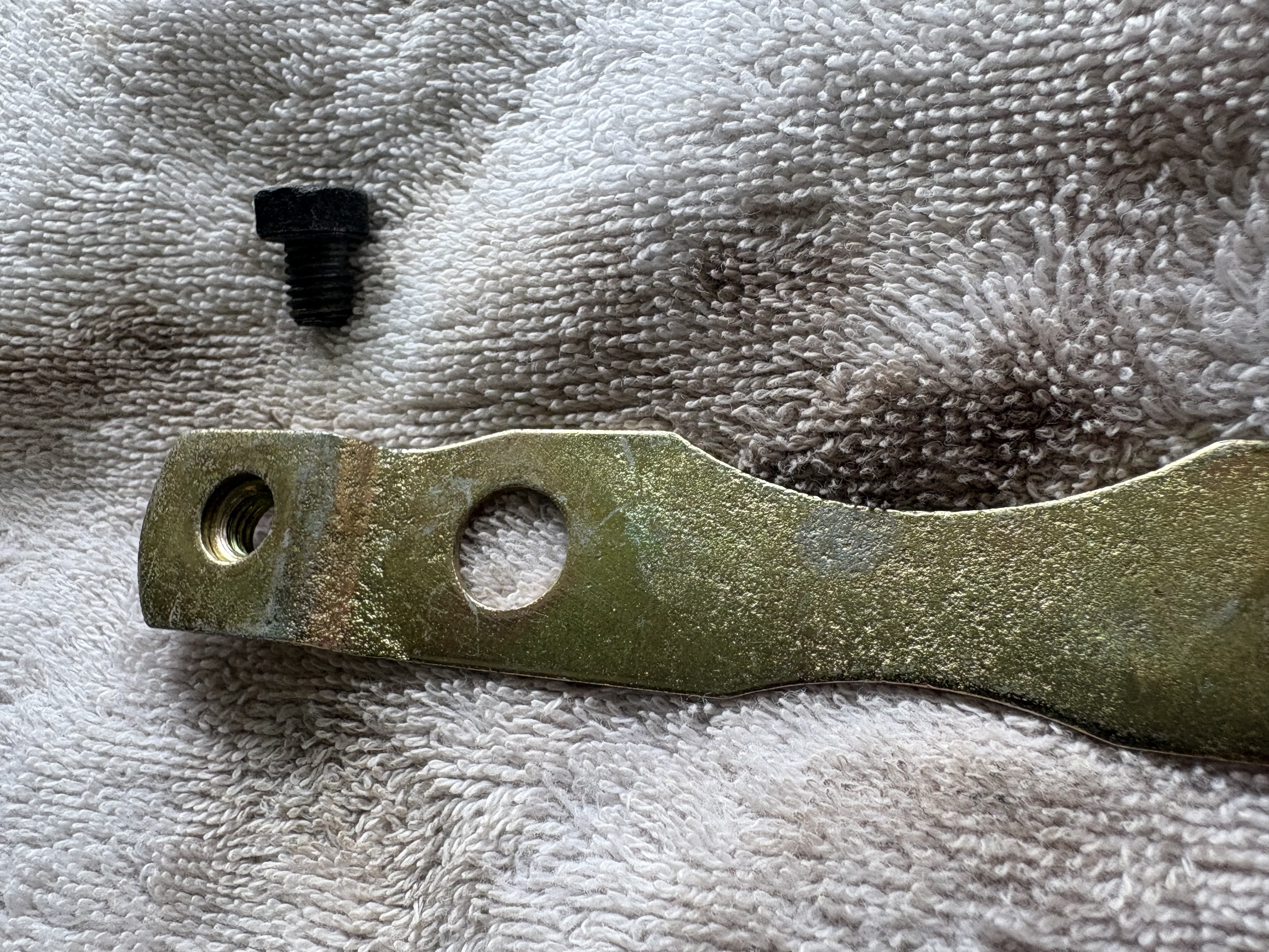

Looking for source for bolts for rear brake dust shields …M-8 but really short.
The ones at my local Ace just a bit too long.
Thanks

I think those are M8 x 10 or 12. If you don't want to buy Porsche, hit Belmetric. They have both. Shipping will probably cost more than the bolts.

Correct appear to be 10mm ….Thanks

hacksaw and/or grindstone make long bolts shorter...

Yes. Just thread a nut on first so the threads get chased when you unscrew the nut.
