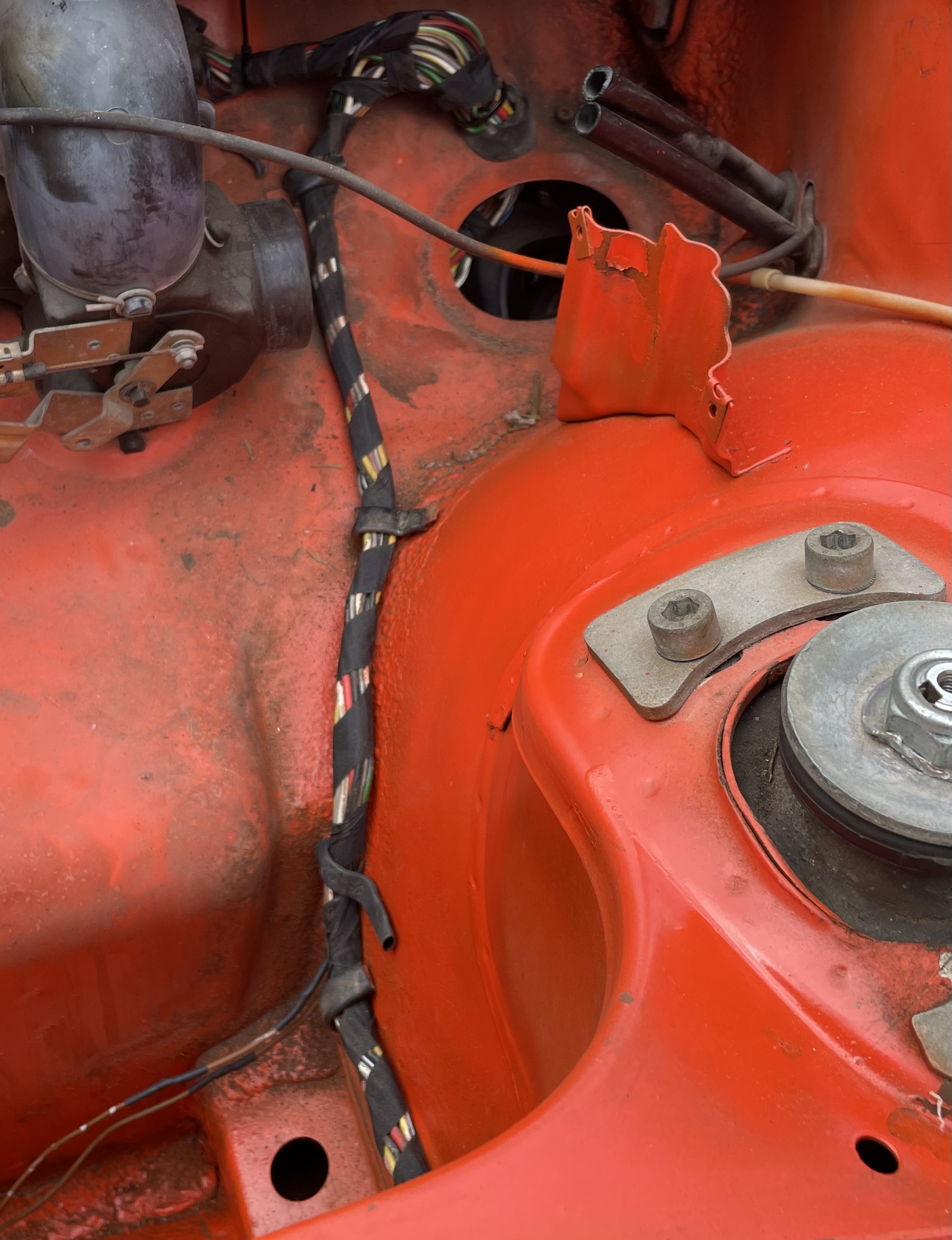

Got that repaired, and re-taped the whole area.

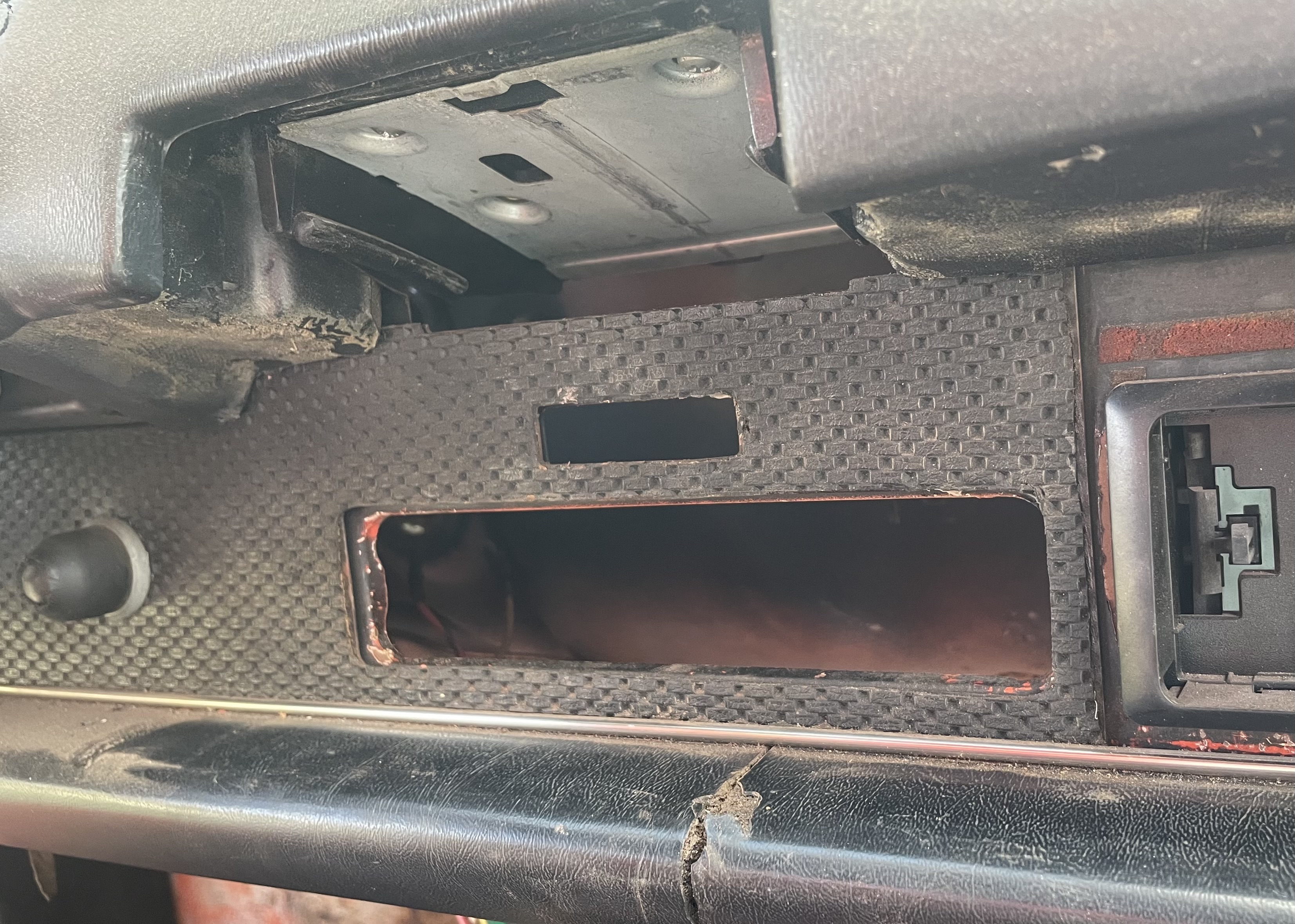

Next on the agenda - As I had mentioned the heat/defrost unit was completely missing, the cables had been cut. Also, note the missing “fasten seat belt” fixture and wiring in this picture.

QUOTE(bkrantz @ Apr 21 2026, 08:15 PM) *
Great work! I am curious how the suspension ear rotted from the inside when the hell-hole was solid.
And you might already know, but that Porsche horn button is worth restoring. Buttons for aftermarket wheels are pricey.
Not sure how the moisture gets in there generally.. but Porsche added a small "drain" at the bottom of both ears from the factory, long before any hell hole issues existed. Besides, the hell hole is down stream of the ear. There is actually a factory hole about the size of a quarter at the very top of each long rail on these cars (near the torsion rod mounts for the trunk hinges), so maybe there? Never the less - the "drain" on this particular ear was pinched closed and was holding dirt/mud. Also the three small little plastic caps that seal the mounting bolts for the outboard trailing arm mount were missing here too. I suspect that was a contributor. Those bolts were definitely rusty and difficult.
Lesson - check and open those drains with a flat screw driver, and make sure your plastic seal caps are in place.

Great. Except after I went through removing the cut cables and reattaching the good ones from my good slider unit - the center slider would not move (IMG:style_emoticons/default/headbang.gif) . So I ended up breaking an arm on the driver’s side defrost unit, trying to free it.
Broken part and replacement

I managed to get the defrost unit replaced, cables re-run and sliders working
