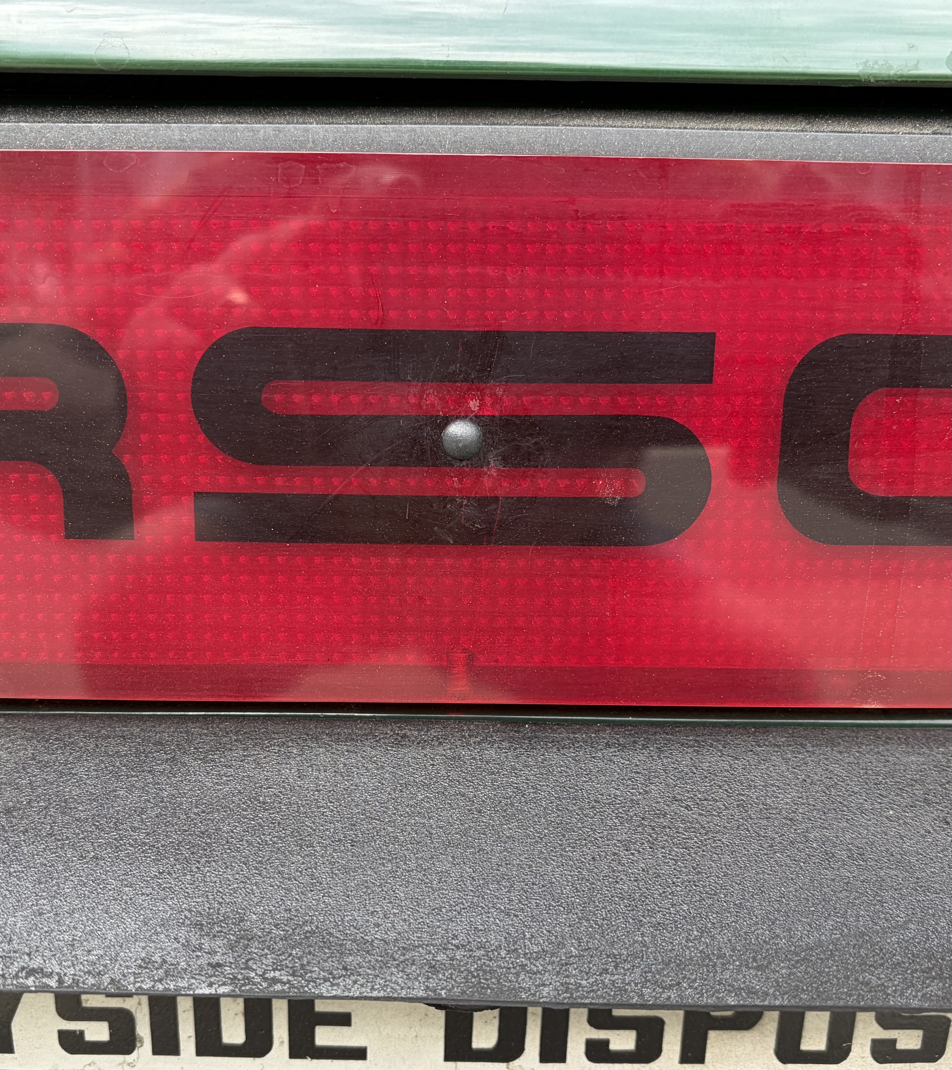

My 75 1.8 has a really nice but cut-down / modified 911 rear center reflector. I was fiddling with the taillights last weekend and may have disturbed the solenoid wiring for the rear trunk release. Now the button won't pop the rear trunk open.
Many years ago I had a similar set up and drilled a tiny hole in the reflector in order to insert a thin allen wrench to open the rear trunk in emergencies. Since the reflector is already cut and only useful to 914 owners, would drilling a small hole in my reflector decrease it's value? I'm contemplating removing the reflector and going back to the stock set up.
Thoughts?

It would likely decrease the value of it unless it's in less than good condition already.
I have a cut down reflector on mine (previous owner mod) and had the soleniod fail shortly after buying the car. I went the route of drilling a hole in the trunk floor just large enough to run a bike brake cable through to open the trunk from below. Not a perfect solution either, but works until I can remove the refelctor and patch the holes in the back panel.

I think the more pertinent question is: would being unable to open the trunk decrease the value of my car?
My previous car had a reflector and the diameter of the hole drilled in it was ~1.5mm. I used a small stainless steel rod to open the trunk. It was an Kirschner wire, used in surgery to pin small bones, so not sure how easy it is to get one. Any steel rod should do fine. The hole is so small it was basically unnoticeable. Whatever you do, you need to have some back-up method of opening the trunk. I'd rather drill a tiny hole in the reflector than drill a hole in my car.

I decided to drill thru the (non-911) reflector rather than thru the floor of the trunk. I use a small Allen wrench to push on the latch. I found a small black plastic plug at the local hardware store to cover the hole.
All that said, I hope to remove the reflector, fix the holes, and get back to the original look someday.
