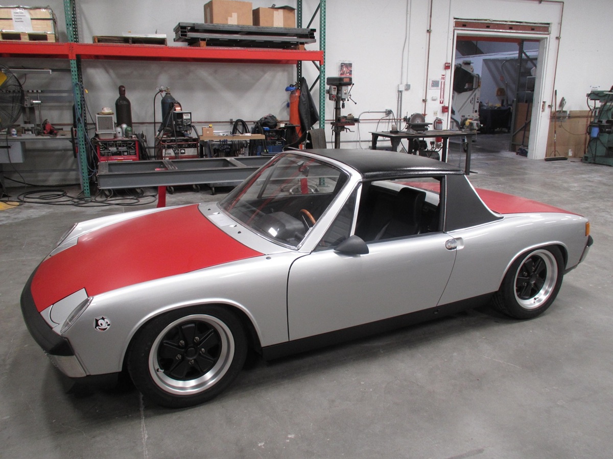

Narrow body 2.7 with 230ish hp. A052 195's on 6" wheels.
21mm hollow torsion bars in the front
Bilstein raised spindle RSR struts
Bilstien HD shocks
Tarett 22mm front bar and links
150 lb springs rear
Bilstein sport shocks
Factory rear sway bar
Patrick Motorsports adjustable tow link set for the rear
What would you expect in terms of handling with this setup? No autocross- just hard driving on mountain roads.
