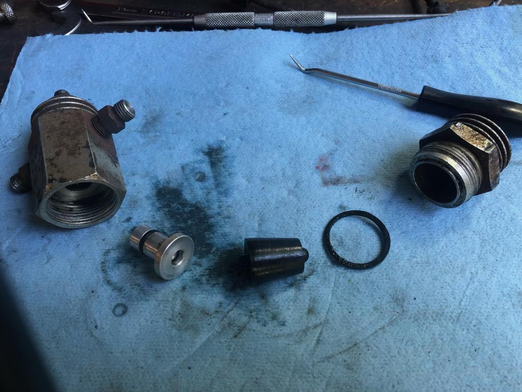

> ID this brake part?

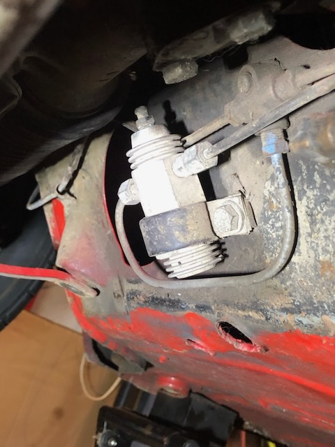

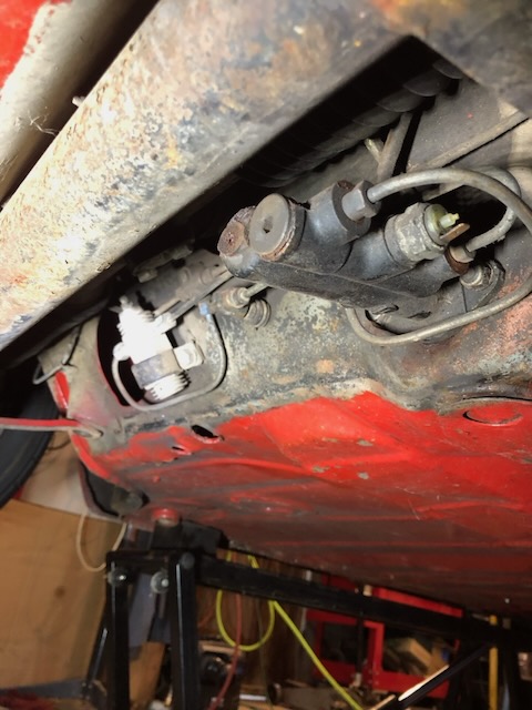

Can anyone ID this brake part? It's inline to the front brakes only. I've never seen such a thing. My pal Eric at PMB thinks it's a residual pressure regulator meant to keep some brake pressure on tap for a firmer pedal... News to me...

stownsen914   That thing looks like a Safety Braker. In the 70s,...   Apr 27 2026, 07:06 AM
Charles Freeborn   That thing looks like a Safety Braker. In the 70s...   May 2 2026, 10:32 AM
sixnotfour   Safety Braker... theres a couple of post somewhere...   May 3 2026, 03:06 PM

sixnotfour   similar dif. manufacture .. one on each rear.. big...   May 6 2026, 08:40 AM
Charles Freeborn   There's my answer... So... anyone had one apar...   May 6 2026, 08:47 PM
sixnotfour   Garretson Enterprises 1977   May 18 2026, 12:56 PM

GregAmy   It's basically an air-assisted pressure damper...   May 20 2026, 06:39 AM

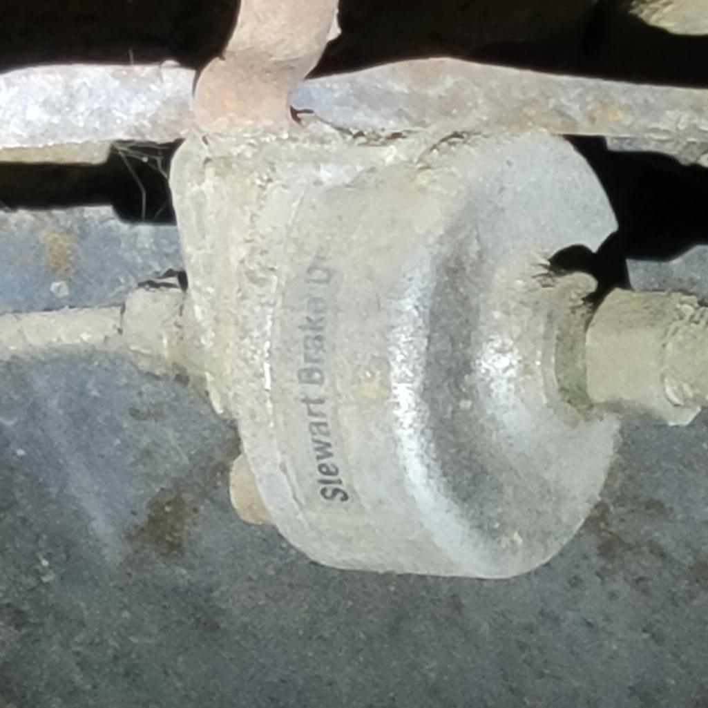

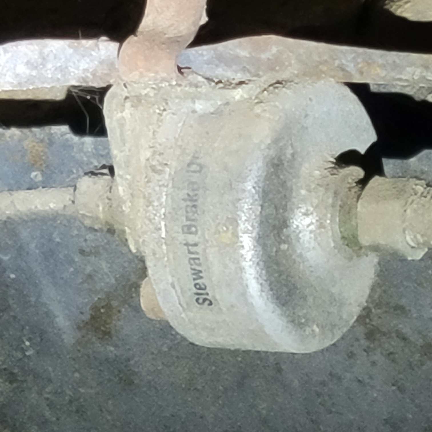

Charles Freeborn   Here's the 411 on the "SafetyBraker...   May 22 2026, 03:58 PM
Ninja   Thanks for the autopsy and the comments... This t...   May 22 2026, 04:37 PM
GregAmy   Fantastic! I've never seen the inside of t...   May 23 2026, 06:05 AM
