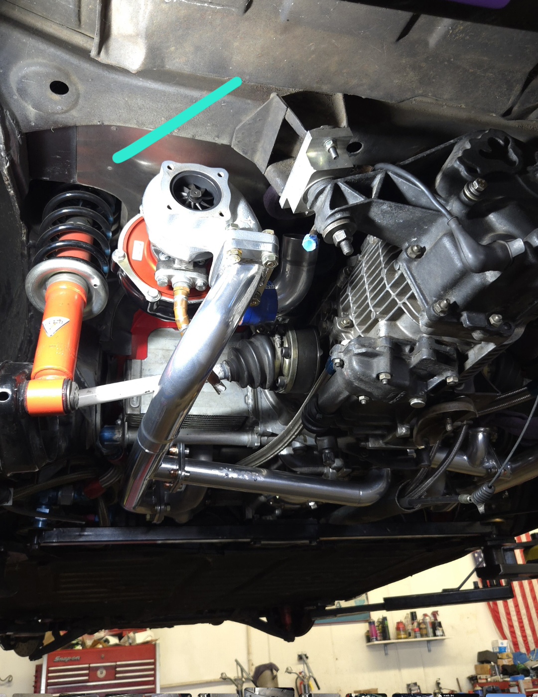

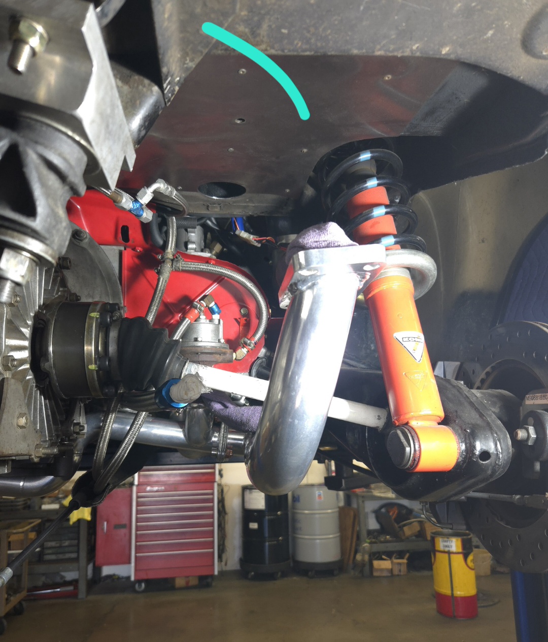

I just source a remnant sheet of SS .22 gauge sheet metal from the metal yard, make a few paper patterns, & cut. Rivets or Riv-nuts to hold in place>> shiny side faces the heat source. This pic shows the custom shields just under the trunk. You can easily cut/shape/ form and fasten to the muffler heat shield in place; or just purchase the 'Rix.
