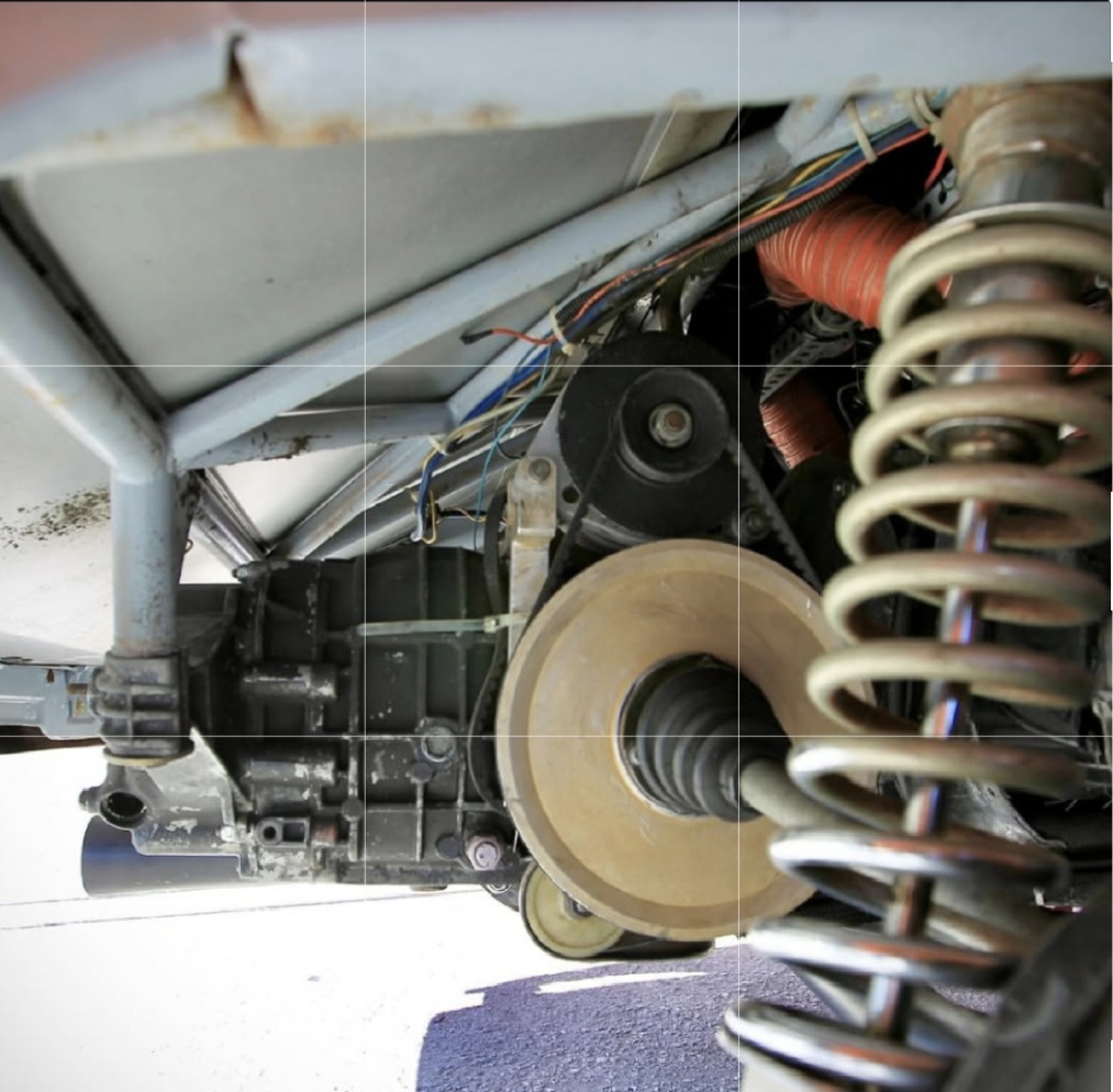

The alternator drives off of the Right rear axle.

Alternator runs via pulley drive off of R/ rear axle; -0- parasitic drag on crankshaft hp loss.

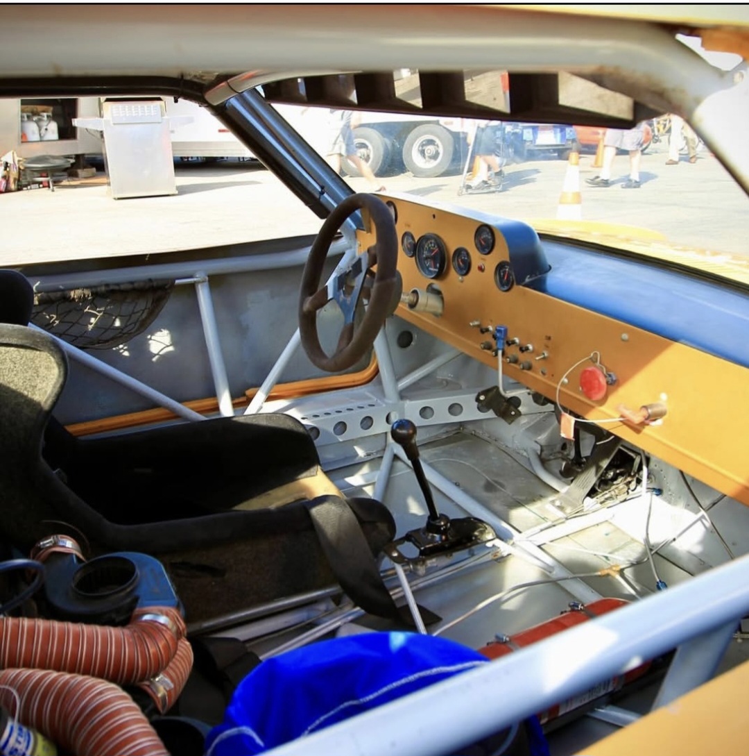

Interior of the 'Business office, 2) flexible air duct hoses carry forced air from 2) 12v fan motors>> going to Left and Right side of the engine cooling tin. The normal T 4 squirrel cage cooling fan/ housing is absent, for even less crankshaft hp draw, less weight.

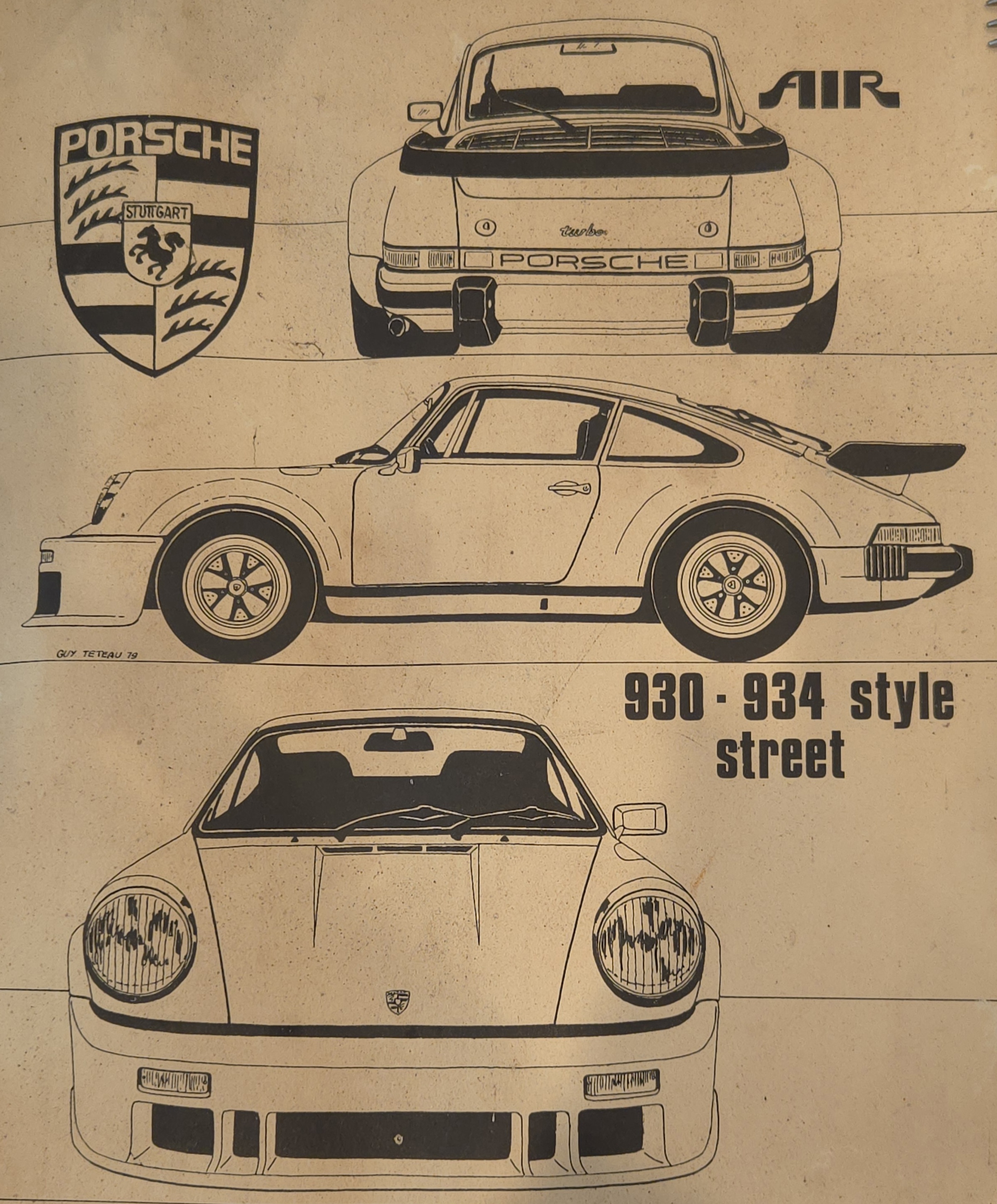

An old page out of Dan McLaughlin's A*I*R brochures. He was the biz partner of American Int'l Racing with James Garner ("Grand Prix"), and constructed track/ street body panels mostly Porsche.
Dan also built the IMSA body for the black Altec Lansing 914, and the John Bond 930 powered 914.
I still have lots of A*I*R products on several cars, all hand laid glass, Dan did not use 'Chopper fiberglass guns.
The School Bus could have used period fiberglass from a couple other mfgs, or a mix of sorts as there were also; Mitcom, Hoseman, Fiberglass Trends mfg. in those days.

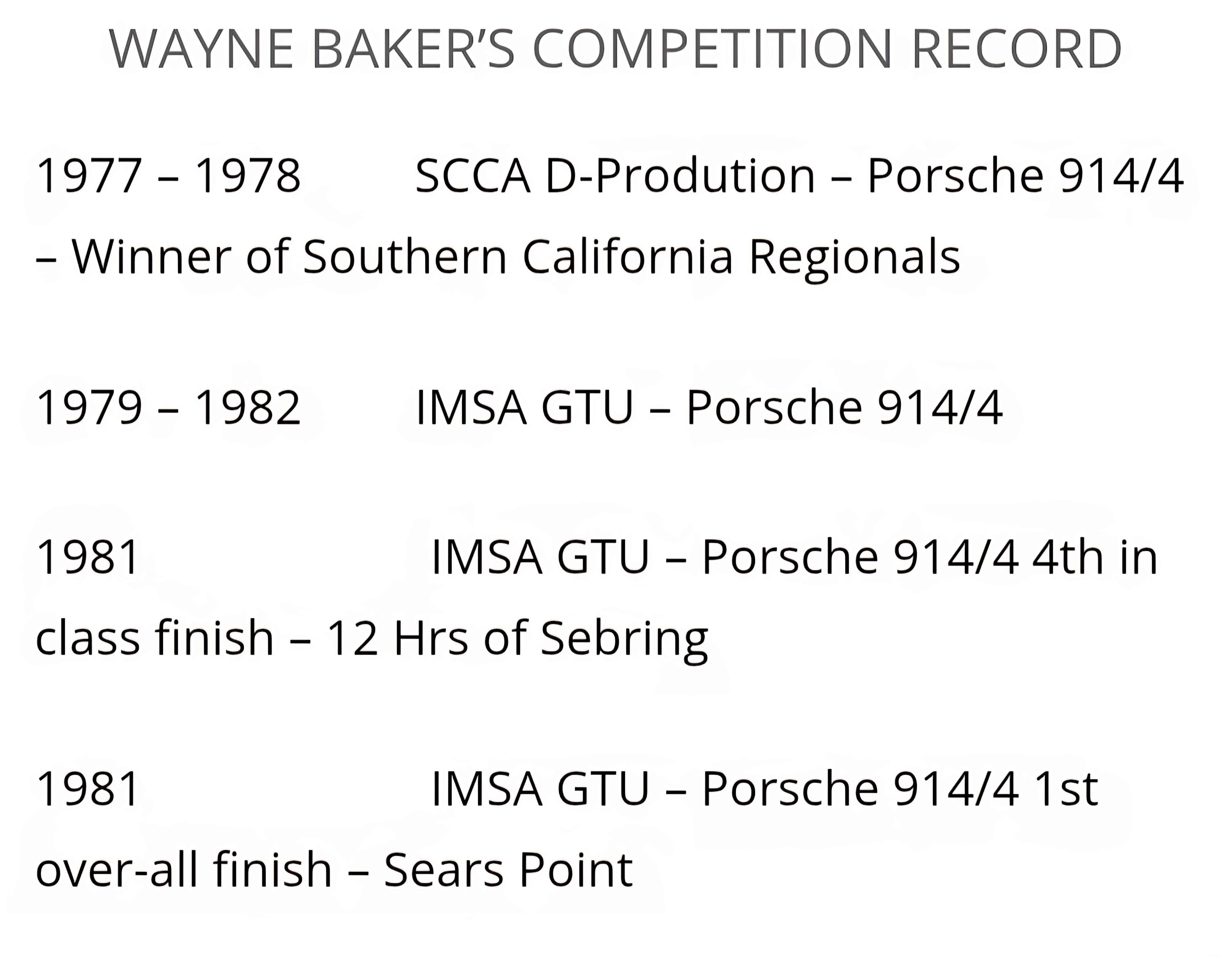

A substantial vehicle weight reduction (IMSA gcr's in period) with the T4 engine Vs a 6 cylinder. Wayne was up against mostly 911 n/a's.
His #22 race standings are still archived and accessible somewhere online.
Being of mid engine and light ( U know all about that ¡) , he was a good pilot and the car just needed to stay together (IMG:style_emoticons/default/driving.gif)

Mr. Baker's most notable T4 moments...
