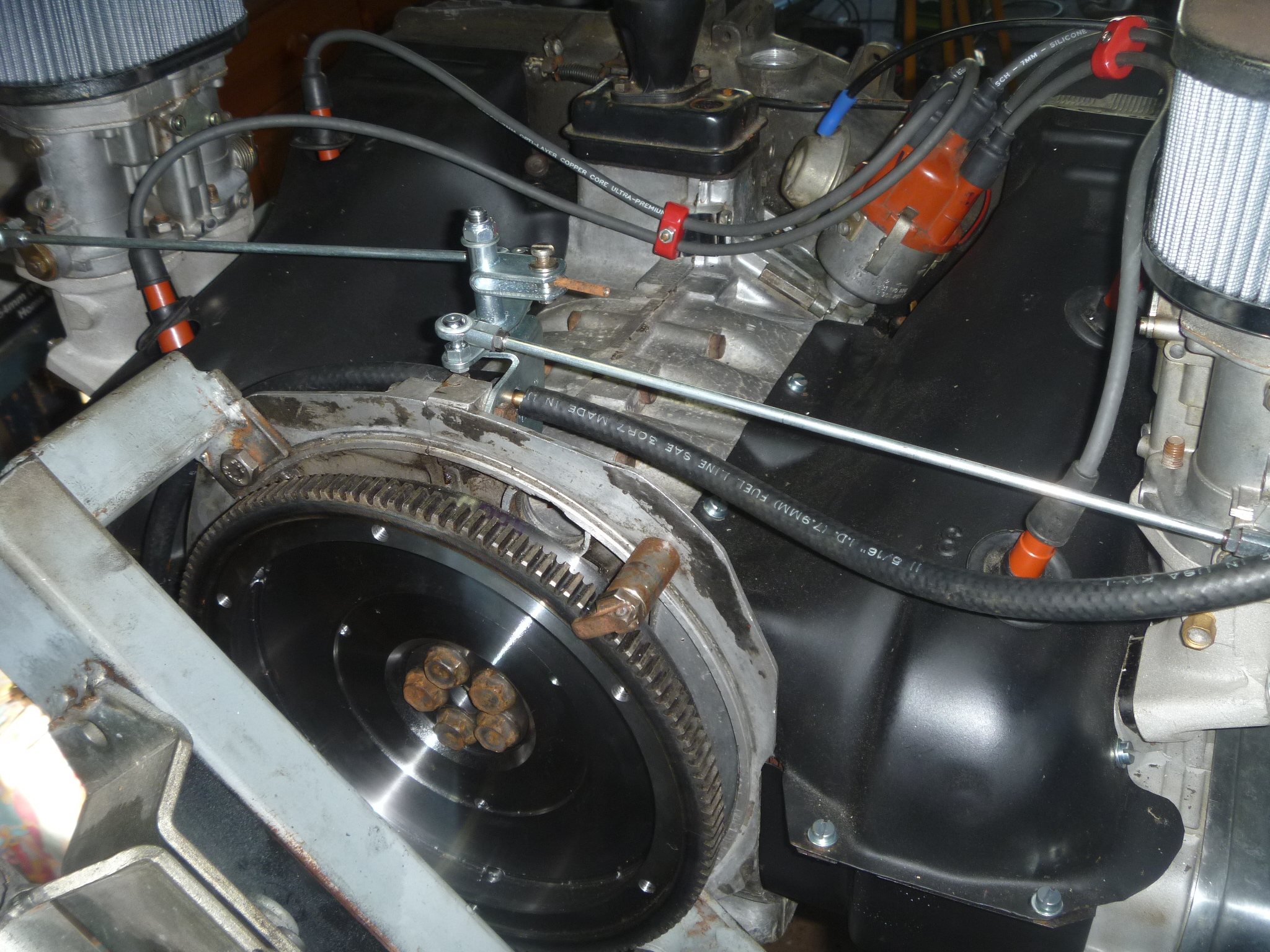

I have several hex bar setups on the shelf, should be in the scrap pile as I could never get them dialed in. I fabricated a simple bell crank deal with basically some crap laying around, some all thread and some new ends from Pegasus. Works great for 3 years running now. I wasn't crazy with the push/pull setup

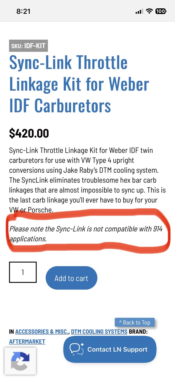

Looks like the sync link from LN doesn’t work for the 914…
I’m just getting my car on the road for the first time. Looks like with all the complaints about the hex bar, I will be ordering the Tangerine system before too long. Everything I’ve purchased from Chris so far has been above and beyond quality.

factory engineered system on the six ,however only as good as the sum of the parts ,mine was worn and required replacement of several of the rose/ball joints cause I couldn't get them right otherwise ,night and day after repairs, haven't touched it since.
Bellcrank system is the best for those on a budget, the geometry is streets ahead IMO ,the owner of my last build took a budget solution so I imported a chinese knock-off and found it pretty well made but replaced the poor fitting rose/ball joints with CB Performance ones.
Easy set up and worked well ,cheers.
