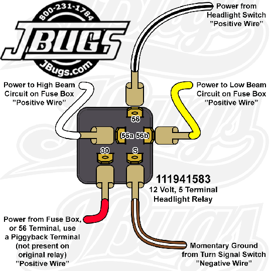

Has anyone replaced their hi/low beam relay with the "LR35" relay? I've tried 3 relays (used units, that I have on hand) and can not get my fogs to illuminate. There is very low voltage coming through the hi beam side, which I guess is the issue.
The LR35 has an extra terminal (#30), I've read of this relay being used on a bug (theSamba) but was unclear on what happens with the #30 terminal. Anyone used this?

I found this wiring diagram from J-Bugs on how to make this relay work.
(IMG:http://www.914world.com/bbs2/uploads_offsite/www.jbugs.com-15080-1778553878.1.gif)
