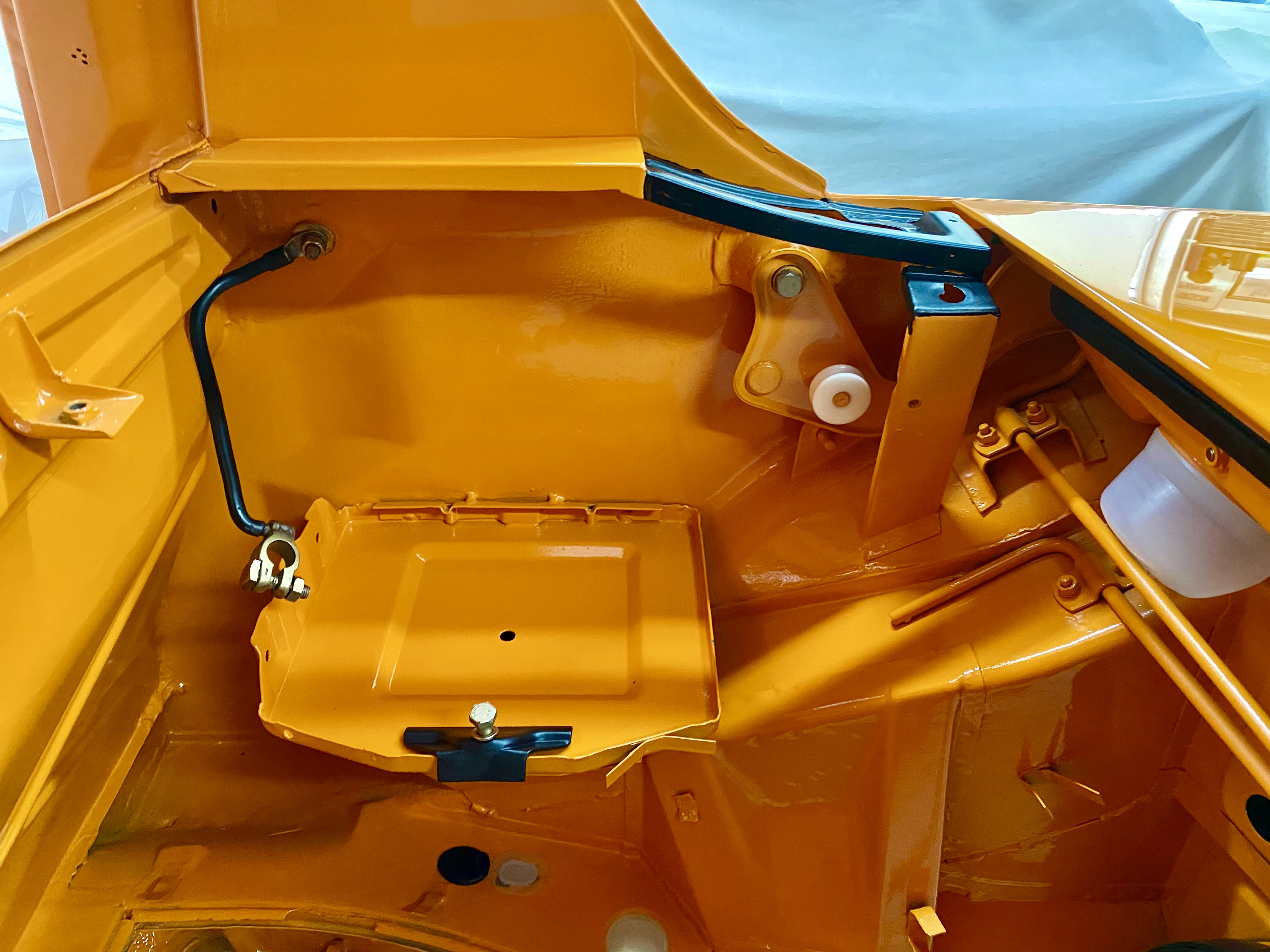

Could someone please make photos of an original connection at the battery for the positive cable? As the battery clamp portion is so often replaced with one from a local auto parts store, I am interested to see how the original was done, especially how the auxiliary wires are attached.
Many thanks
thomasotten   Battery cable   May 21 2026, 10:01 AM
JeffBowlsby   Here is a good photo of the factory clamp:   May 21 2026, 11:28 AM
Artfrombama   HERE!   May 21 2026, 11:57 AM
thomasotten   Great thanks. Does anyone make a replica cable, w...   May 22 2026, 12:21 PM
DennisV   Great thanks. Does anyone make a replica cable, ...   Jun 4 2026, 10:05 AM
Ron914   Hers's mine . The cable is black but I wrapped...   Jun 3 2026, 08:01 AM
IronHillRestorations   The 914-6 battery cable was integrated in the 6 en...   Jun 4 2026, 08:47 PM
TonyA   So I see the correct stuff for the positive side, ...   Jul 3 2026, 08:32 AM
JeffBowlsby   So I see the correct stuff for the positive side,...   Jul 6 2026, 03:13 PM
DennisV   So I see the correct stuff for the positive side...   Jul 7 2026, 06:26 AM
wonkipop   [quote name='TonyA' post='3263880' date='Jul 3 2...   Jul 7 2026, 03:32 PM
TonyA   So I see the correct stuff for the positive side...   Jul 7 2026, 02:05 PM
fixer34   original as far as I know. May not be pretty, but...   Jul 3 2026, 11:06 AM
wonkipop   got a little more curious, dug around on Jeff...   Jul 7 2026, 06:10 PM
JeffBowlsby   Thanks for the vote of confidence Michael, but I a...   Jul 7 2026, 06:18 PM
wonkipop   yeah jeff, thats a very good point re pre-producti...   Jul 7 2026, 06:57 PM
wonkipop   couple more examples of VW/Porsche use of flat str...   Jul 9 2026, 08:30 PM
fixer34   I'm wondering if the braided ground (earth to ...   Jul 10 2026, 07:09 PM
wonkipop   I'm wondering if the braided ground (earth to...   Jul 10 2026, 11:52 PM
TonyA   My battery set up with correct slotted hex head sc...   Jul 30 2026, 09:01 AM
aturboman   Like many things Porsche did back in the day, what...   Aug 3 2026, 04:15 PM
914Next   Finally back in Wisconsin and had a chance to pull...   Sep 1 2026, 08:32 AM
914Next   And a few gratuitous pics   Sep 1 2026, 08:48 AM
