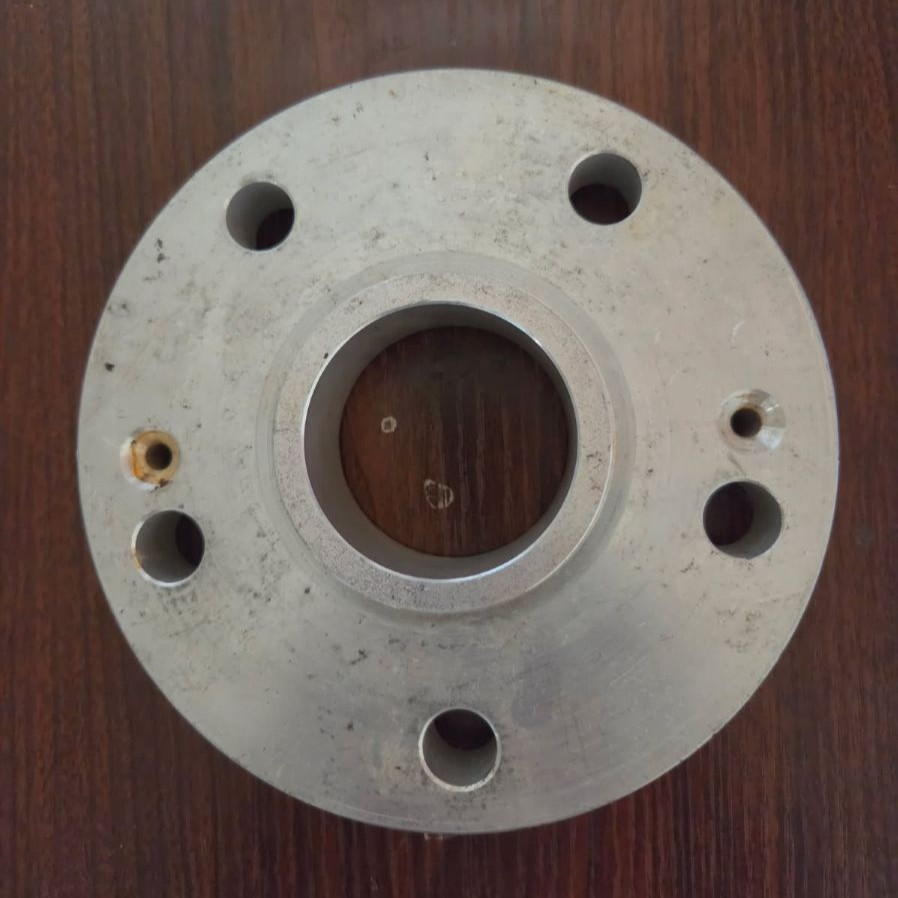

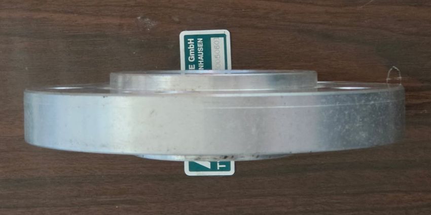

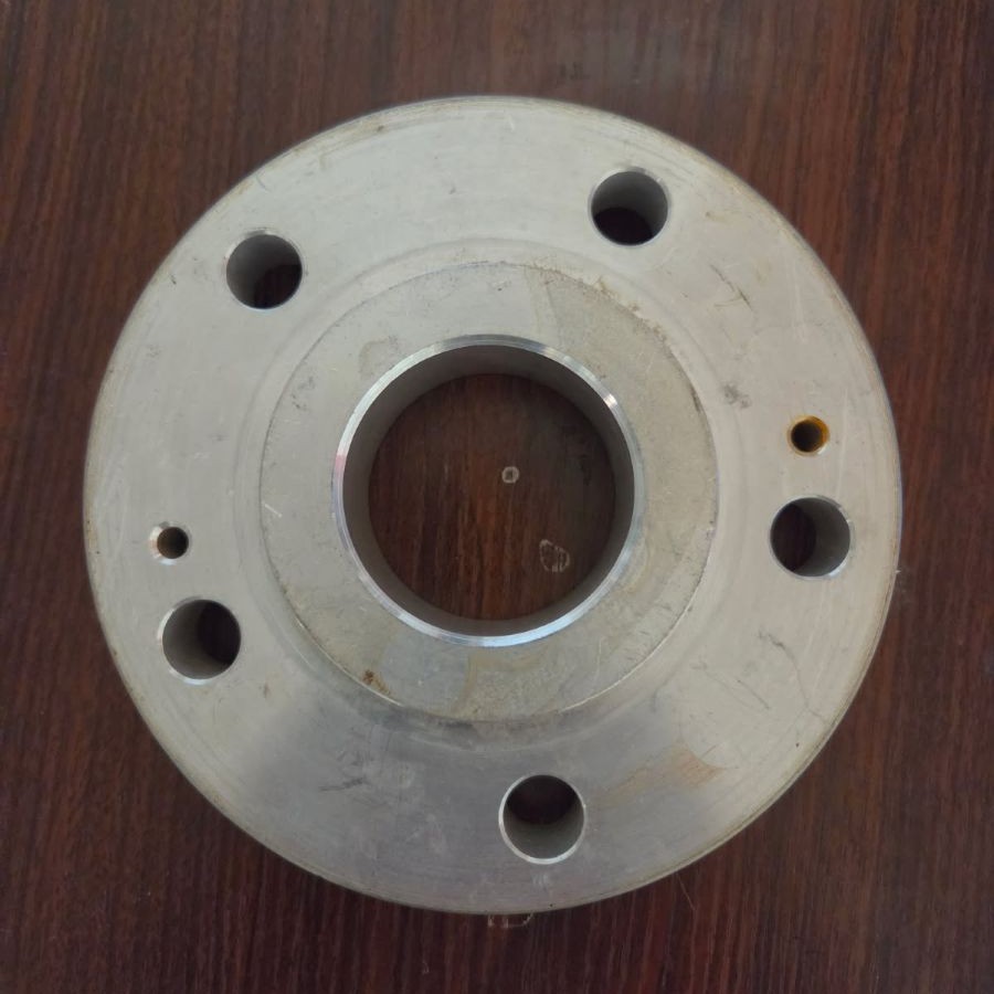

A bit of Lathe work,, Upgraded Rears..
5-lug spec dia. 71.6mm
rotor side.
